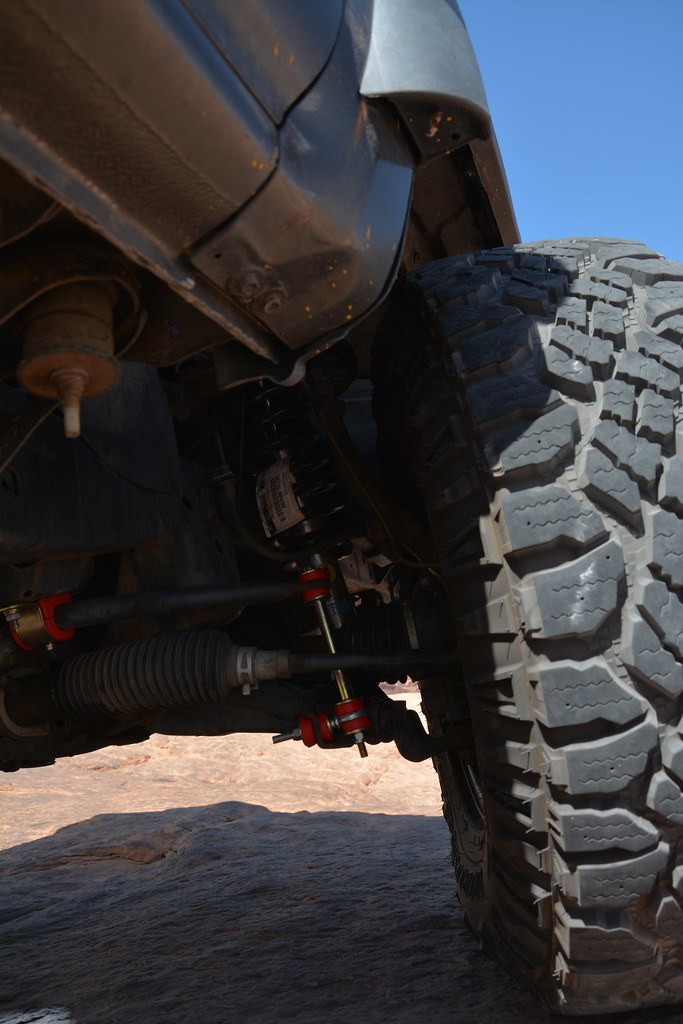

Not trying to take away sales of MStudt's nice end links, but I did a pretty easy solution that has worked great for the last 20,000 miles.
I bought these end links (you choose the length you need) at my local auto zone:
Energy Suspension 9-8119R Energy Suspension Sway Bar End Links - Free Shipping on All Orders @ JEGS
I bought bushings like these (purchase the correct ID for the eyelet shaft):
Energy Suspension 9-8103R Energy Suspension Sway Bar End Links - Free Shipping on All Orders @ JEGS
And finally I bought a forged eye bolt from home depot/lowes. Pick one that has a 2-3" long shaft, and cut down if you need to. Also I picked mine based on the side of the sway bar's bolt hole opening, not the size of the energy suspension's links. You want the eye of the eye bolt to be about the diameter of the bushings, not bigger, but it doesn't have to be as small sat the end links bolt.
The Hillman Group, 1/2-13 in. Forged Steel Machinery Eye Bolt in Shoulder Pattern (1-Pack), 320608.0 at The Home Depot - Mobile
Here is a picture of how the 3 parts are all put together, pretty self explanatory if you ask me, and the best part is that any local auto zone/advanced/oreily's/pep boys is going to have these if I break one.
DSC_6615 by ericandshovin, on Flickr

Those links work pretty good, and even better if you lose some of the bushings. You only need bushings on the top (frame mount side) and between the eyes. Adding extra bushing on the sway aren't doing any good. The bushings are acting as a pivot point and not allowing the sway bar to function as it should. You can mount that eye bolt directly to the sway bar and be better off.
Thanks for the tip mate, I'll have to remove the extra bushings next time I'm poking around the rig.
