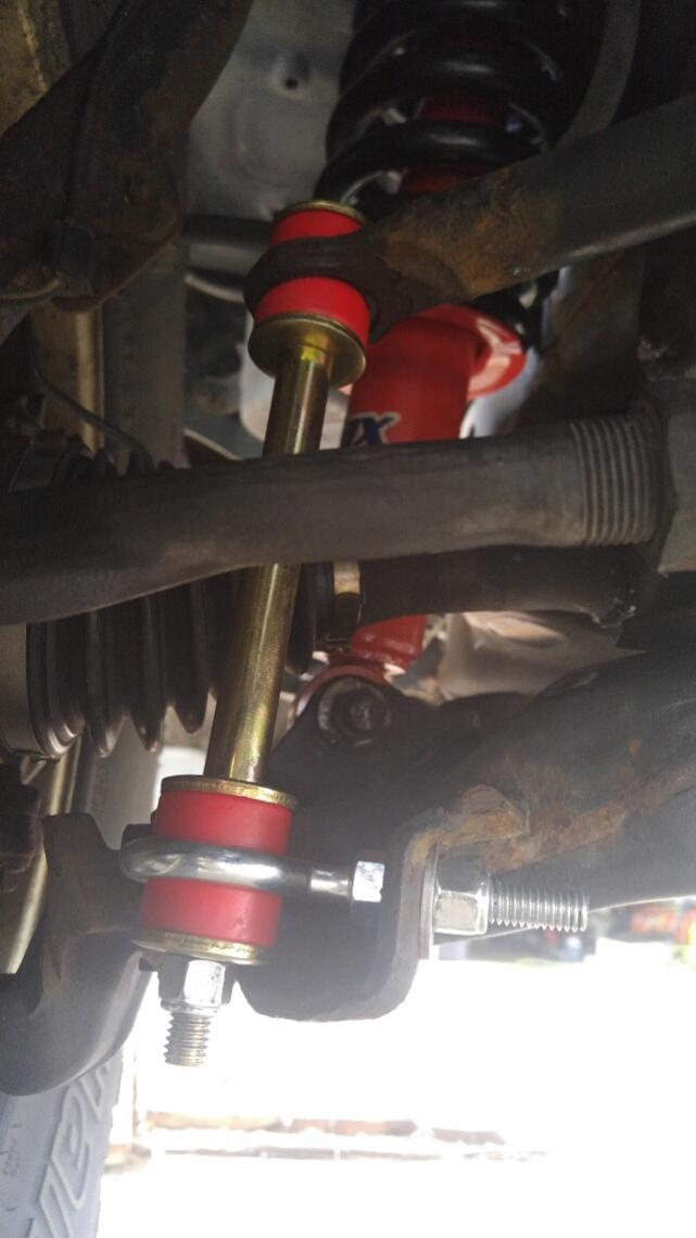

I just bought these from AutoZone. Two pack was around $25, plus another $3 for the eyebolts. I may have to buy smaller eyes holes, but it's all the local hardware had.
I think it's the 4 1/2. The washer and bushing adds about an inch to each side. I tightened mine down pretty well.
I went with the 4 1/4" for the rear links. I was wondering if the 4 1/2" ones would be fine for the fronts at just a quarter inch longer. The stock delta is one inch, as Mike stated earlier.
