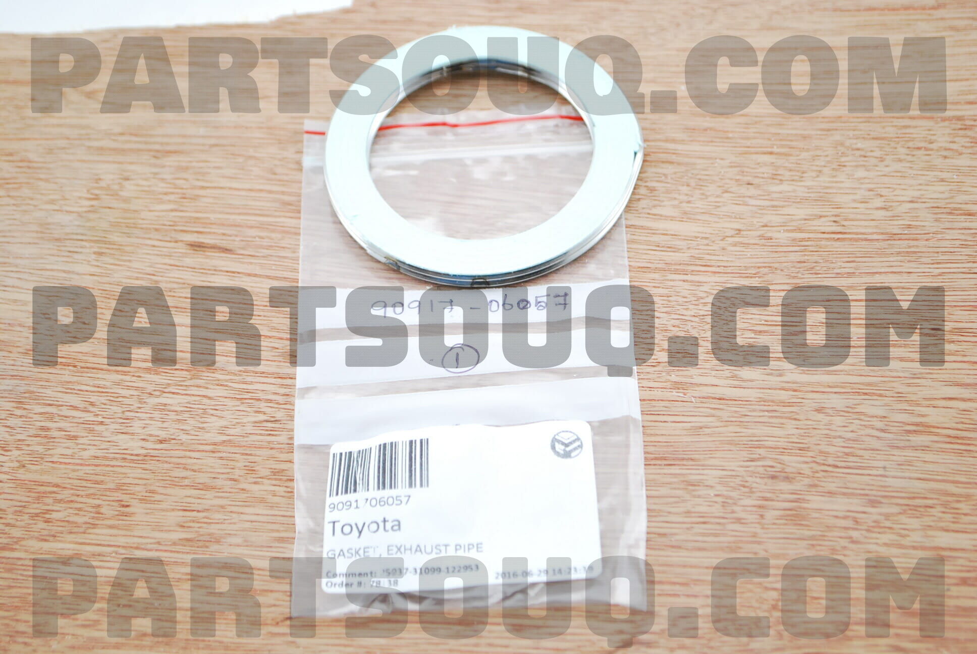

90917-06057 Gasket for photo
90105-10388 Bolt
90179-10133 Nut

there are 2 different parts for that one...and I can't remember the one I used.
one is $3 and the other is $5 so maybe just get both and your good? if your going to fix this youself? I would also get the bolts/nuts for that connection?
17451 is not the part number, it’s an item code or something. I am confident that the one you need is the part number I posted earlier but at this point I agree with sleepydad, it’s really cheap just buy both since you’re worried
