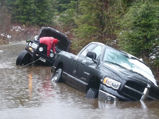

Just a tip for some who wheel... disconnect the latch on your hood so in times like this the hood can be opened from the window before you go crawling out to deal with the winch, never understood why my bddy made me do it until today.
