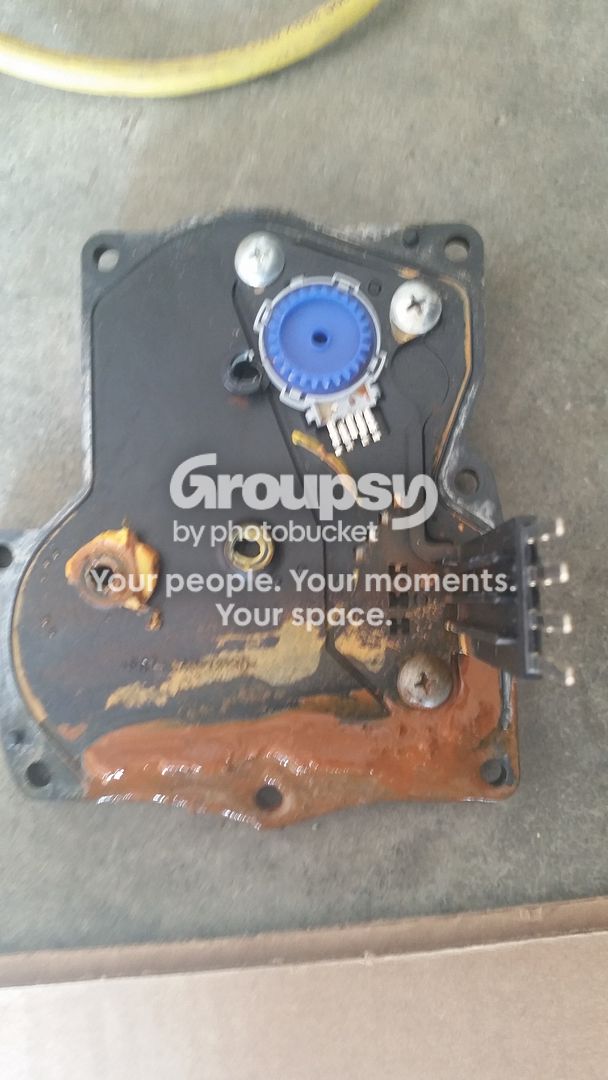

I didn't take the actuator off just opened it from the bottom. I think i just have to find the right spot for this blue gear. When i tried it a few times i was getting the 4wd light but it was in 2wd with the front hubs locked.
This is the gear i'm talking about but its a fuzzy pic so cant tell where the line is to time it
if not mistaken, this blue gear can be seen through an inspection window on the black plastic cover from the outside. Perhaps one of the members can snap a picture of it to show the position of the gear when in 2WD mode.
Eh, good luck with that; honestly I mean it. Because so far I haven't seen anyone successfully re-time one of those actuators reliably (I even tried as a last ditch effort for a customer with a stuck actuator issue.)

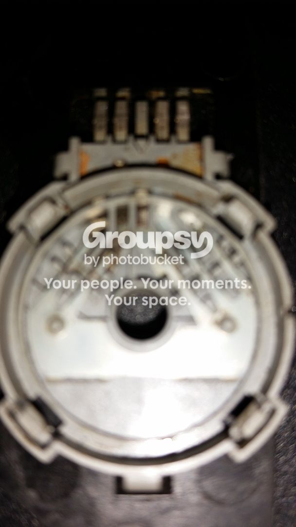

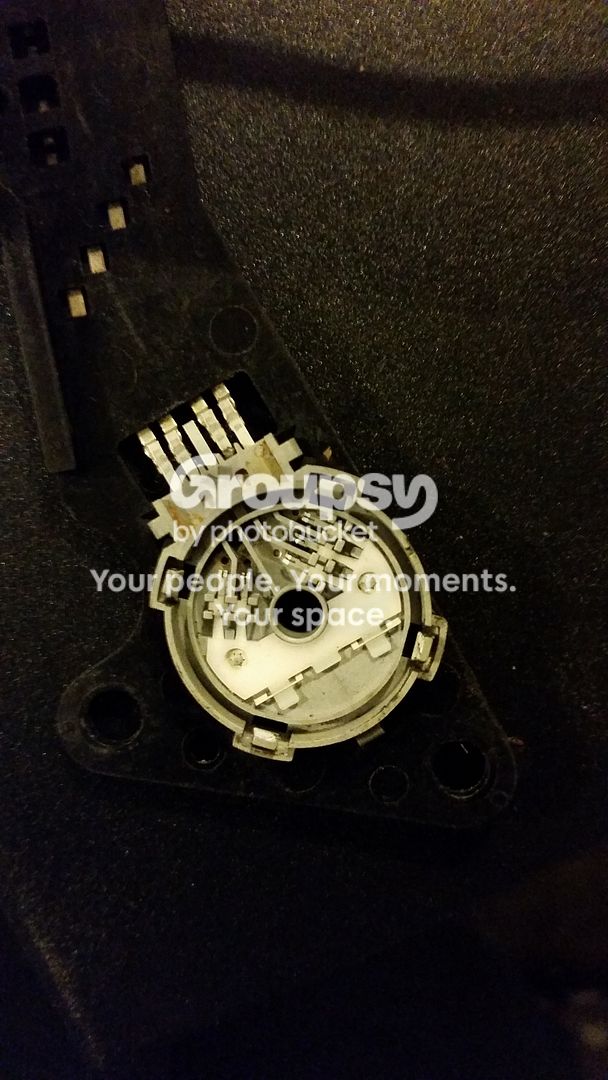

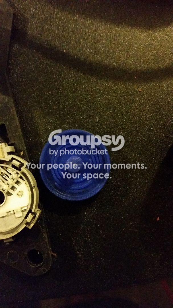

I figured out why I couldn't get this thing timed no matter what I did.
The blue gear is what tells the truck where it's at in the cycle.
It does that by pushing down on the prongs that connect to each other. Simple enough well mine had dirt in it and i couldn't get continuity when bench testing it.
After I cleaned it still nothing so now going to try to find a donor or just might have to shell out the cash and split the case. Looks like some of the silver rubbed off where the dirt was.
