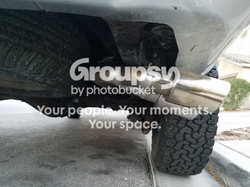

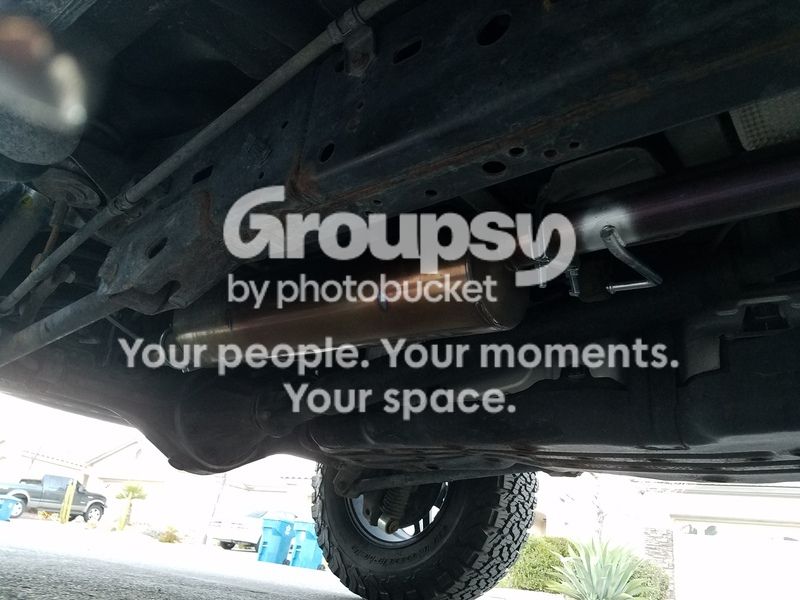

Burtman set me up with the new Gibson dual side exit catback.

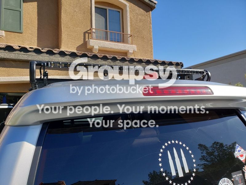

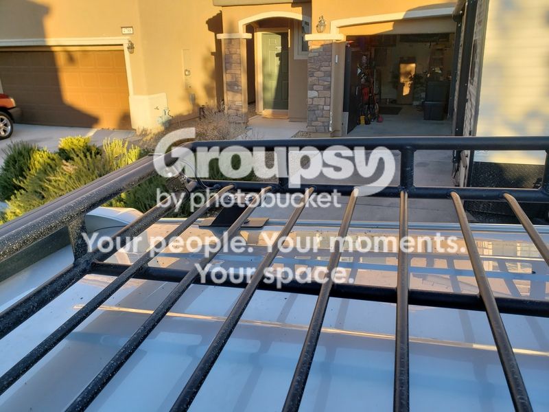

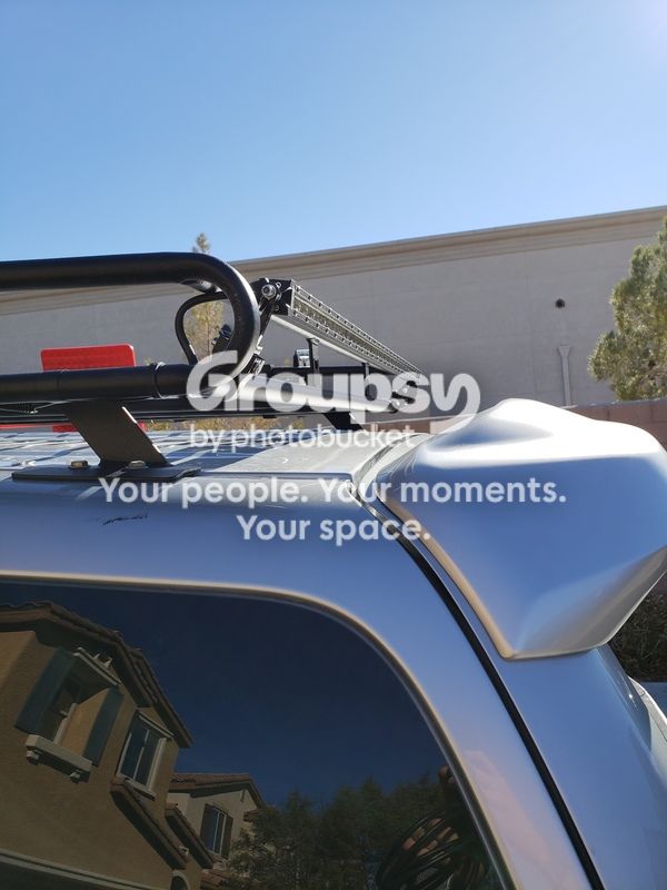

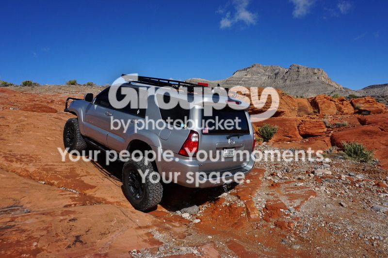

I then bought a Bajarack.

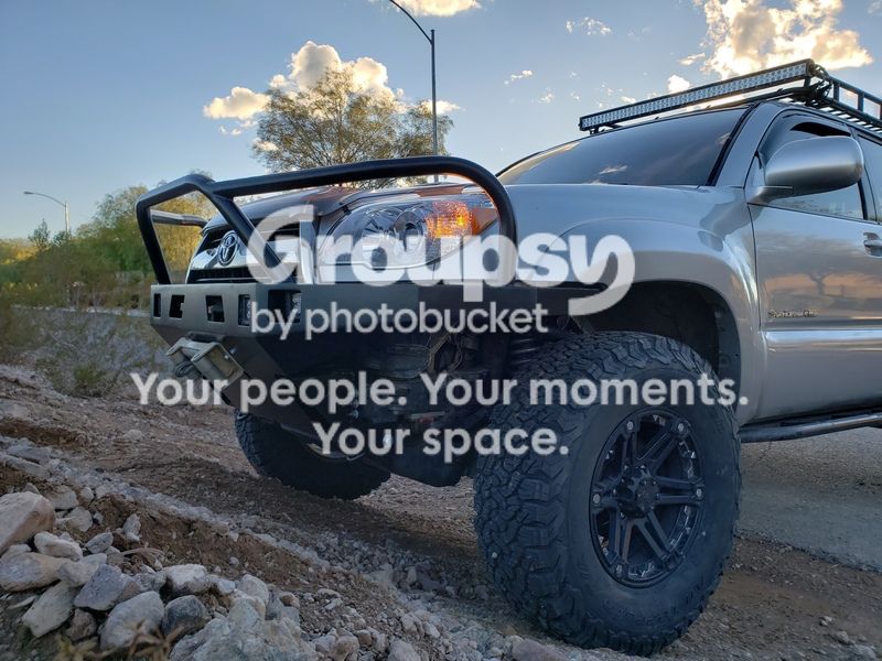

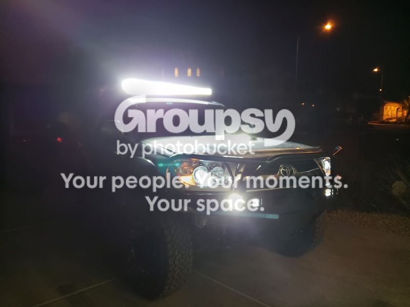

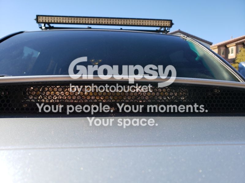

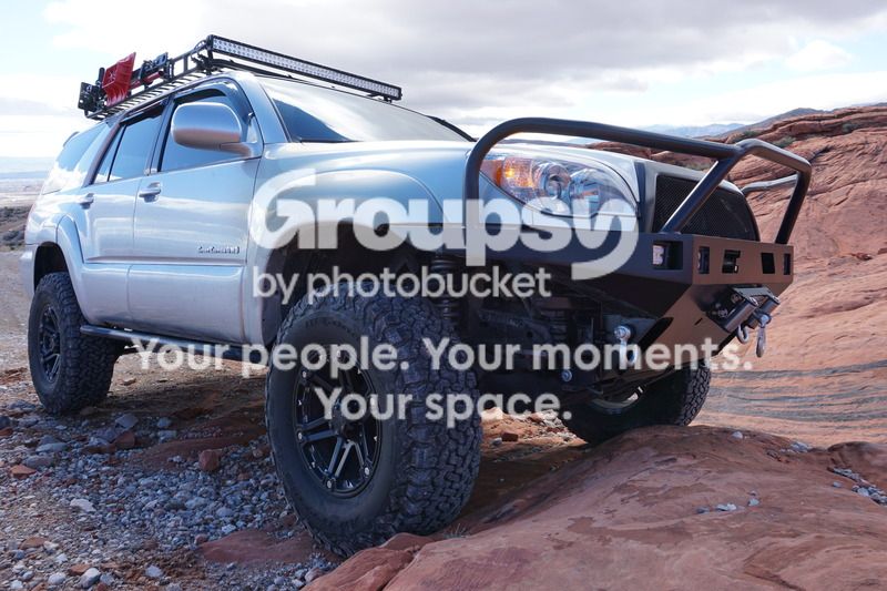

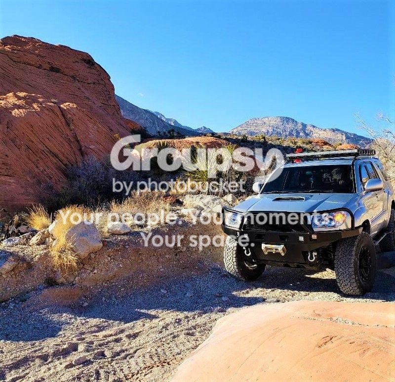

I started with a Y pipe from URD and a OPT7 50" light bar on the baja rack. C4 Fab hood scoop light bar as well. I have ordered URD longtubes and am currently awaiting there arrival. I also replaced the old yellowed headlights and installed some OPT7 Canbus HID lowbeams and LED highs.

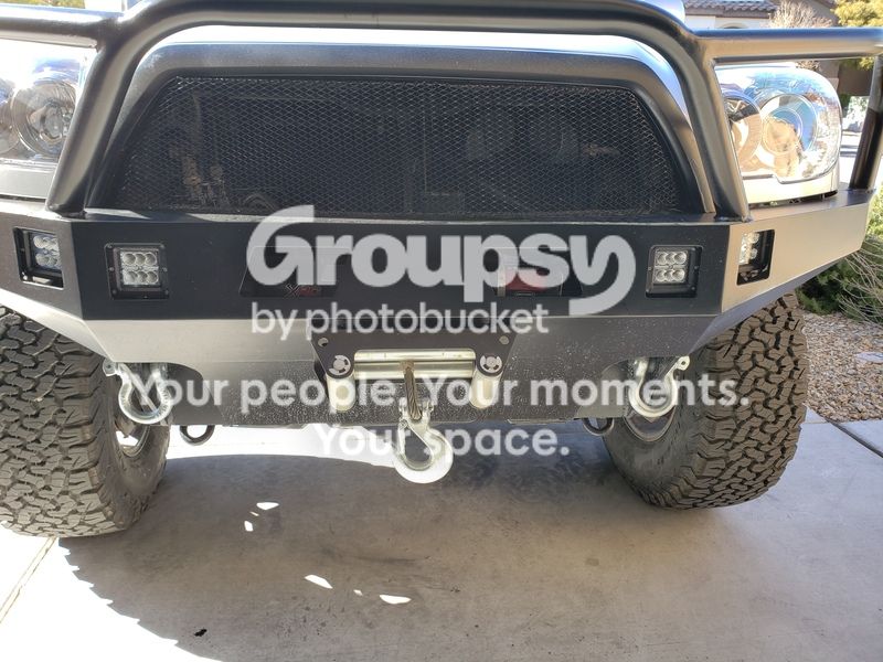

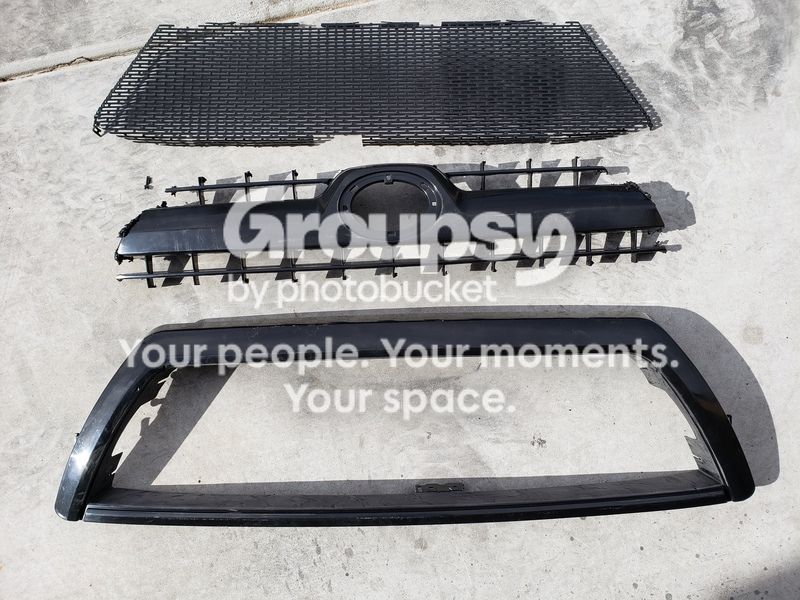

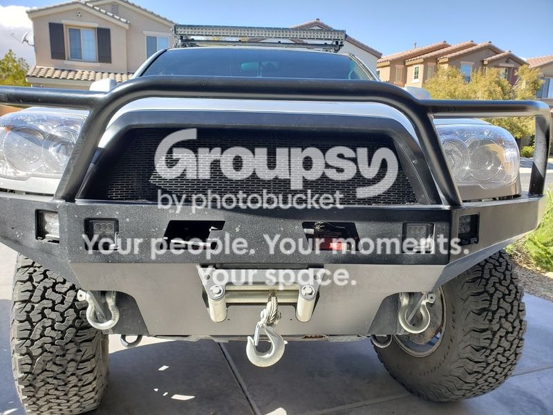

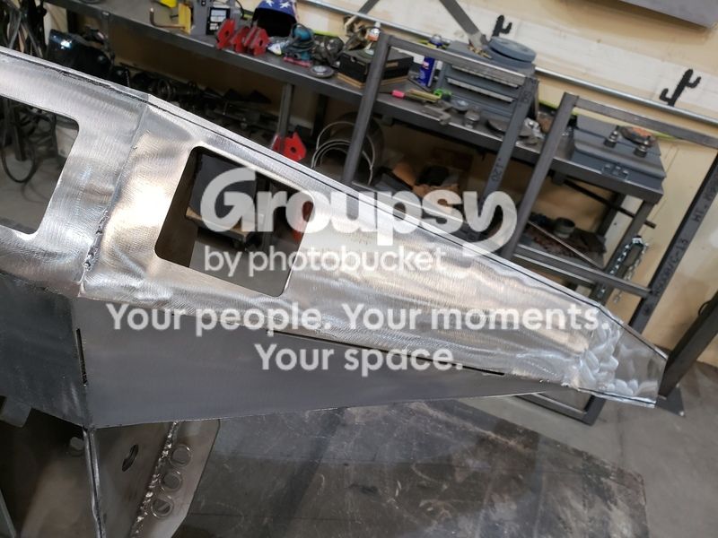

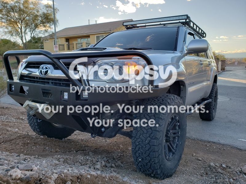

I then ordered the 4x Innovition DOM sliders and Coastal offroad Front bumper with 4 sets of light pods.

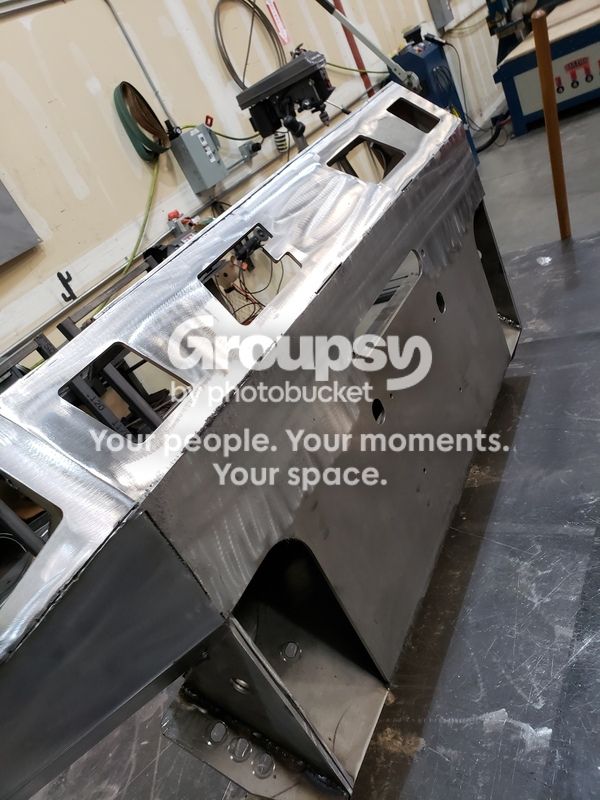

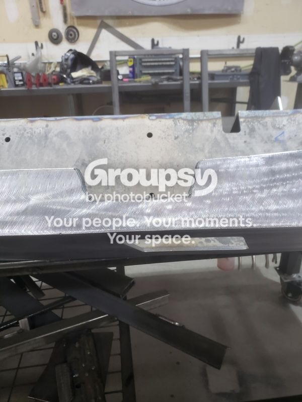

I did all the welding and grinding. POR15'ed the sliders and had the bumper Powder coated. I installed a single row light bar on the back.

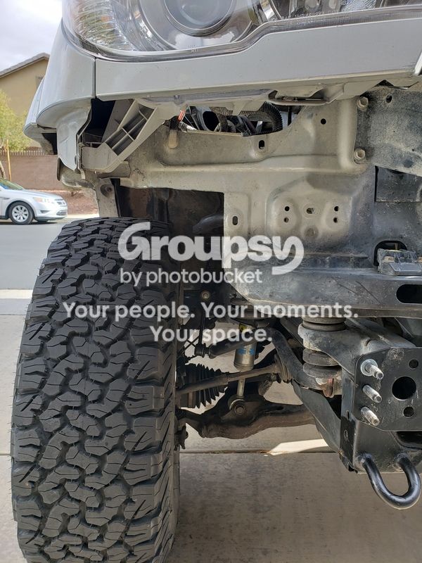

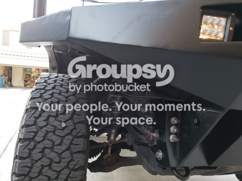

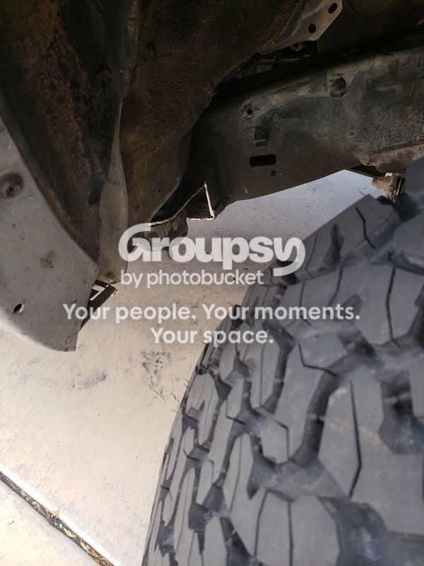

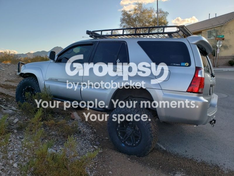

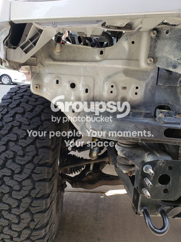

I did the body mount chop to allow new tires to go on. I got another set of KO2's in 285/75.

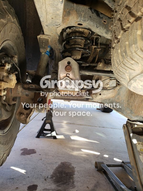

I also did the panhard riser bracket from EIMKEITH.

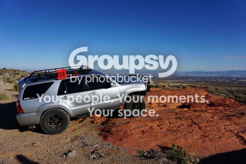

Swapped to Toytec 2.5 springs up front and smaller spacers.
Bajarack Hilift jack mount w/ jack and base
I have a Smittybilt XRC 9500 Winch I will be installing very very soon.
Bumper assembly
Body mount chop
Rear panhard bracket
New BIG tires

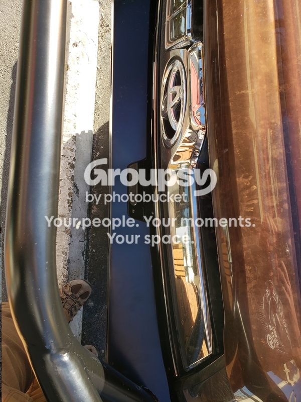

Hand slot I cut out to allow access to the hood release
Lights all installed

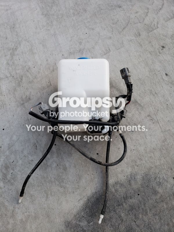

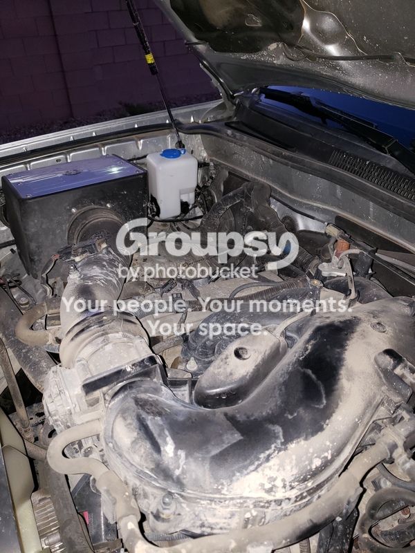

I plan to relocate the windshield wash res. and trim the excess factory sheet metal that is exposed in the front bumper area.

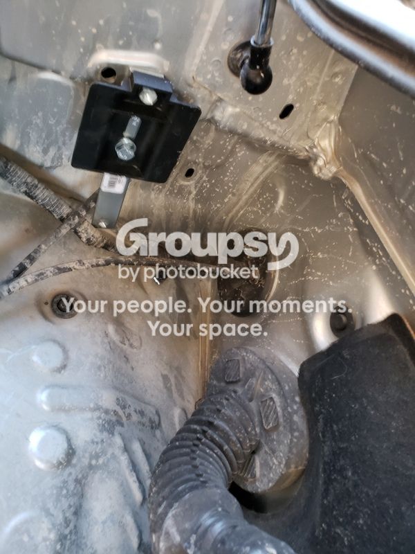

Chopped that ugly metal and painted

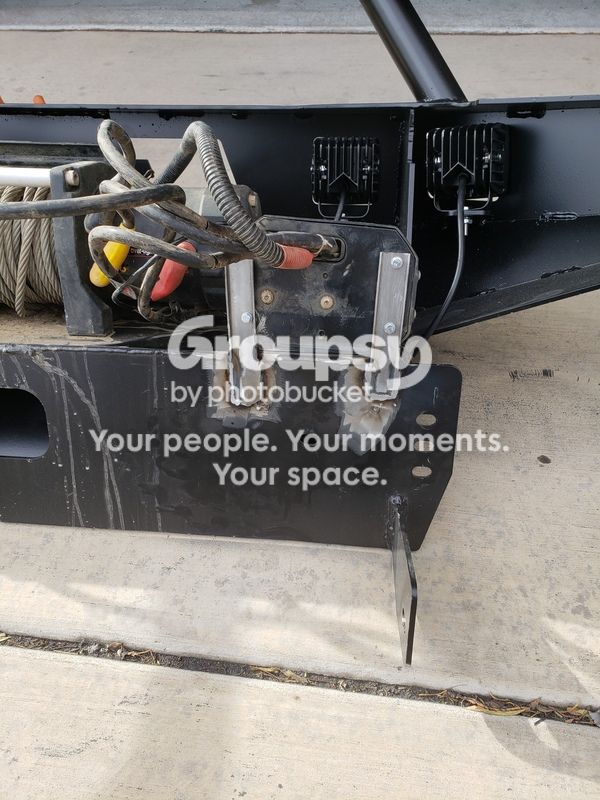

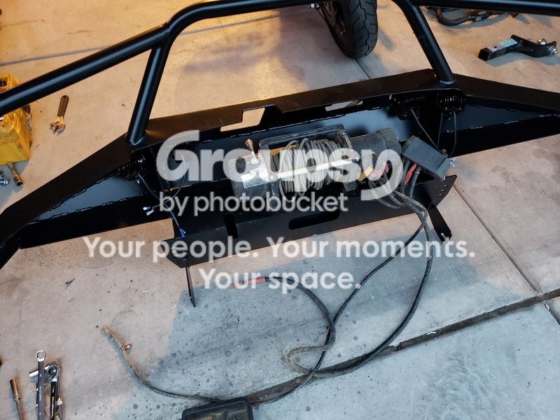

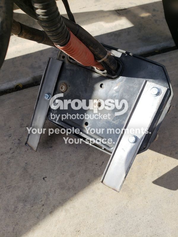

Winch, with my home made fab solenoid mounts. Cut rectangle tubing saving the edges to keep a C shape for structural integrity

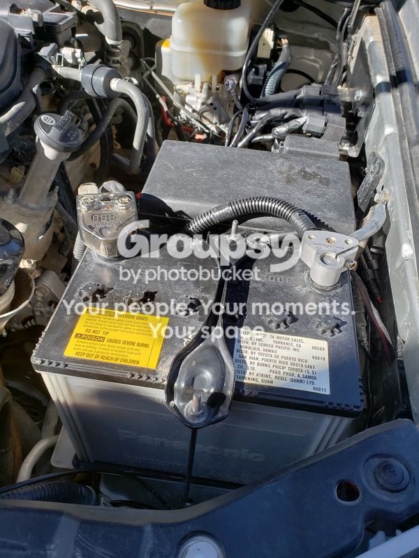

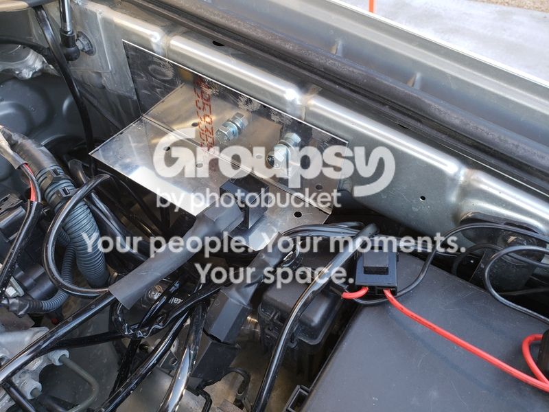

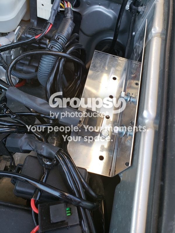

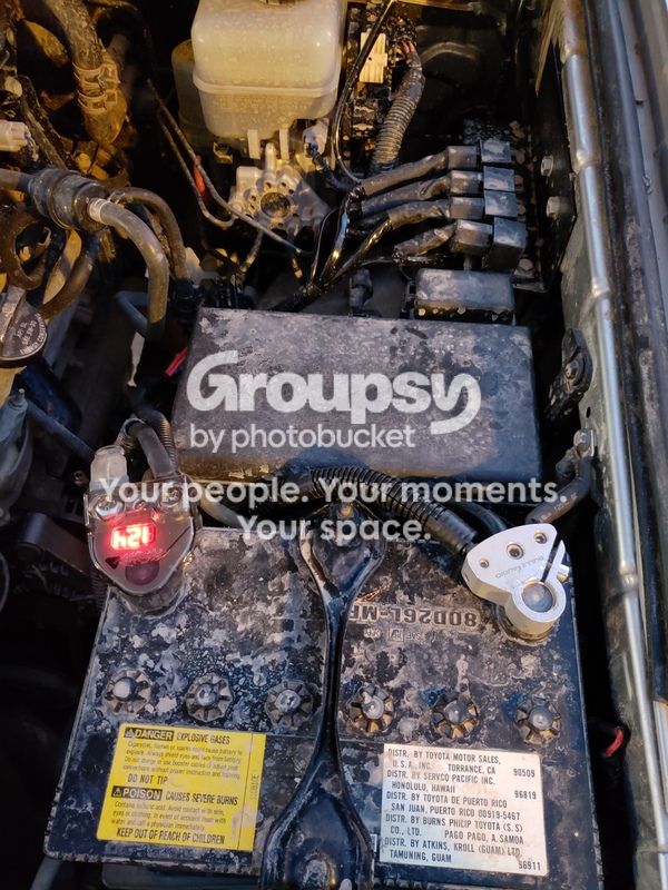

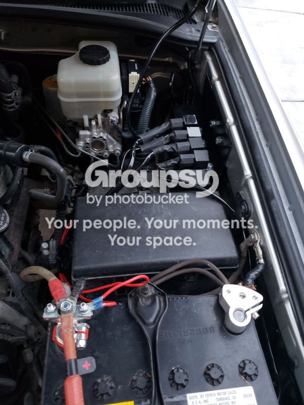

Cleaning up wiring under hood and mounting relays. All drilled. Time to paint, then splice and tuck wires.

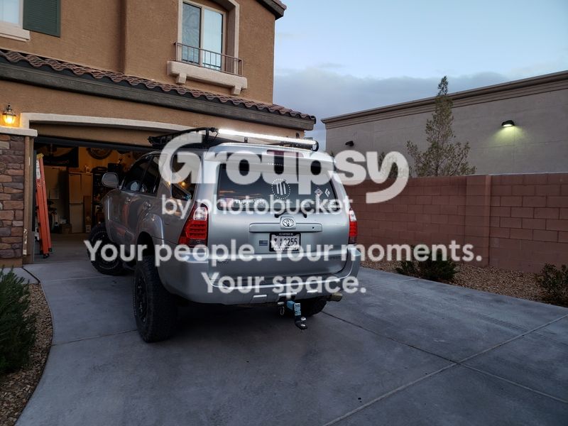

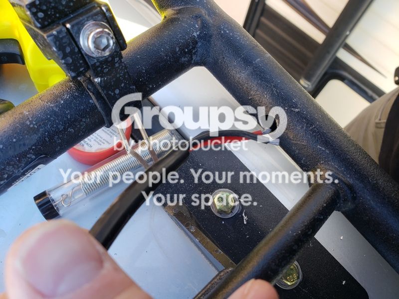

Ran rear light bar wiring inside rack tubing

Hey, Quick question... I also have an '07 and I was wondering if changing the tail pipes to going out to the side versus straight back helped with that "rotten egg" smell when you quickly accelerate.
