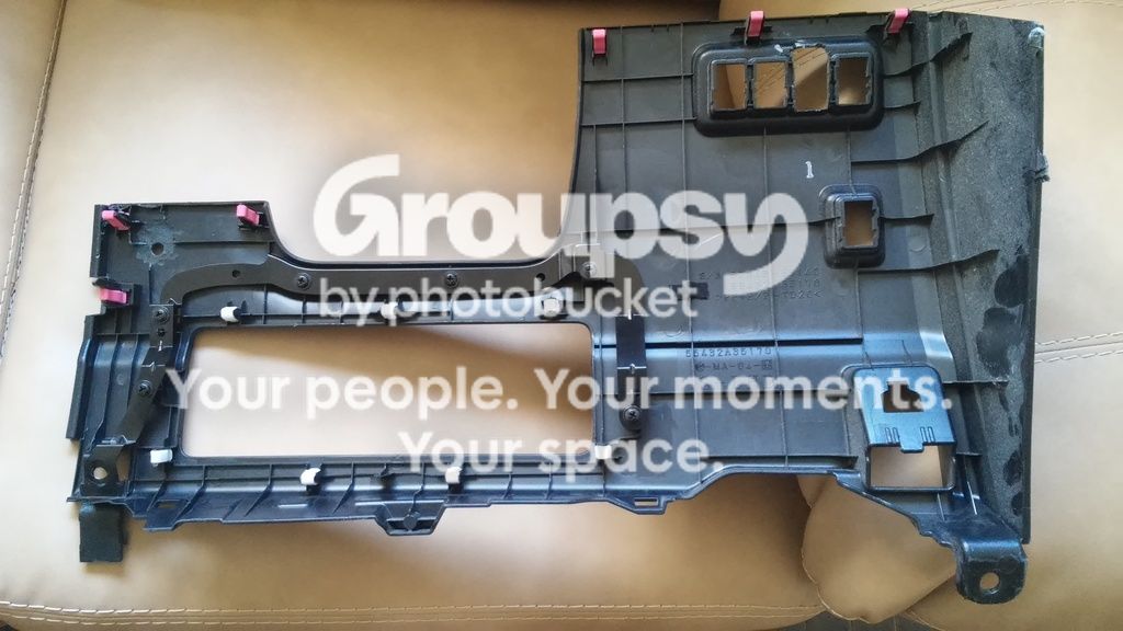

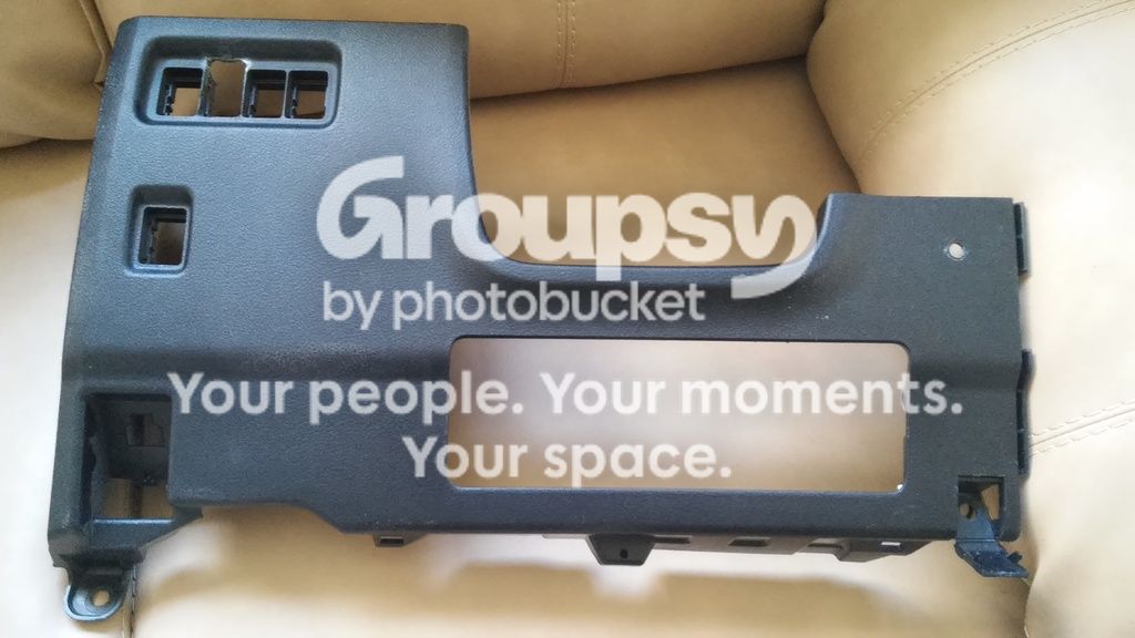

Because I realize that we have some members here that aren't yet familiar with removing any parts from their trucks; much less parts from the interior and dash (some of you folks are AMAZING with what you do w/ your rigs... ), I thought that these photos may serve to assist in the removal of the 'Lower airbag knee bolster panel' as mentioned in an earlier post, "See below":
The first photo (above) is to show the two mounting screw holes at the lower left and right of the panel; the one on the right has a 'Hinged plastic insert' to cover it, just use a miniature flat tip screwdriver to pry it open.
This photo should help to illustrate the location of all of the Pink and white push clips arranged throughout the backside of this panel... and again you see the two mounting screw holes at the lower left and right... to reinstall this panel, line it up w/ the dash, push in and tap; you should hear it snap in. Then replace the two 10mm screws and that portion is done. Replace the "Temperature control trim panel by lining-up and tap in. Now slide the leftside 'kick-panel' back in place, and then re-install the door sill by lining it up and tapping it down w/ your hand... DONE!
