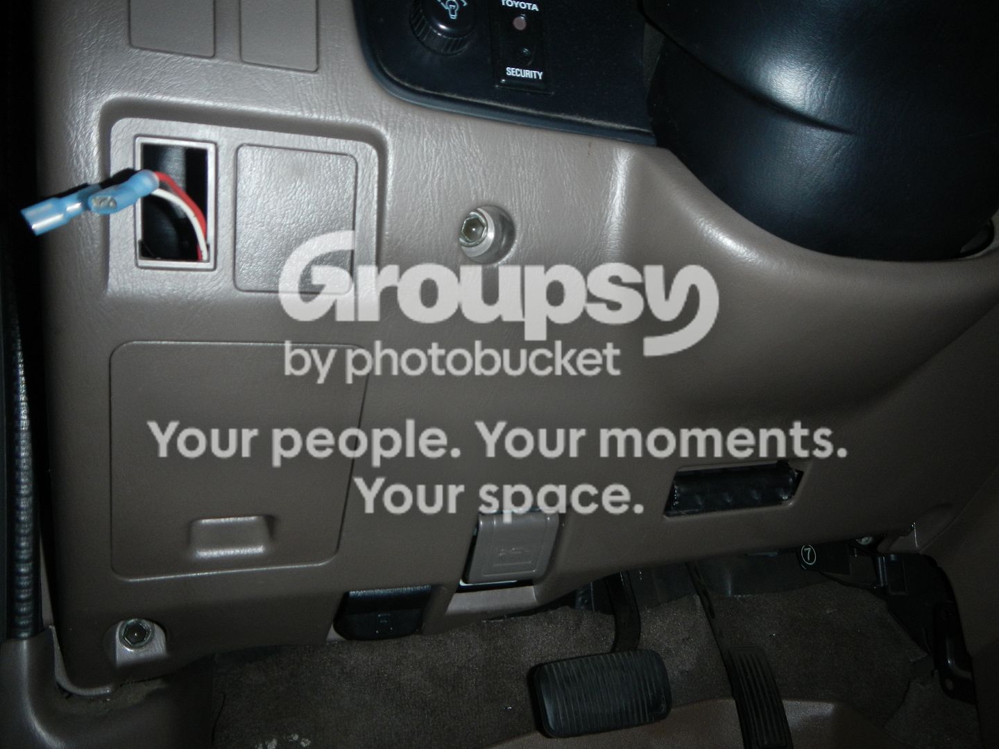

The dash cover under the steering column was removed by removing the gas cap and hood release pulls. Each had two screws and the must be pushed
toward the pedals to unclip them. The clips help keep the pulls in place during installation. There are four (4) 10 mm cap screws.
4-There were several cavities which must be for switches for different model 4Runners at the cover under the steering column, so I used one of them.
There is a red and white stripe wire located at the bottom and in the middle of the connector. I clipped it, but left a small section just in case I had to reconnect it.
A new section of red wire was soldered to this wire and heat shrink applied at the solder joint. The other end had an insulated connector at the switch.
A second white wire with an insulated connector went from the new switch to a ground screw under the dash.
See above picture.
