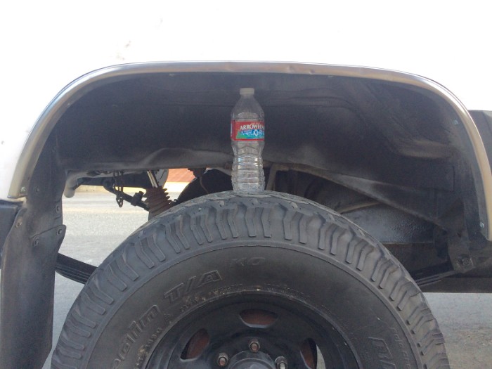

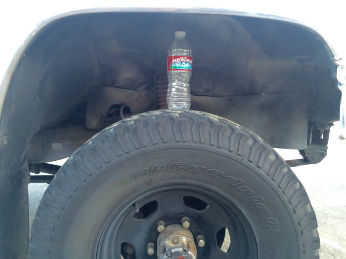

I finally got my OME leaf install done this past Sunday, and it's awesome! Unfortunately, I underestimated how bad my shocks were, so my ride is now just super bouncy, but overall it's a lot more smooth and I can actually go over speed bumps now. Here are some pics :
Here's how tall it is in the rear (water bottle for scale, which wouldn't fit before the install).
Here's how tall the front is (water bottle for scale, again).

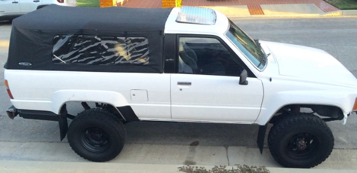

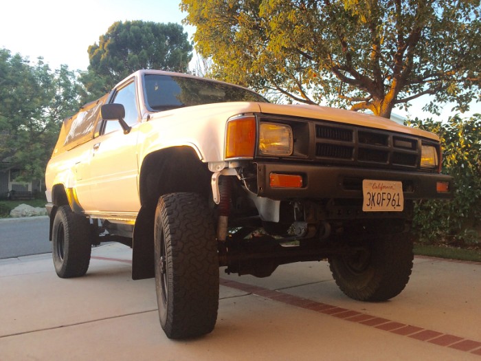

Here's a nice photo I took. The truck all in all looks pretty even, all though there's about an inch of rake. It looks nice, I like it, install was a pain at first until I used ratchet straps to move the axle, then it was really easy. I'm goin wheelin this weekend so we'll see how it goes!

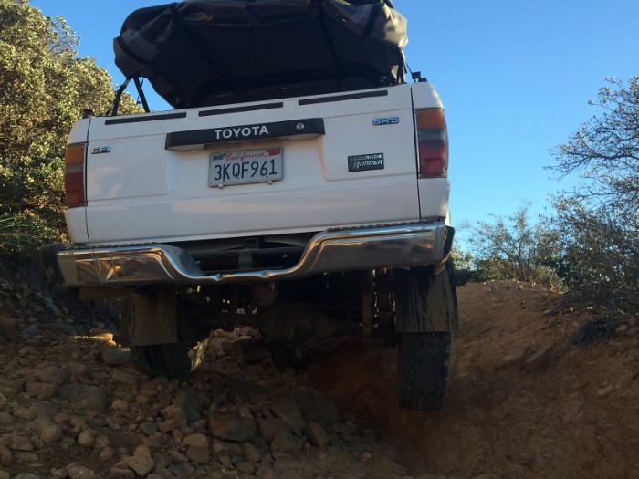

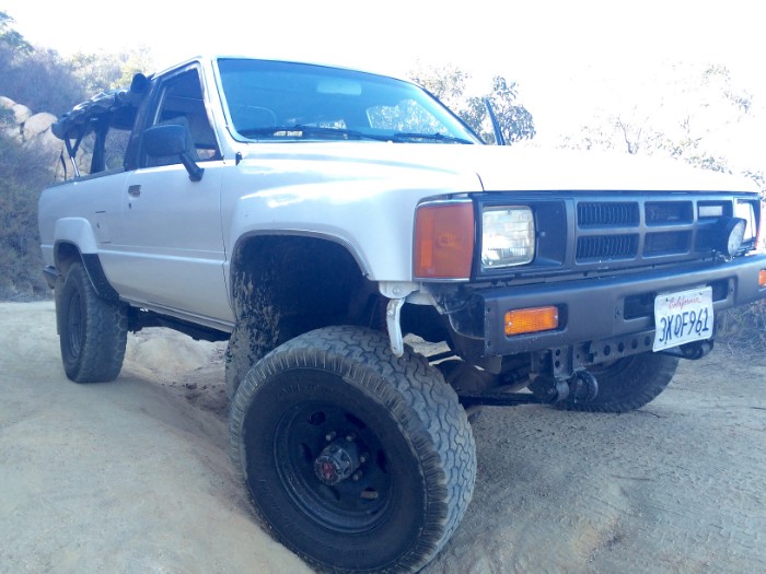

Finally was able to test out my leafs offroad. I fully flexed the rear a couple times (wheel off the ground) and I have a good amount of flex. It's not amazing, but it's pretty good. PICS
Kinda hard to see, but my rear passenger side tire is off the ground a few inches.

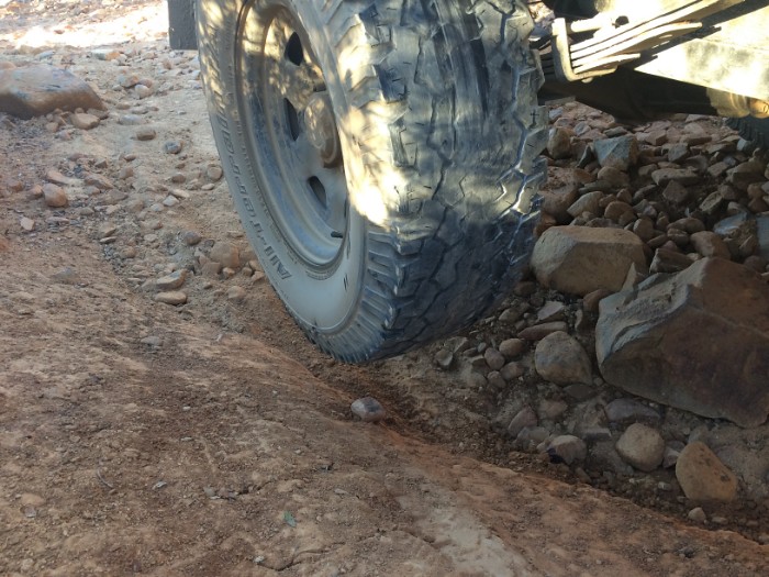

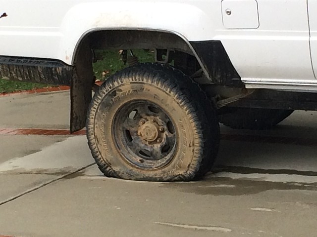

Here's a better pic of my tire off the ground, and my awesome tread. I actually found out I have a small gash in this tire today :Cry:

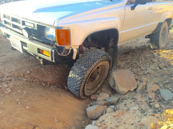

Probably my favorite flex pic of the day
Cool view
That's about all the good pics I got. Most of the time today I was actually doing some go fast stuff (40 ish mph offroad), and the leafs held up surprisingly well! My rear shocks are basically blown, so it's super bouncy back there, but otherwise it actually rides really nice off road. I'm pleased. :biggrin2:

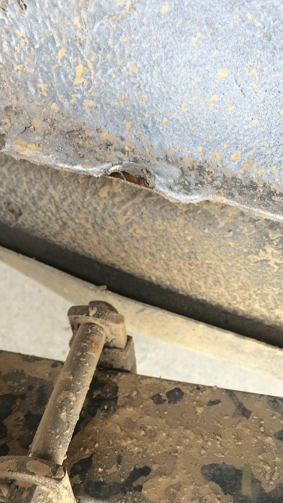

Actually, I have a question, my OME leafs hit the gas tank a tiny bit when flexing. Is there a fix or a way around this? I think it'll clear now since I bent it pretty good, but idk.
I haven't had that problem. I'm running 6" shackles, maybe that's the difference?
Nope, just plain ones. I've been thinking about going back to stock shackles though, I'll have a look to see if I hit the gas tank skid if I do.
Check the clamp on the leaf spring and make sure bolt head is toward the inside. Some people have had the threaded end contact gas tank skid.
Yeah, I actually swapped the bolt around so the threaded end faced away from the tank as soon as I got the leaf spring, since I heard of this issue beforehand. It still hit it though, but it definitely could've been worse if I hadn't flipped it I guess.
