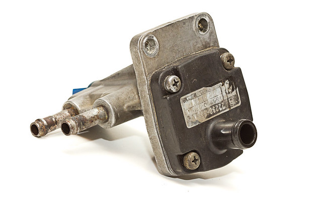

It might just be this thing:
image stolen from the internet!
I used to have all sorts of issues running up hills when I still had this thing installed, it would be fine then all of a sudden, its like someone hooked a thousand pound anchor to the back of me!
This is the air flow valve, I guess it does some weird heating of the throttlebody which reduces power in the system. Hot air = no power.
Not saying this is the issue with yours, but it has been known to rob power when a load is present. Replacing the whole intake manifold, throttle body and eliminating that valve is what I did, the '89+ engines had a different efi setup that works much better than the original setup. My truck has been solid for many years, and I'd get in it today and drive it cross-country any time!
I will definitely look into that! however, I don't think that that's the issue, because I only get poor power whenever the CEL comes on, and it's giving me code 12 for knock sensor, so I think my sensors just bad and it's misreading something and setting back my timing to 0.
