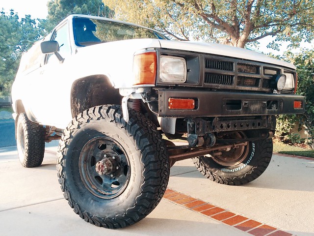

So I got my 33's on today (33 x 10.5 x R15 BFG A/T KO2's), only drove with them on for like 20 minutes and saw some huge changes (good and bad).

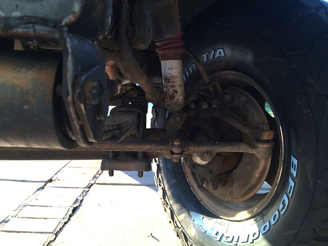

Clearance of leafs n stuff :
It clears everything as far as I know, and there's no rubbing so that's good. Only bad thing I know for sure is my gearing is slightly too low for these bigger tires, but otherwise, I really like them! Idk when I can go wheeling next, but I want to go sooo bad. stoked

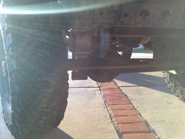

So I've been taking my truck out to this dirt thing on the side of the road to test out my flex before I actually go wheeling, since I pretty much just got all the suspension redone in the front. Anyway, I wasn't even able to get complete flex (brake lines too short), I still had a good 3 inches from the frame and bump stops, which is awesome. I have new 10" Rancho RS5000 shocks, which are much less limiting from my previous shocks (i have no idea how long they were). Here are some terrible pics!
I was getting some seriously terrible rubbing at minimal flex before when I had 2 inch spacers in the front. I decided to get rid of the rice, and now I am just barely not rubbing. WOOO
It's pretty funny having a ton of flex in the front and hardly anything in the back :jump:

Thanks! The soft top is amazing (besides the fact anyone can break in effortlessly lol). With my rear, im 97% sure it's my shocks. They're too short, and are limiting the travel a lot. Ill probably end up getting new ones when the summer comes around.
