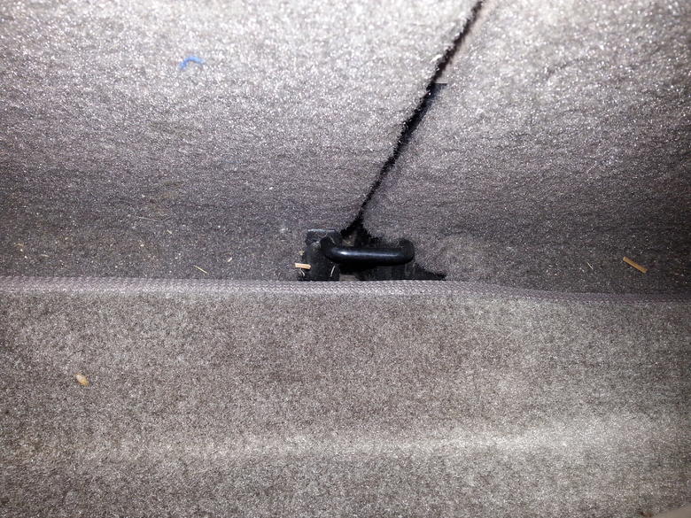

The middle seat child seat anchor is at the bottom where the 2 back seats meet each other and the back area flooring.

Can you tell how the anchor is mounted? Is it welded/integrated in to the seat bracket, or is it a bracket that's bolted on top of the seat mounts. Is there a way to pull the carpet back a little to see it? Sorry for asking. If anyone's in Vegas I can just look at it in person instead of buggin y'all.
