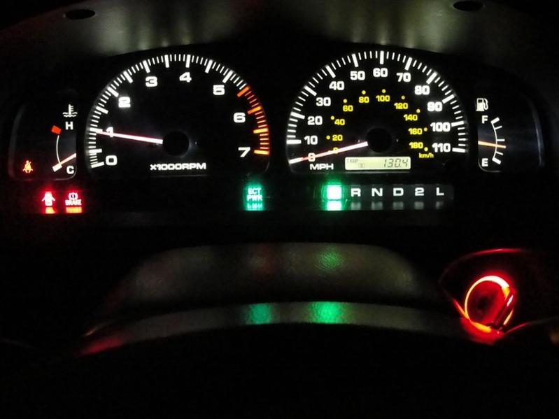

there are a lot of posts on this. it took me a while to find what i wanted but this is the end result. the a/c control uses 3 neo4 and the back window/ect uses 2 neo3. i had white for the key ring, but red gives it more flavor. these pics don't do the lights justice. they are brighter.

thanks my man, I wasnt looking hard enough you were talking about #24 on the list of them correct?
the bulb number is 24, for the cluster, 3 ea. there is a crap load of 74's that light up all the other lights. you can change them too if you want. i chose not to.

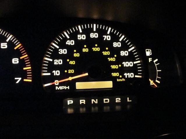

Also, you should post up some pictures of your gauges. I just did the swap last night, and the #24s I got aren't nearly bright enough, so I'm thinking about doing them again with different leds. I'm curious to see what yours looks like.

Theres some hot spots I know, I have to get back in there and wax paper that stuff
