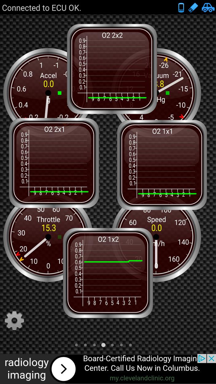

So the original code p0156 bank 2 sensor 2 is the code that is on again. This is the sensor I replaced twice (both densos ).
For those that don't know, if you use the torque app to read Bluetooth obd codes, you can graph each 02 voltage. Below is mine. There is no voltage shown on bank2 sensor 2 and also the front two . Do I replace bank 2 sensor 2 again?

Currently, P0136 and a pending P0174. Both downstream sensors have been changed twice. I've got a new A/F relay on the way to try that.
Is it possible that one or both CATs are bad? How do I identify this?
