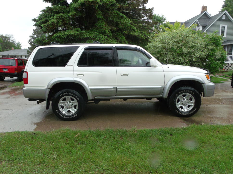

a 1" BL, '99 coils, and 285's have served me well for the last 4 years. I put the coils on the shocks that were in it when I bought it stock.

Here's a pic of my 2000 with 99 talls installed. Raised it 1 inch exactly. (245 75 R 16's)
