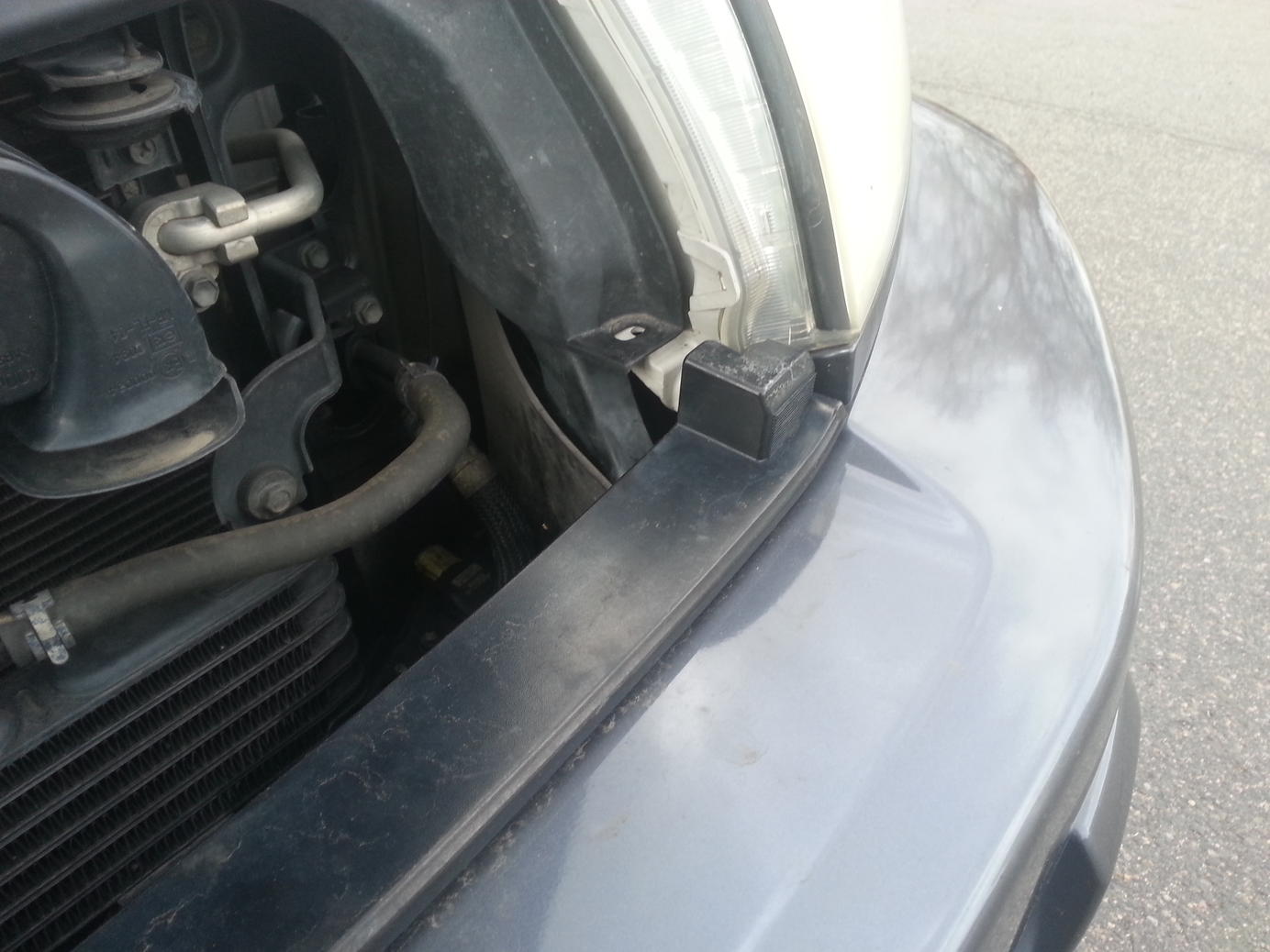

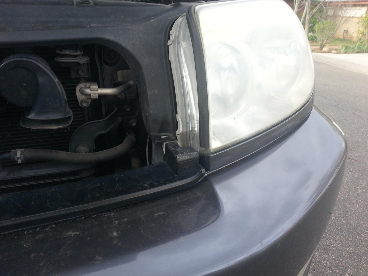

Hey guys im new on here so im still trying to figure everything out but I guess my main question is does anyone have a step by step to installing the spec d lights including the wirering of the leds for a 2004 ? Do you have to take the whole bumper off ? I got to every bolt on the lights but the front bottom, part of the bumper is blocking it .thanks for the help
Bumper doesn't block it, you're probably stuck on the 4th bolt on the bottom leg. You can access that by pulling back the fender liner.
Thanks for the response guys it really helps but still having trouble with the front bolt maybe its different on the sports edition? I noticed in the pictures that it didnt have the same peice along the top of the bumper. Ill try and get a picture up when I get home again thanks a lot
Here's what im dealing with

[MENTION=109777]edrynan[/MENTION] sry for the late response, i simply cut off a lil portion of that small plastic to have more access to the screw there

For the install, I just pryed back the plastic piece to access the bolt.
