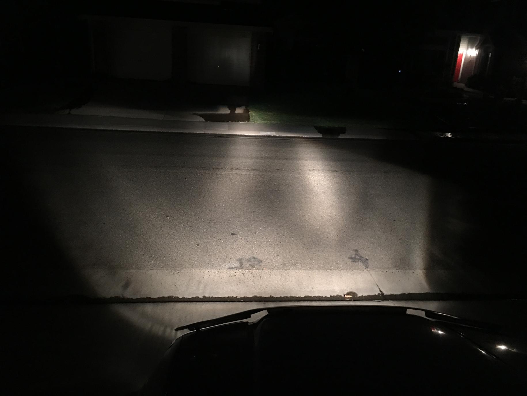

Just installed the Spec-D silver housing projectors. I didn't want to spend big money on a retrofit. So here's the unadjusted beam pattern with the standard halogens, parked slightly pointed down in my driveway. I did not wire up the halos nor 3 LED "eyebrows" & probably won't (too ricer-ish).
WTH is going on, on the right side ?????
I have a set of Philips HID 4300k bulbs from [MENTION=12905]XenonDepot[/MENTION] awaiting install but figured I'll run the halogens a bit to check them out.

its the projector itself, its crocked from the manufacture, that is why us with the true hid retrofit always suggest ditching the aftermarket halo projector headlights and spend it on a real retrofit, you save money and headache at the end.

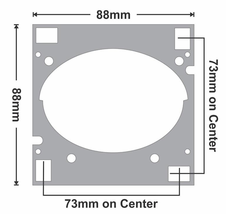

I just learned from Retrofit Source, that they have a "Retro-Quik" bracket with Mini H1 projectors, for Spec-D lights $50-$80. They do "suggest checking out the bolt pattern to make sure it matches." If this works out, I could have an easy retrofit using my existing
XenonDepot 4300k Philips bulbs & wiring, & replacing my existing crappy-beam-pattern Spec-D projectors without any cutting. Has anyone tried this route before?
https://www.theretrofitsource.com/c...o-retroquik-spec-d.html?preselect=51266,50408
