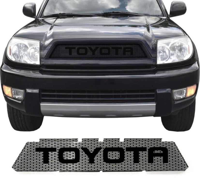

Any instrest in Satoshi Grilles for 03-05 4Runners?
I will soon be making Satoshi grilles with raptor lettering for 4th gen 4Runners (03-05). They will be priced at $320 USD plus shipping. Any interest? I will make the first prototype to show the expected look of these grilles if enough interest is shown! Thanks all!:cheers:
website? pictures? examples?
The attached photo is the precut grill I will be using for my first prototype. I will be using aftermarket 03-05 grilles to build around which can then be painted in oem paint colours.
I do not have a website and will be operating solely through forums at least for now. Currently I am preparing for my first prototype so by the time it is finished I will have an example of the final product and will be ready to start making grills for any interested buyers.
My account is very new on this forum but as soon as I am permitted to create my own post I will do that so it is easy for me to reach anyone who is interested. For now if you are interested or have any questions let me know so it is easier to judge the intrest in these for me and easier for you guys to know what you are buying.
