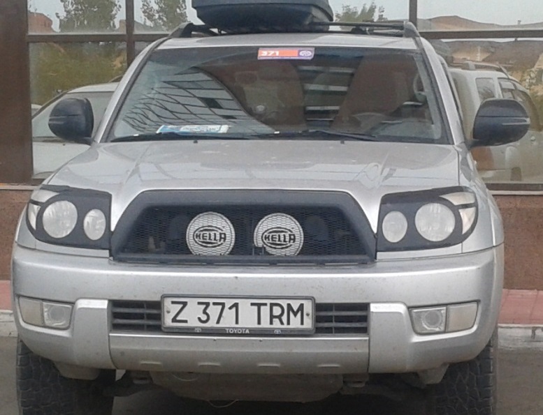

emelianenkov as I see you are doing this thing for same purpose - to mount the addtinal light))
I will mount high beam projector hella 4000
p.s. do you speak russian
thanks!
Well I did the satoshi for both looks and functionality. Putting a 22" bar behind it soon!!!!
What makes you think I speak Russian?
Only your nickname ))
Yes LED bar will be a good choice - as there will be more light and less heat. The only con - there will be no any cover similar to hella light

Draft version of satoshi
cutted to much at sides - be carefull
Lamps will be a bit removed from center and a bit lifted
Hella Covers will be painted
