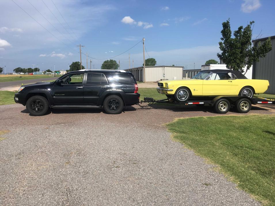

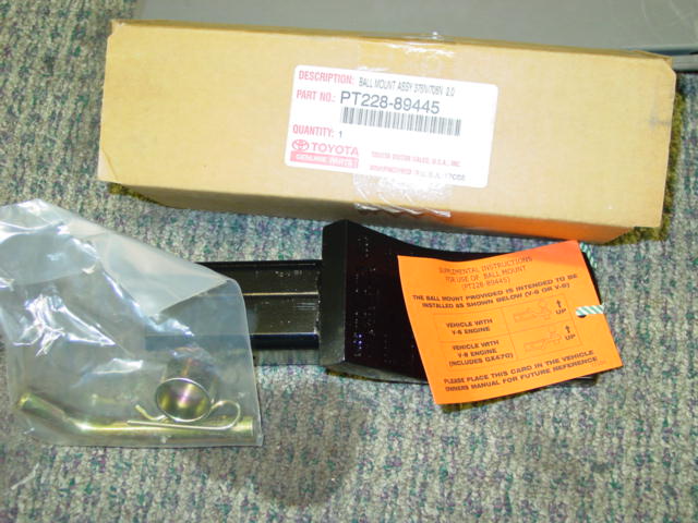

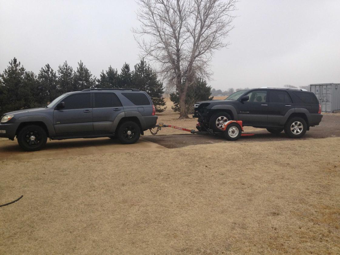

All 2003 recievers are short like yours. They changed after that. Toyota made a special hitch that came with the truck when new. I have towed a lot with my '03's without any problems.
First picture is the hitch. Second picture is #2 towing #3. Third picture is #3 towing my 64 1/2 Mustang.

As mentioned, the factory receiver length is short so you have to have a draw bar that is on the short side. One I have fits perfectly but another I have that is for a different height trailer does what yours does. My plan is to cut just enough off the draw bar tool so it fits. 1/4" in my case. You're not pulling anywhere near the max weight so I see no need to get a frame setup unless you really want it. I pull my 3500lb camper with it and a trailer with my small Kubota tractor in the trailer. Pulls great.
