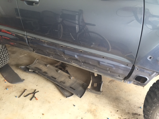

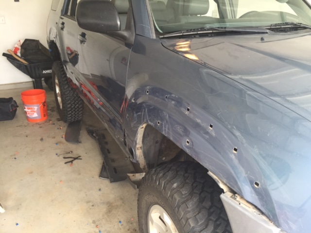

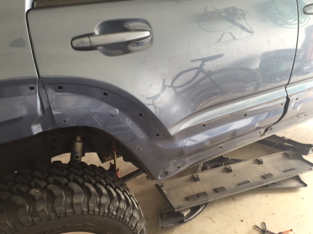

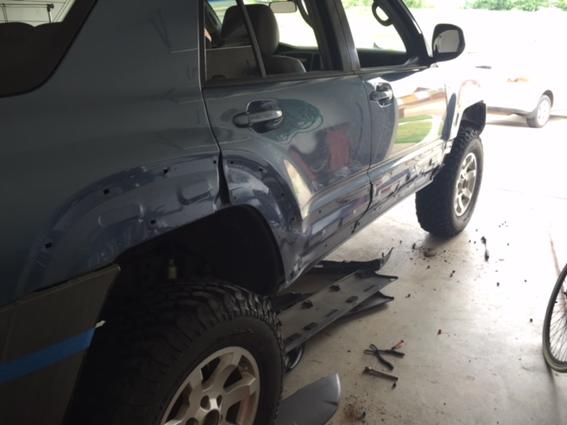

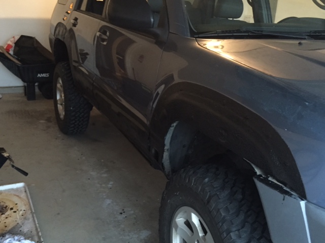

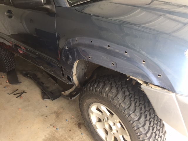

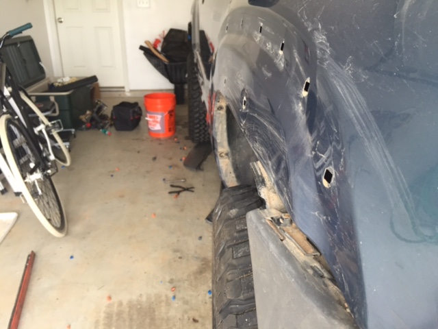

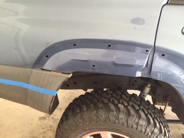

Have had no luck finding an 03' 4runner with the cladding completely removed, only bed lined or painted cladding. So here is my attempt to helping those that wonder what is under all that plastic.
Feel free to ask questions about removal and/or next plans.

I will just fill in all the holes including the two at the bottom of the front fender well and apply 3-4 coats of bedliner.

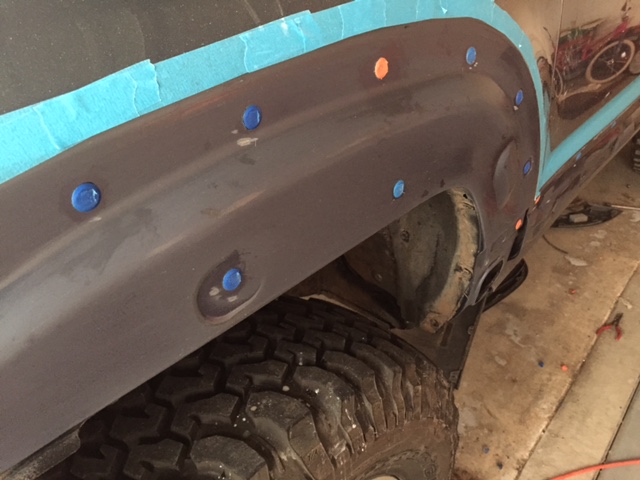

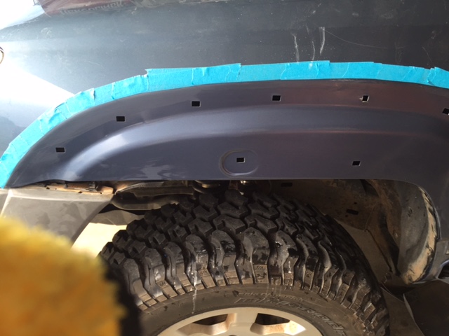

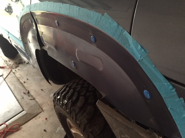

Thanks for the comments. Yeah I put new plastic clips and grinded them down flat and used RTV Silicone on the back for them to glue to the body and stay put. Ill be done tonight and take pics in the morning, applying 5 coats to each side.

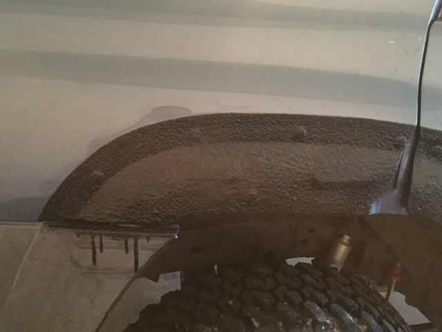

5 hours later:

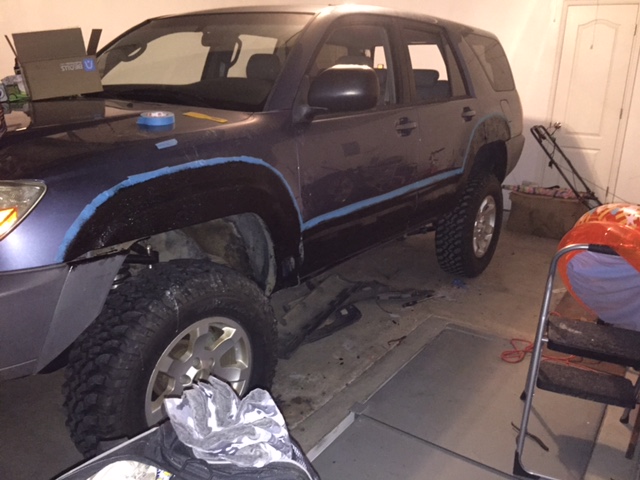

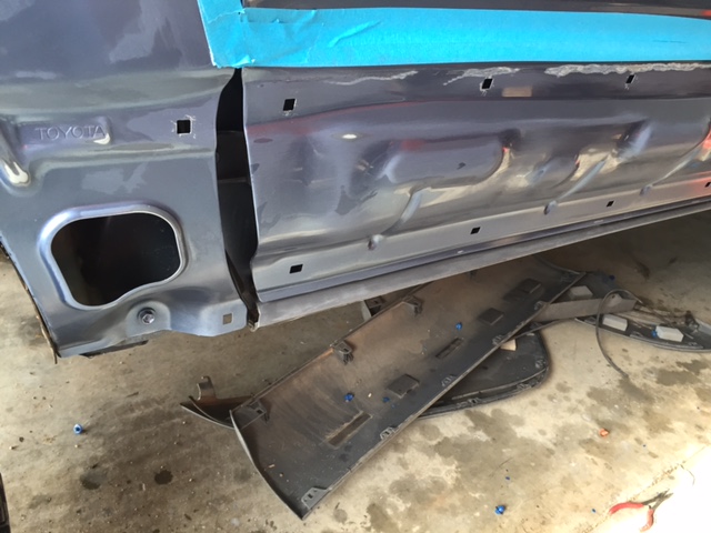

1. Cladding removed and all clips, rivets and screws removed. Body was wiped clean of all dirt and double sided tape.
Note: Using dykes or needle nose pliers grab the clip and rotate 90 degrees then pull out, this makes it easier for clip removal.
2. Painters tape was used to align the body lines.
3. Using a fine sand paper block I lightly sanded the body to remove the clear coat. Wiped down with water and dried.
4. Inserted new plastic clips in all holes. Using dykes cut off the retainer part then ground down flat (seen in pictures). I used silicone on the backside of all clips as a glue and water seal. Wiped body again and checked all clips for alignment, then dried.

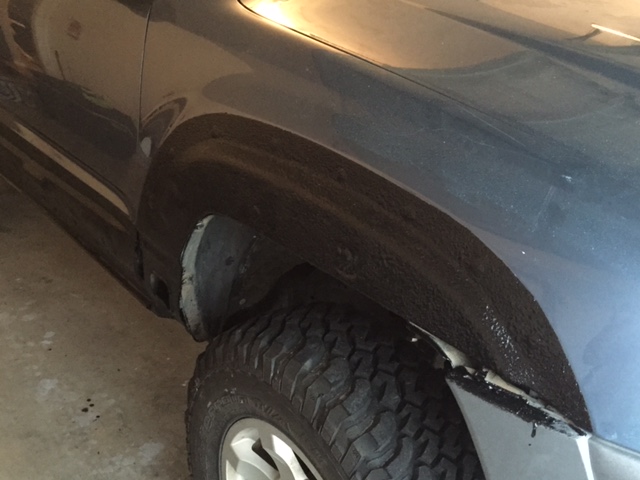

5. (This took about 3 hours) Applied 5 coats of bed liner to each side, with 10-15 minute break between coats. Let it dry overnight.
6. Removed tape and identify any imperfections. Still need to clean the lower rocker trim below the doors.
