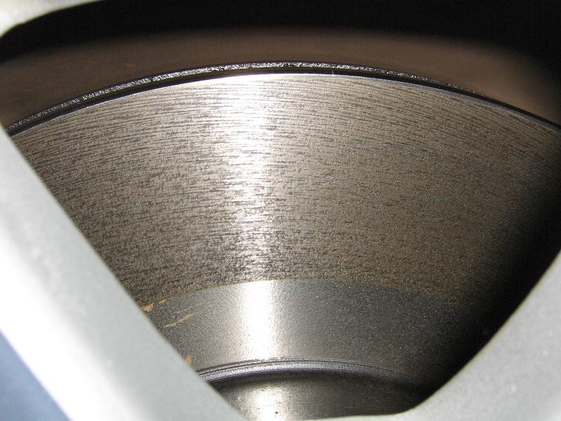

The picture you posted doesn't show any problems....it only shows pad material on a rotor. Every rotor that has been in use has pad material deposited on it. I don't know if you've ever seen a rotor with a perfect imprint of a brake pad on it, but if you have, then you've seen the problem first hand. The next time I see a rotor like that, I'll take a picture and post it. Unfortunately, I'd discarded several rotors like that just recently.
Anyway, the point here is that all used rotors have pad material deposited on them. That's how they work....problems only occur when it builds up excessively in some spots more than others.
I'll take a picture of my front rotors (which are only about a month old) and you'll see what perfect deposition looks like. You can actually see it very clearly.

Okay, I took a picture of the front rotors on my 4Runner. It was really hard to get a good shot, so I had to take several pics under different lighting & flash conditions. Anyway, these rotors are about a month old and I was sure to bed the pads/rotors properly after installing them. This is about as good as it gets when it comes to a nice, even break-in of pad material on the rotors.
BTW, I forgot to mention this earlier--- an old racer's trick for cleaning up uneven deposits on rotors is to switch to race pads and use them to "clean up" uneven deposits from street pads. The idea here is that the much harder race pad material will effectively scrape off the softer material deposited from the street pads. Of course this isn't really applicable to the 4Runner because we obviously don't have race pads to swap in, but the concept is still the same.
