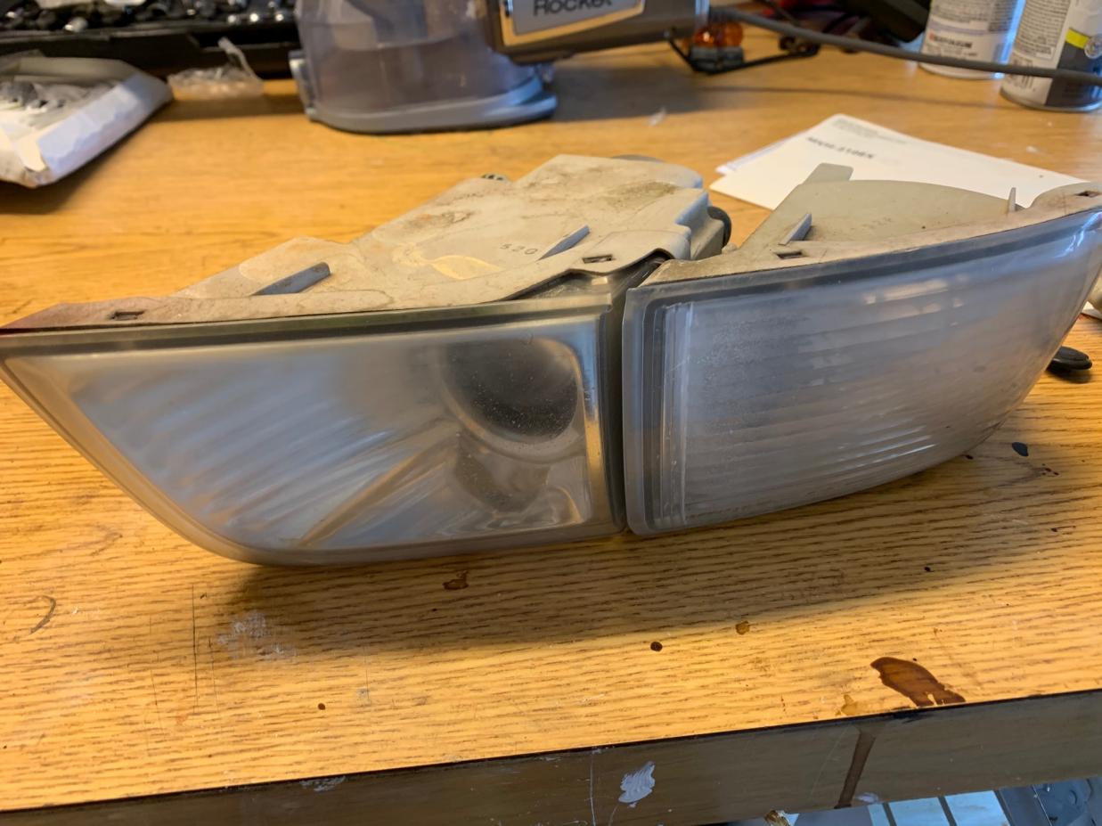

Does anyone know how to get these open? I assume there’s no butyl holding them together and just little clips but want to make sure first

There's just a clip holding the two lights together, if you're trying to split the lens off of the corner light only I believe its just butyl.
Trying to open up the light and spray the surroundings of the light black and not the bulb to match my headlights up top.
No clips, just sealer. This turn signal assembly was in pretty bad condition so I rushed taking it apart, ended up bending up the housing from excessive prying because I didn't heat up the sealer enough...
Not pictured is the plastic diffuser piece surrounding the bulb opening.

What increments did you do for the baking? Temp? amount of time?
I used a heat gun, which was another reason I rushed it LOL. Unfortunately I don't remember how much time I spent.
