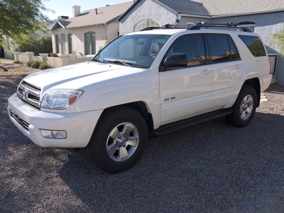

Sounds like the LTs fit your needs perfectly DD. Since I won't be towing anything and do mostly city/highway driving with a moderate off-road excursion a few times a month, I decided to go with the P265 Geos. Bought 'em at Discount Tire and walked 4 out the door for $710 installed with lifetime rotations/balancing. They're being installed on Saturday. I think they're a better match for what I'll be doing with my 4Runner and I'm saving $160. That should cover the fuel and beer bill for my trip to the North Rim of Grand Canyon on the 4th of July weekend. ;)
Thanks again for your input everyone. I appreciate it!
Got 'em installed last week:
