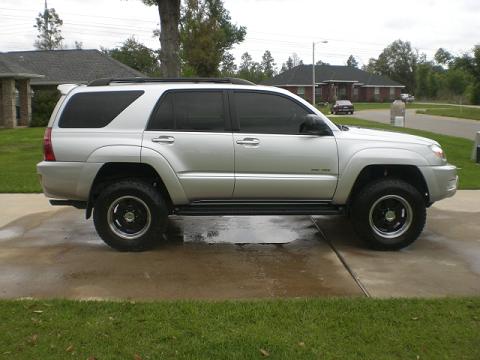

that's what I was trying to tell you. The 1.5 lines up very well also. this is a picture I took right after the install to point out how well it lined up. over to you obviously, just sharing what i found when I did my install.
DSCN0194.jpg~original
Yeah Thanks and I appreciate your thoughts and advice! And you got one sweet ride- that's a great pic and very inspiring! I love the look of those Coopers (bit too aggressive maybe for what I need since mine will be 70/30 street to off road) but I sure like the look. What other suspension mods do you have besides your BL?
