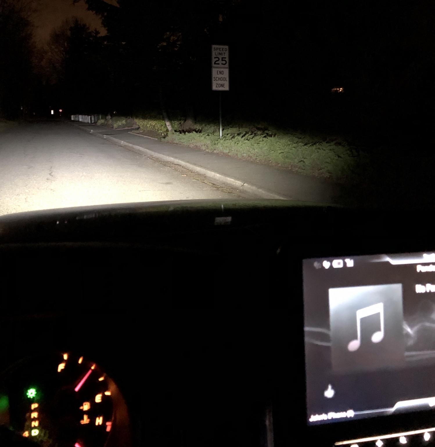

I'm gonna go ahead and order these. My headlights just don't do the trick when traveling through Ohio at night. Thanks.

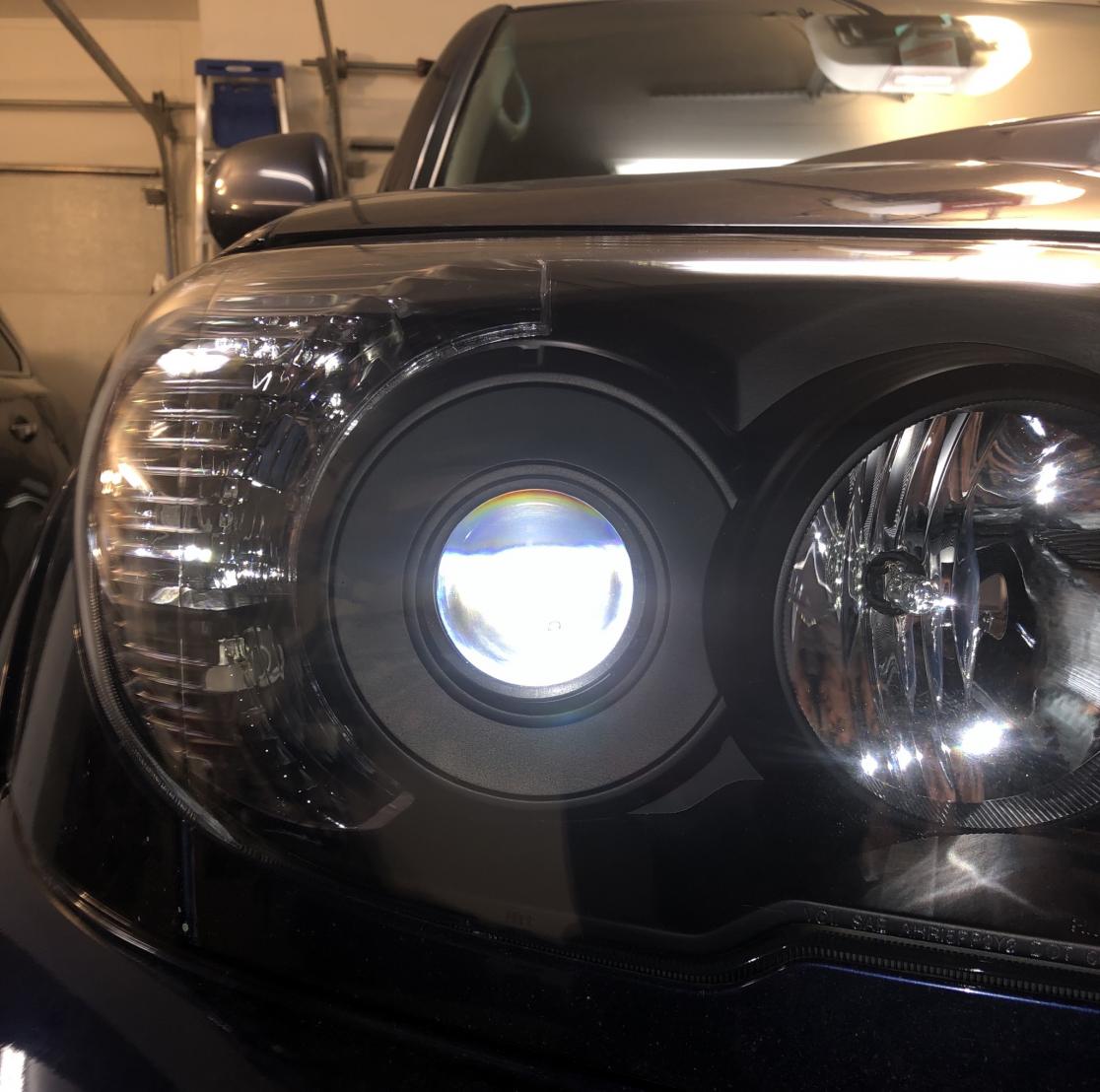

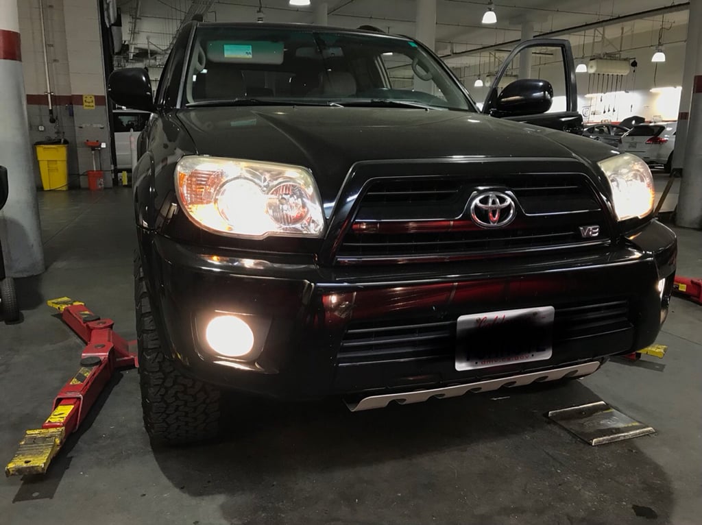

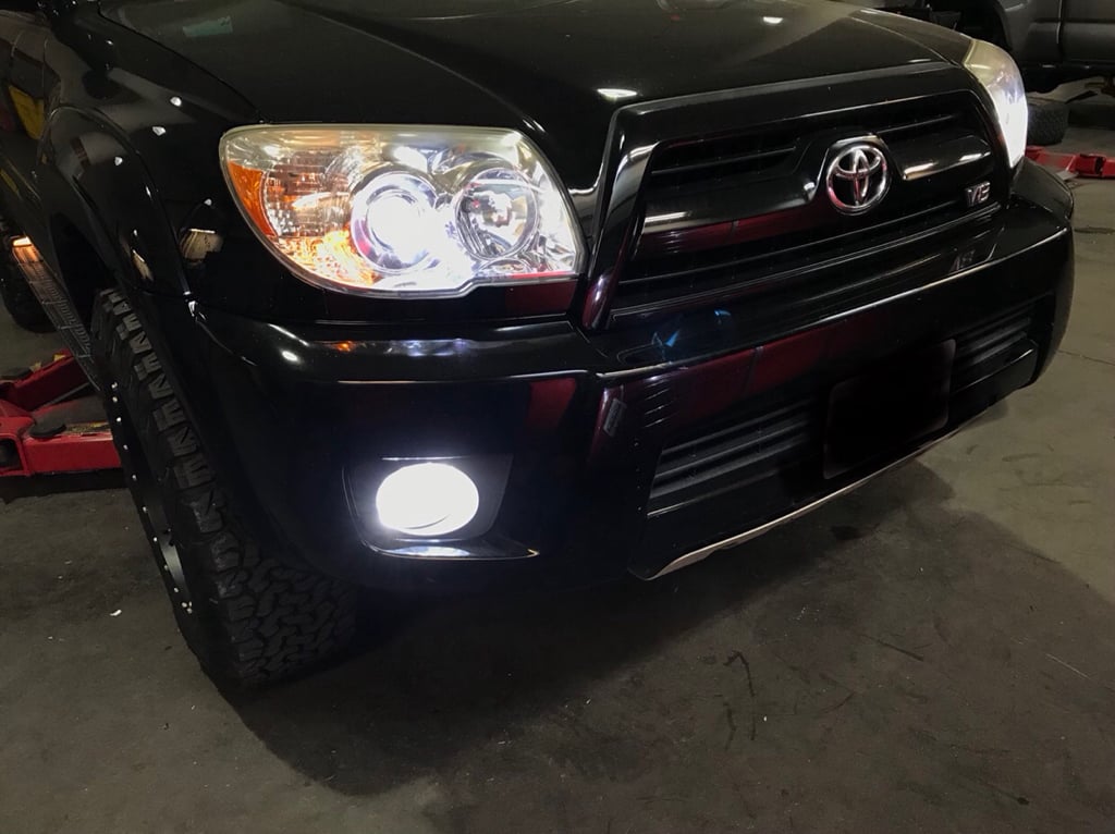

Here they are lit within DT Moto black 06-09 headlights. Paid a whopping $139 shipped for the headlights. Cheapest I could find - link below. Only issue is the turn signal bulbs don’t turn all the way. They go in and turn a few mm. Good enough to hold the bulb in place.
Also, stock headlights were a ***** to remove. There are four bolts total. One you will need to access through the fender liners... and it is not easy. I left that bolt off when I installed these lights.

I read a ton of reviews too, but most say they were very good about replacing them. The cooling fans seem to be something that’s complained about because of noise. I’m not concerned about that with headers, and TRD exhaust though. As far as them failing in a year, most of the expensive halogens only last that long anyway. That seems to be the trade off if you want better lights unfortunately. That, or dropping close to $1k for a real HID setup like the OP mentioned. Those bulbs aren’t exactly cheap when they fail either...

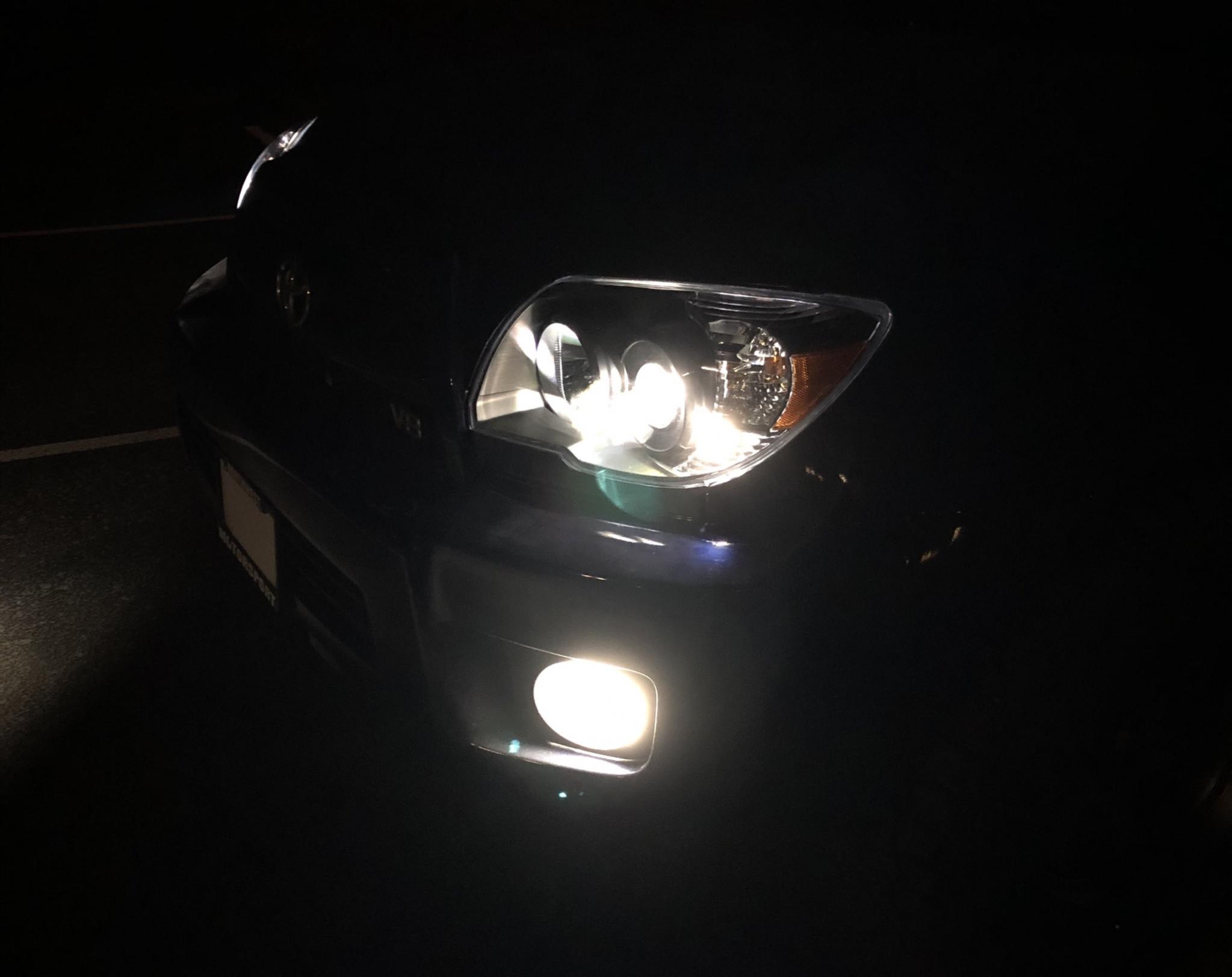

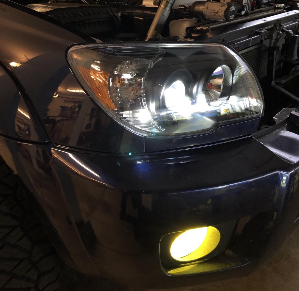

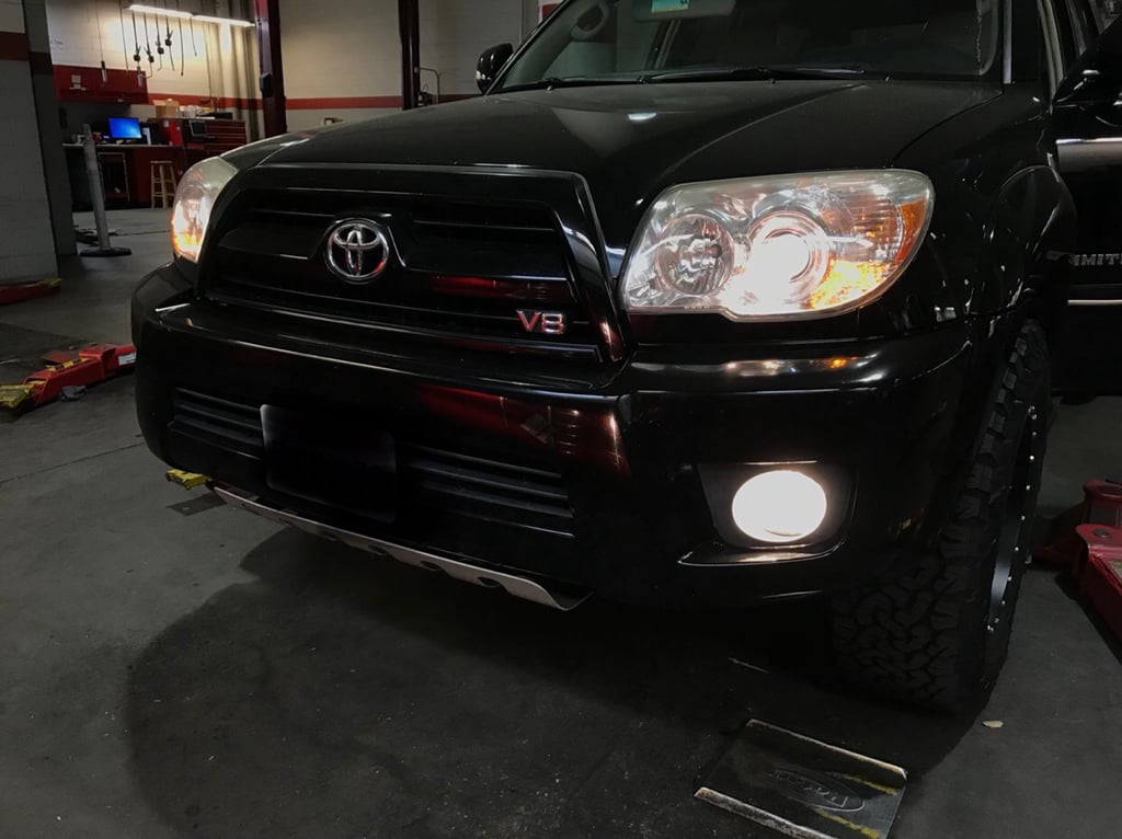

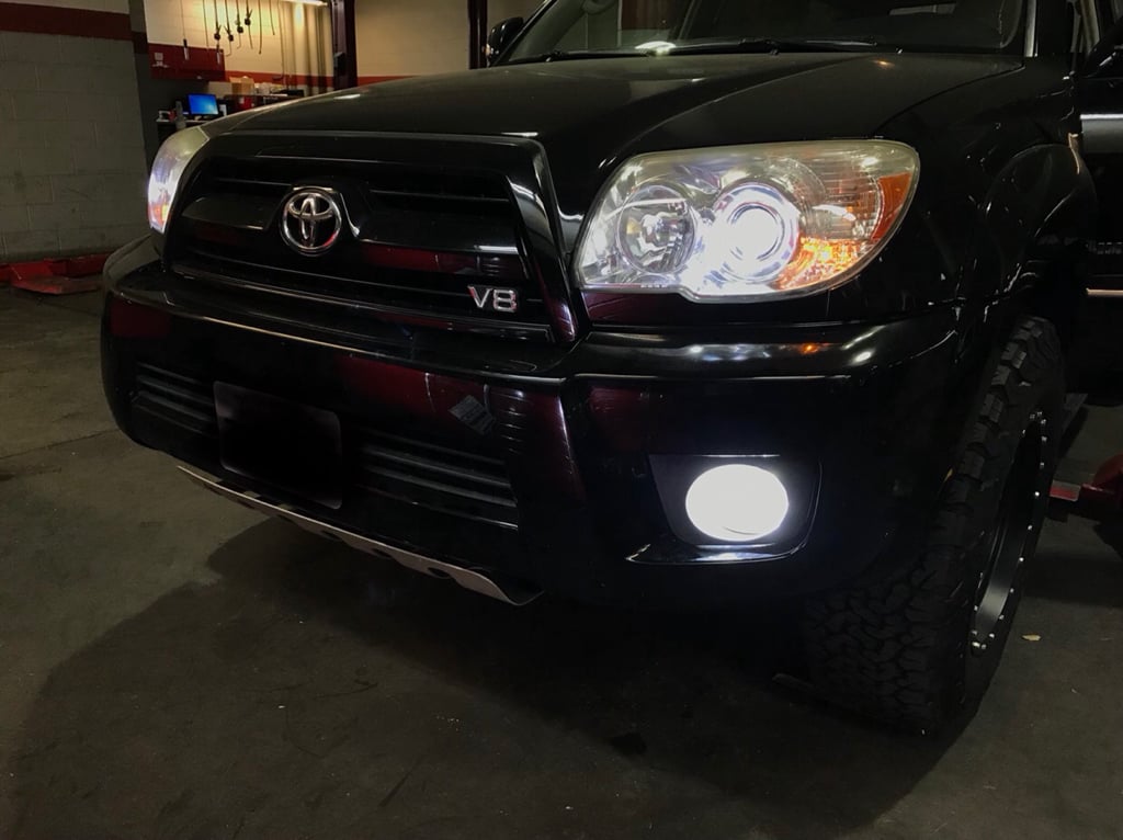

Auxbeam fogs. Quality bulbs and packaging again... but some difficulty getting the bulbs in place. Partially because my fog housings are coming apart. The other issue is the polarity on the plug is reversed. So when plugging in the connector, the lock clip sits on the backside. Not a big deal. It goes in.
I wanted more fog light output and I got a ridiculous amount of output due to the fact the housings are not projectors. Tons of scatter. Equivalent of high beams and will be used only under demanding conditions.

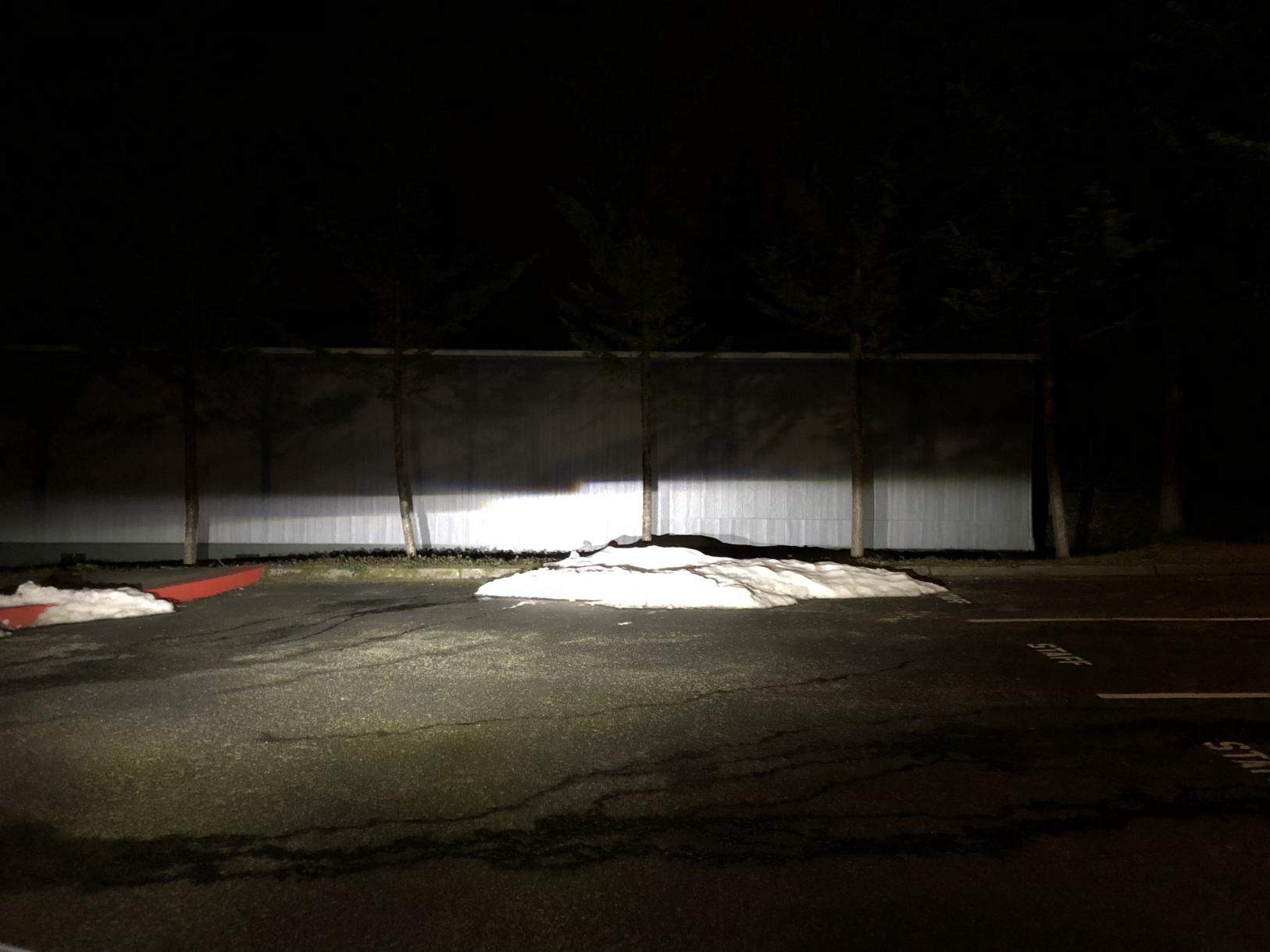

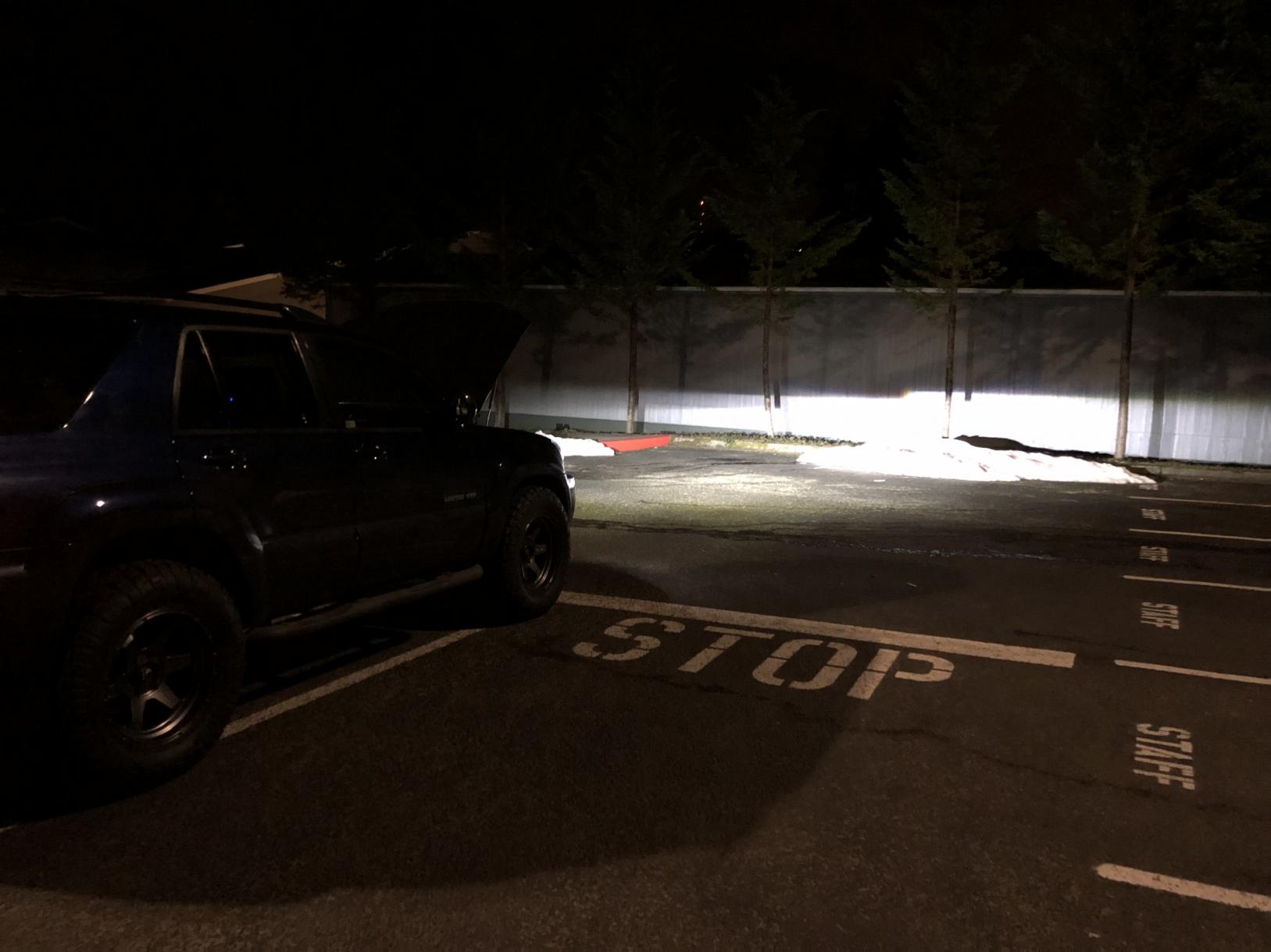

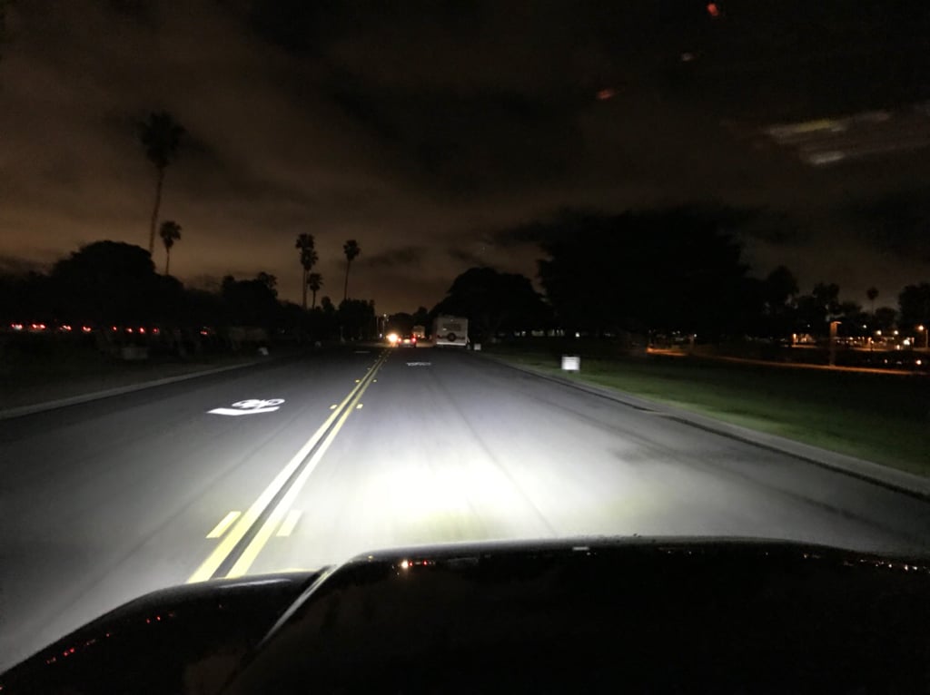

Additional output and cut off pics while aiming the headlights below.
man re-aim the lights, but it looks decent, should of just go back to the full retrofit way.

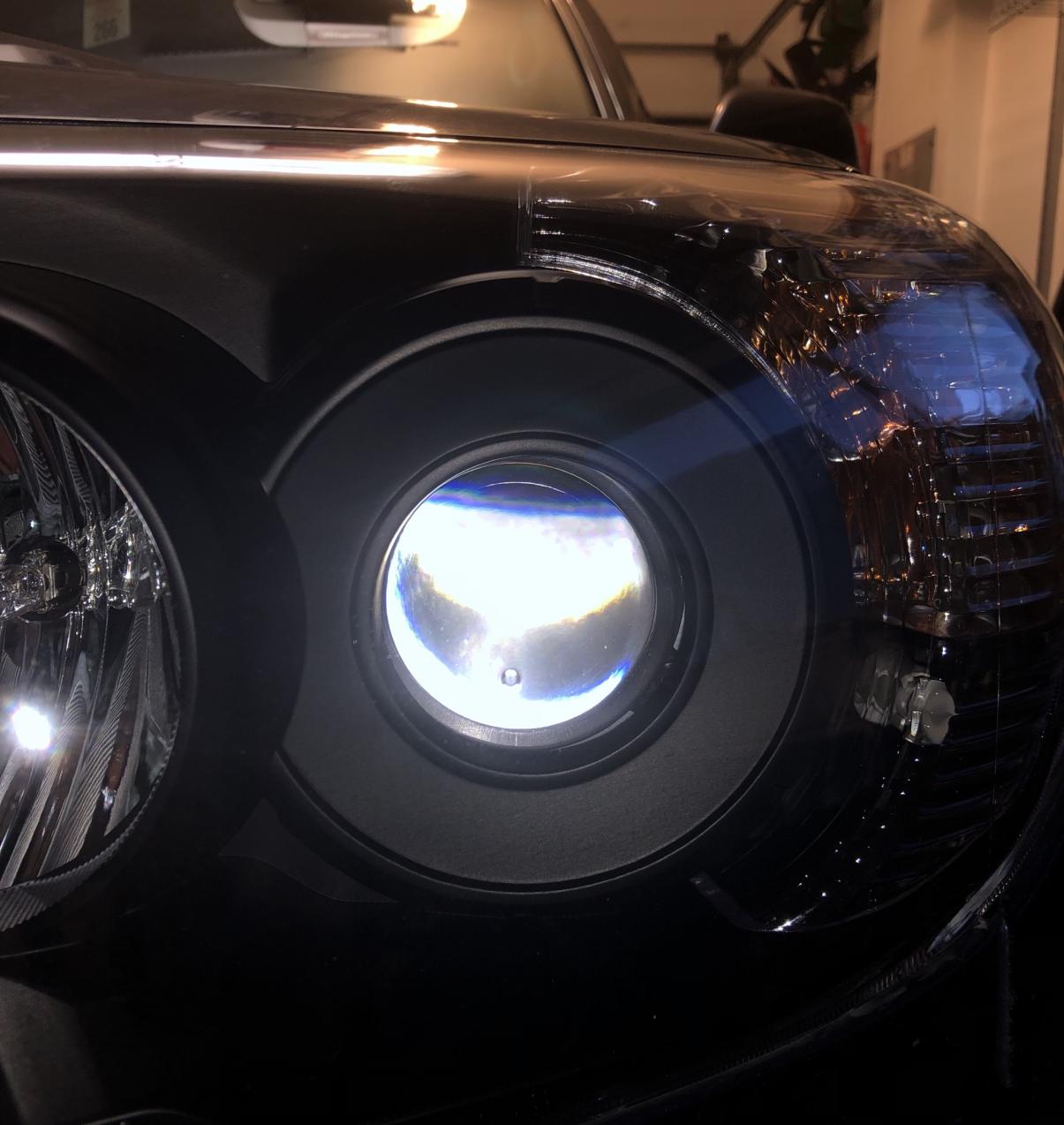

got a photo of the projector when off? just picked up some black headlights off amazon and they were not centered so i returning and looking for different brands for headlights
I will take these $29.99 bulbs over full retrofit 1k headlights any day! Lol
Hmm... You know you can adjust both vertical and horizontal adjustments right?
