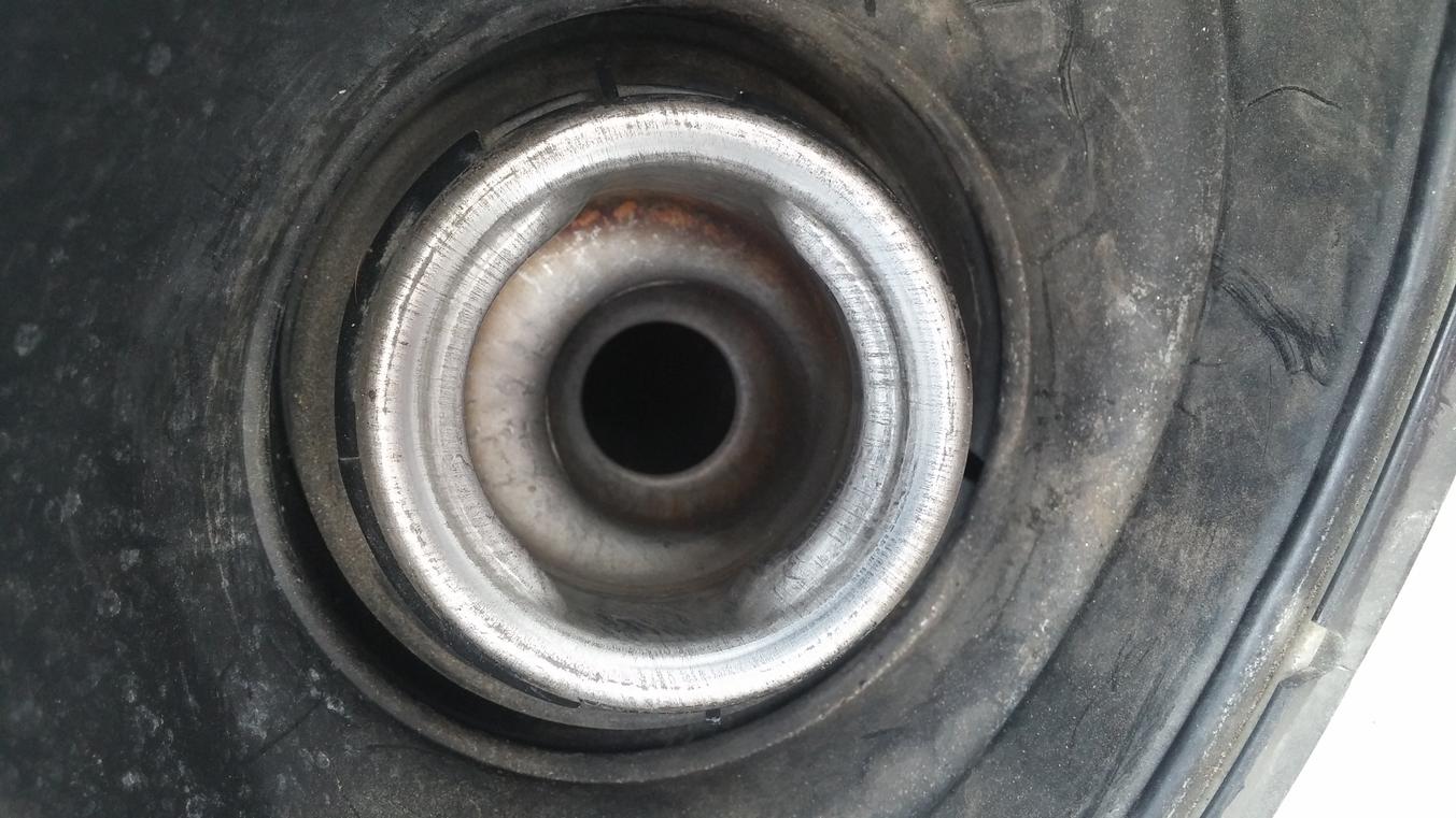

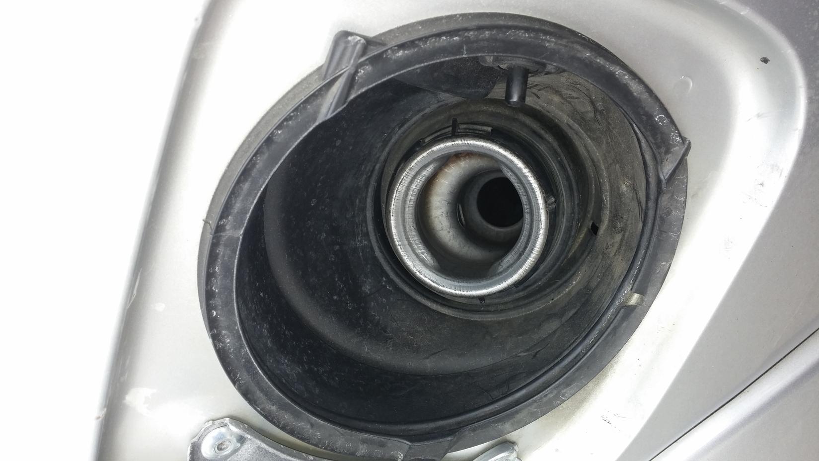

Can you get us a picture or two of the filler neck without the cap on? Also has the gas tank ever been out or the vehicle been in an accident?
Just had the code pulled. P0051. Sounds awfully familiar. Here are a couple pics of the gas opening. I'm not seeing anything weird. Maybe we are looking at a different problem here this time? Thoughts guys?
P0051 is "O2 Sensor Heater Circuit Low, Bank 2 Sensor 1". This isn't related to your gas cap, and the most likely reason replacing your cap fixed it before was because you also disconnected the battery at the same time, resetting the system. It then takes many drive cycles for the ECU to determine the O2 heater is faulty and illuminate the MIL. The fix for P0051 is to replace the O2 sensor, not the gas cap.
For your weak sealing gas cap, are you positive it's actually failing to seal? Nothing looks strange about your filler neck, and you've tried 3 different gas caps which all give the same "weak" feeling... maybe see how the stock gas cap feels on someone else's T4R?
