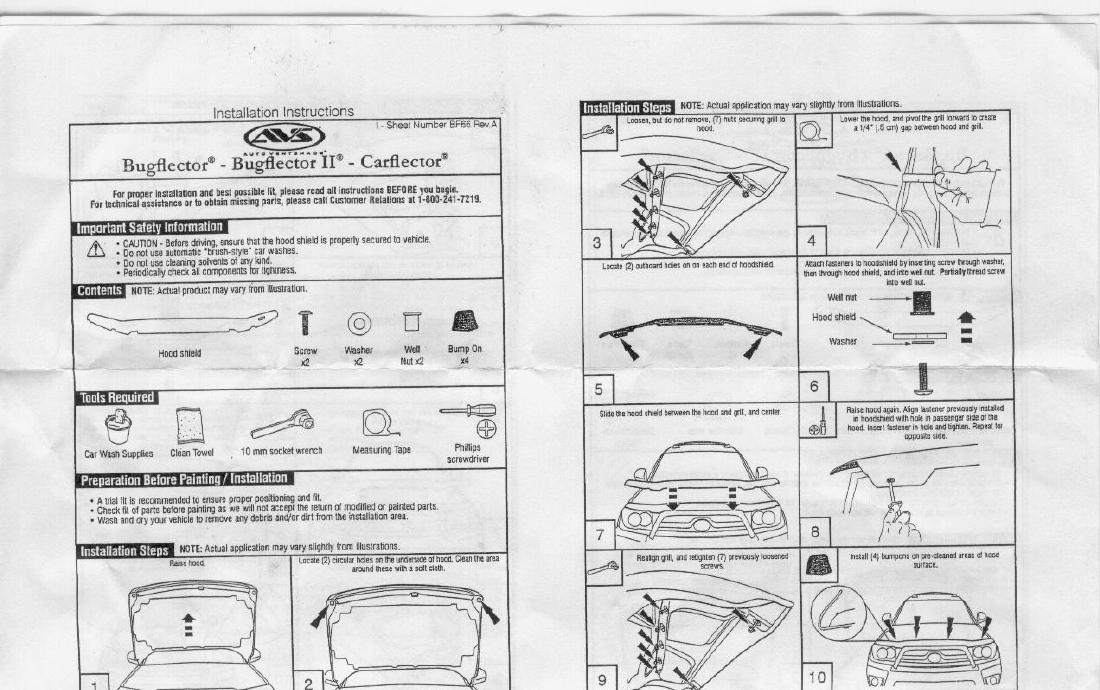

Here are the instructions

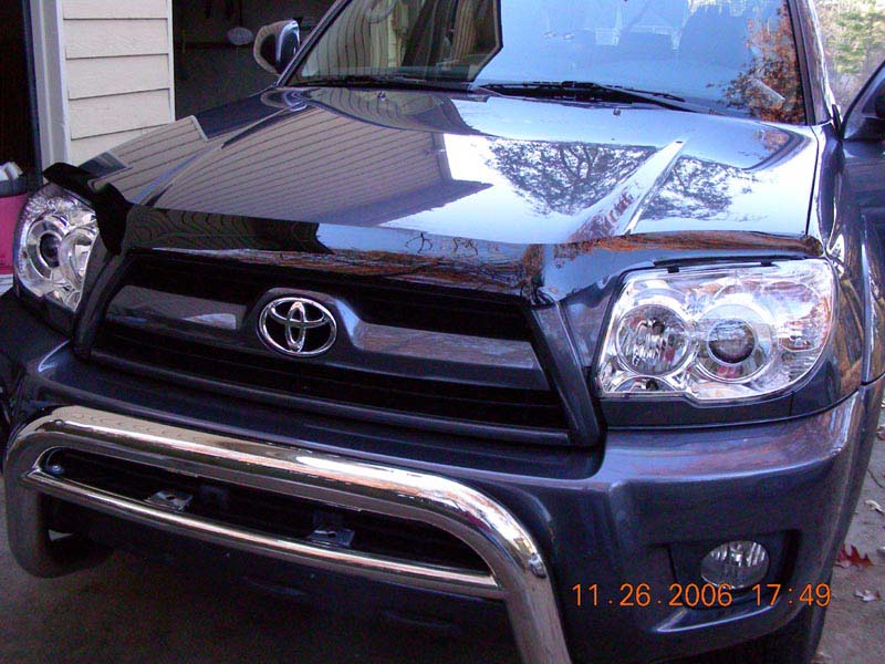

I put the Toyota bug shield on my truck this afternoon. The instructions are poorly written or I'm daft. Not sure which one, but I finally got the thing on. It's pretty easy once you figure out what goes where and which bracket is which.
One piece of advice. The instructions state to use a blanket over the engine to catch loose parts. Heed this advice. I lost one of the screws and had to go to home depot to find the replacement. I guess I'm lucky that's all I lost. :)
I've attached a pic of the installed bug shield.

Thanks for the information and the great photograph of the installed deflector. I assume there was no drilling required? How long did the installation take? (not counting the trip to Home Depot?) <grin>
Thanks for the great information.
Nope, no drilling required. Once I figured out where the brackets should be placed and which brackets to use it took less than 30 minutes from start to finish. Not bad at all.

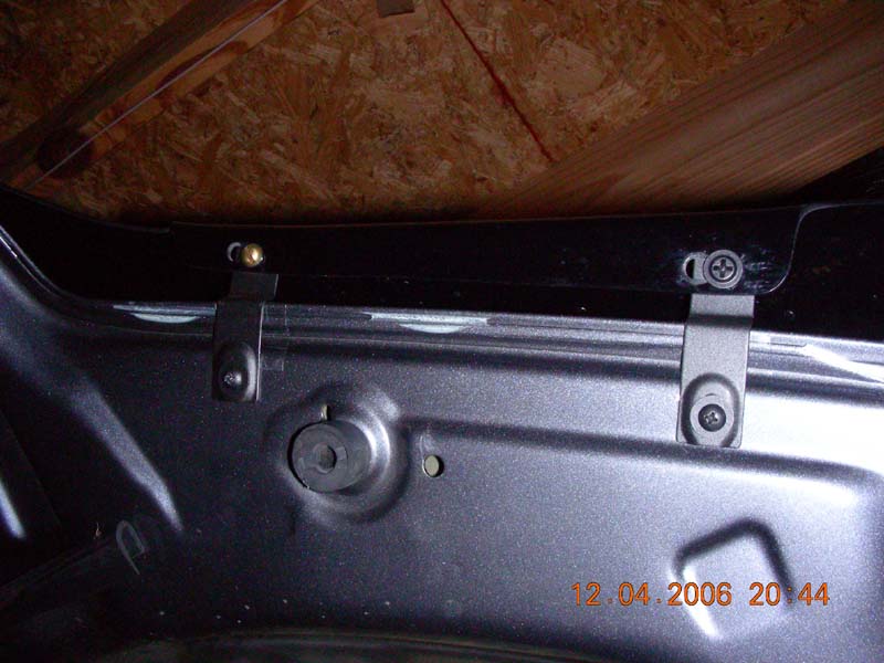

Here is the first pic of the brackets underneath the hood on the left and right side.

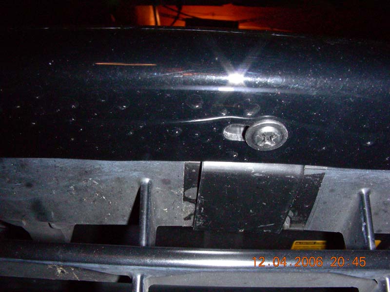

second pic - this is one of the two brackets in the center grill section.

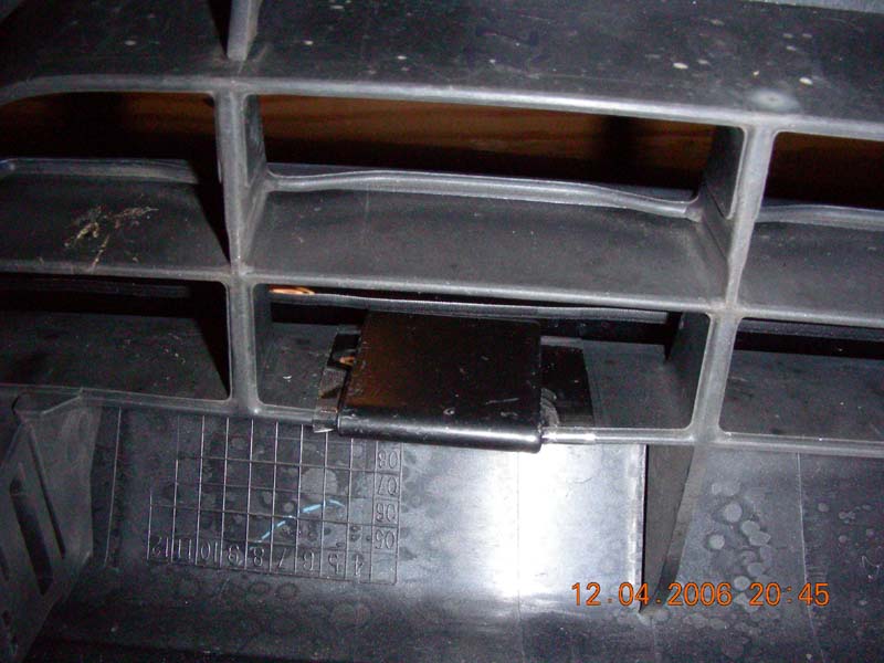

third pic of the center grill bracket. Hope this helps.
