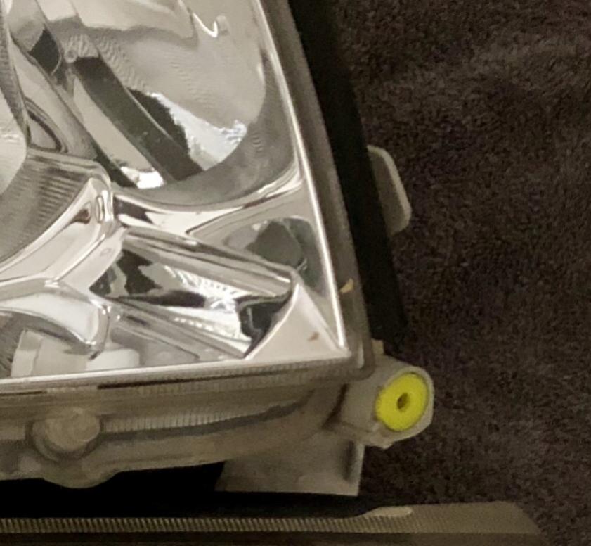

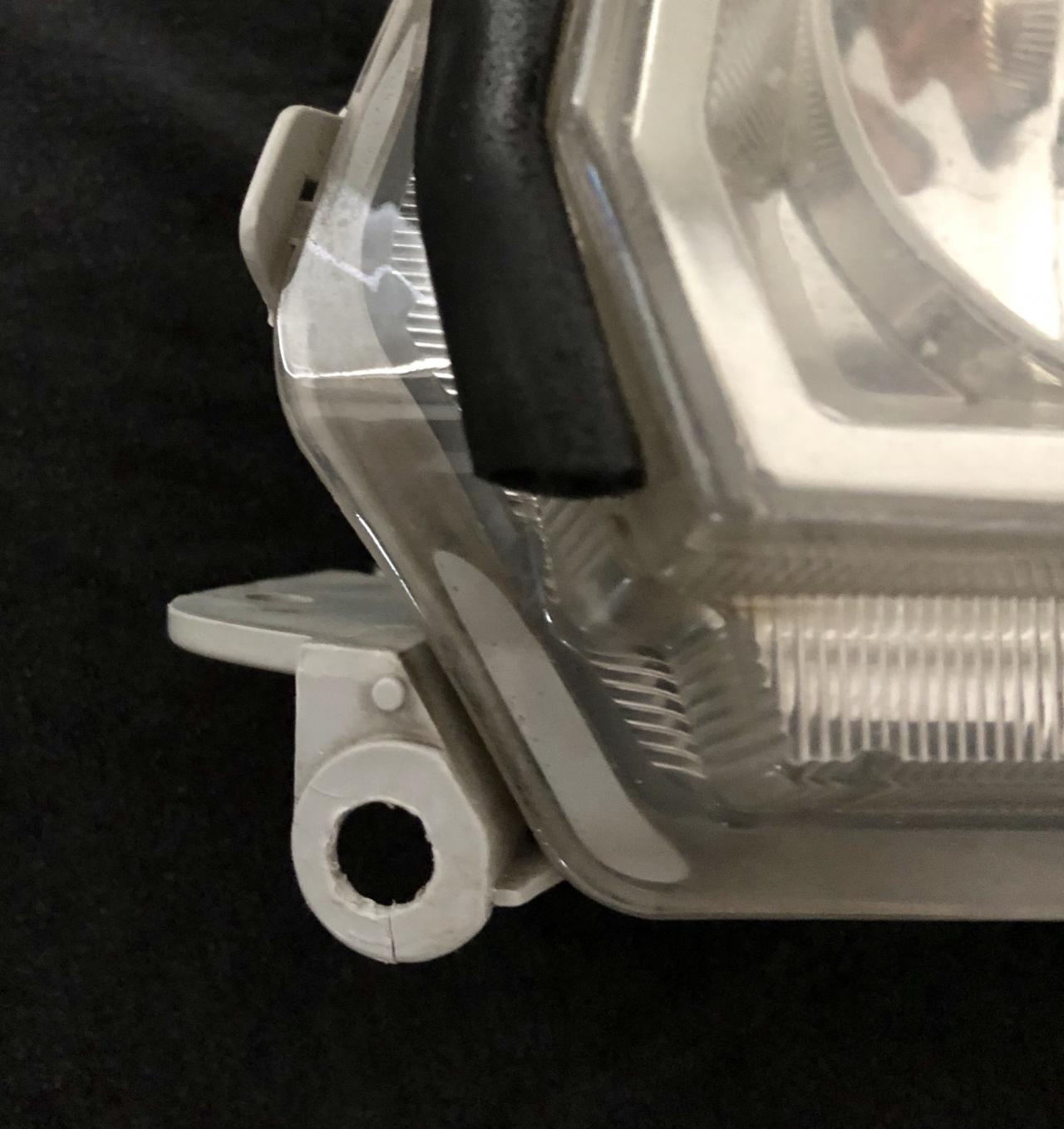

I am Doing the 06-09 Headlight Swap on my 03. Can someone Post pics of what the screw that holds the Filler piece Under the Headlight fastens to by the lower Grill and Bumper. The fasteners from the 03 Headlights Don't fit right. The 03 has a Yellow tab the screw goes into. Want to see if im missing something. Thanks

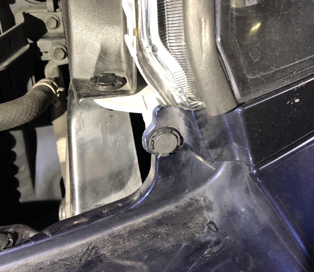

How is this set up for this corner?

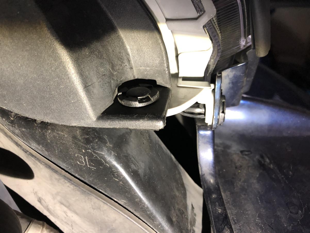

I don’t have a pic and I’m out of state right now, but the filler clips to the fender side, then is held with a plastic push pin like what holds the plastic cover over the radiator area. The only screws are for the headlights themselves. Hope that makes sense.
See pics. Panel clip holds it in place as stated by [MENTION=209958]Terminator03[/MENTION]
