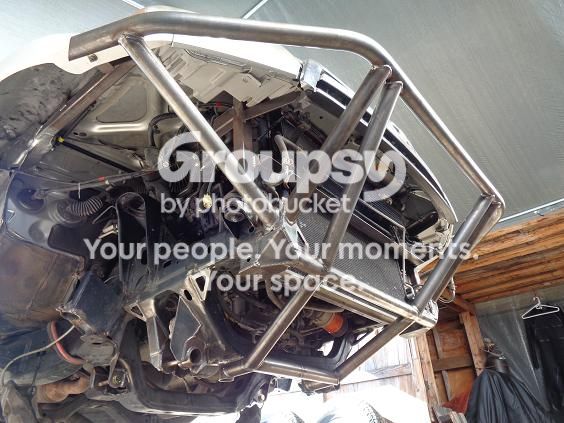

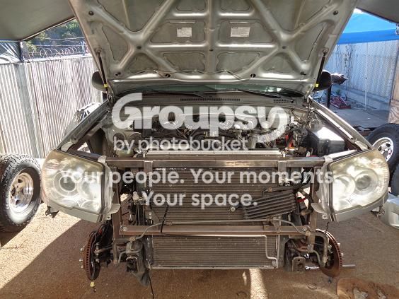

So I was having clearance issues with my tires and inner fenders so I cut them out and am finishing up a core support. I wanted more room in the engine bay for bigger shocks and an engine cage.

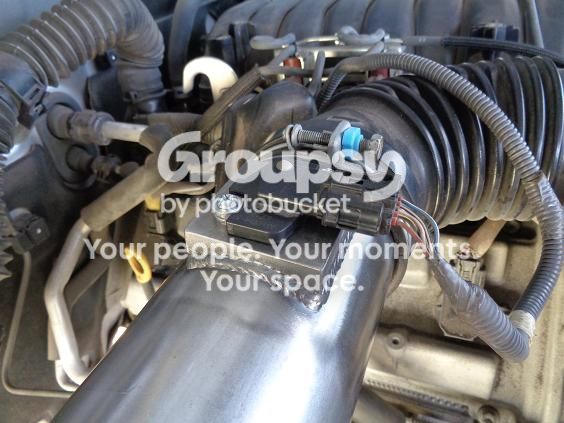

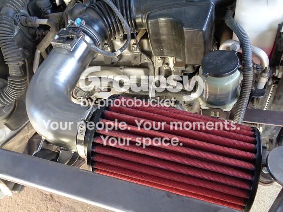

Well I sure tried to get an aftermarket intake shipped but it seems pretty locked down now to get an intake that isn't carb OE approved shipped to California so one of my friends machined me a block for the MAF sensor and I ordered a dry filter and some nice mandrel bent exhaust tubing and came up with this.
Seems like it will do the trick and gives me the room I need for shock hoops and an engine crossover brace.
I was going to suggest doing something like this, but now you're going to have issues with getting it smogged. I mean, there's always a "guy" but CARB and the BAR have been clamping down on that stuff pretty bad, not to mention I know in Southern California they have gotten themselves into the habit of doing road side smog checks.
All that aside, those are some beautiful TIG welds and that's a very professional looking set-up. :)
Thanks, Yeah I'm going to paint it all black and build a shroud/box around the air filter and I think it won't be so noticeable, I can still put the oem box in for smog, main clearance issue was for an engine cross brace from shock hoop to shock hoop which will be removable when I need room.
