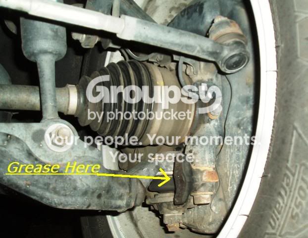

Nevermind my stupidity. I climbed underneath and located all 6 with my own eyes. Either these people are stupid or they thought I meant a chassis lube. :bash:
I just did the task. EZ to perform but a PITA without a lift.
The Mobile1 grease being pink makes it EZ to locate excess and
to see if the seals are bulging with grease.
Slowly squeeze the grease gun to minimze excess bulging.

Just for reference, I have an 08 V6 4WD. I seem to be blind, dense, or maybe both. I'm only finding 3 zerks total: 2 in the front and one in the back. Where are the other 3 zerks?

GreaseHere.jpg~original
