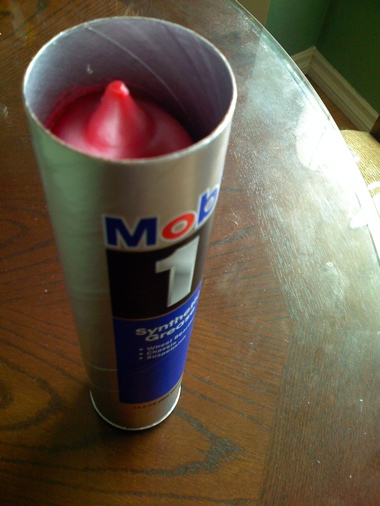

You're looking for a lithium-based grease, grade NLGI-2. I've seen the moly as well, but since a lot of people here swear by Mobil 1, I went with that instead. I saw some really cheap no-name lithium grease at the auto parts store that said it was "compatible with NLGI-2", but didn't say it actually met the specs.

are all M1 grease the same? color coded?

I've only seen the one and in terms of specifications from what I've read, the separate grease types has been dropped from the more recent manuals.

I dont know how much is left on my grease gun, can i just leave the grease gun as it is or do i have to take the tube out?
I left it as is and it worked just fine the second time. I don't think all that much grease is used each time. Should last a while.
