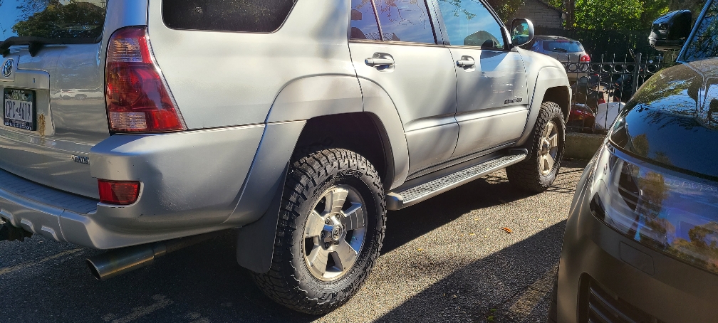

Whatever you end up doing, don’t reuse the stock springs. I used new Toytec (made by Eibach?) springs front and rear with 5100’s in my ’04. I think the advertised 3”/2” f/r lift was >4”/>3” on my 4R with the new springs due to the stock springs being so old and soft.
The pic of my 4R in my signature line includes not only the new shocks and springs, but also a 1” Toytec body lift and 33” tires.
