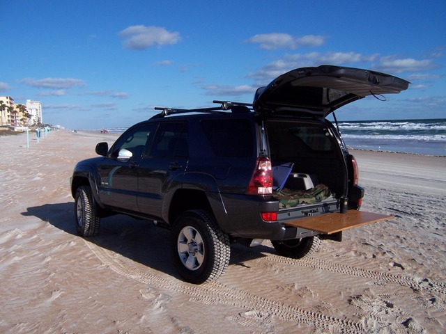

I only go to the beach a few x a year. No other reason other than Toyota for this to happen.

Do you think driving in saltwater and sand on the ocean beaches of Daytona Florida had any connection with the caliper problem?
