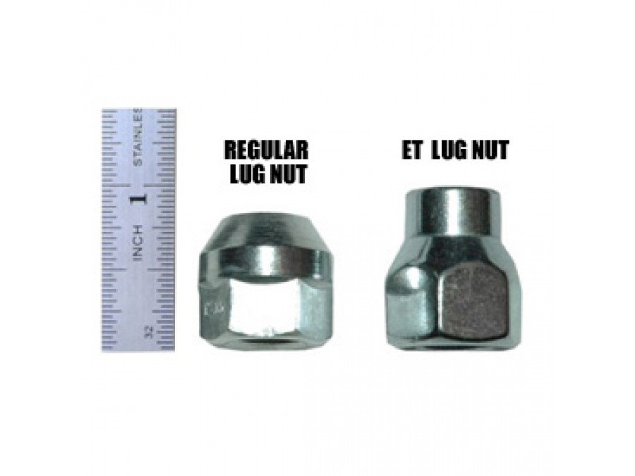

You need these (or similar). They have a collar that threads into the spacer. Been running these for 4 years without an issue.

ET style lugs wont fit spidertrax.
