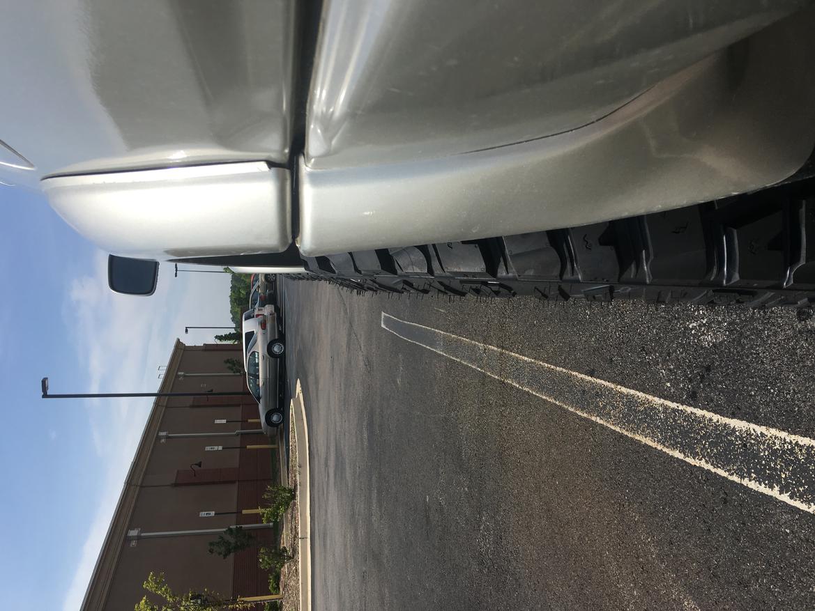

Can anyone post more pics of 1.25 on a 3rd gen with limited flares? Just need to see an angle like this
