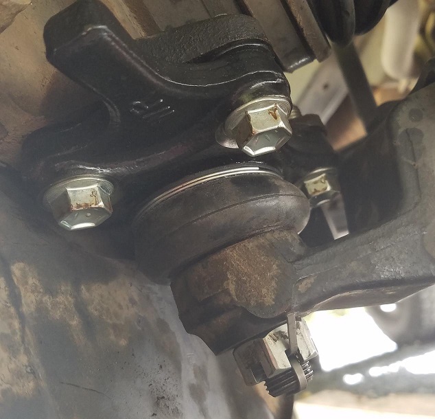

10 minutes into the LBJ job and this happens...
This where an impact wrench comes in handy. It doesnt shear the bolts like just torqueing with a breaker bar.
The problem is that it's hard to get an impact wrench under that with regular jack and stands. I could not and had to trust my penetrating oil.
I bought an impact wrench specifically for this, but the bolts weren't budging. That's when I switched to a breaker bar. It lived up to its name. :p
Can of coke works just as good believe it or not.

With all the good information in here I might revisit this. I had already dropped more than 200 bucks into tools for this job though so I can't imagine a shop costing much more than that for labor. I'll ask around.
Raise the jack up a bit with a couple nice 2x10s and of course secure it with stands. Worked great for me! :cowboy:
I am giving this another shot this weekend. I purchased some Kroil and will try the ATF + Acetone mix as well. I went back to Home Depot and bought another impact wrench. It was actually cheaper this time. Lol.
I finally got this done. I was still unable to get the broken bolt out so I'm taking it to a shop next week but at least everything else is done.
A can of Kroil made this a sinch. I was quite impressed by it so thanks for recommending that.

A 'live and learn' thing, I guess, but always use penetrating oil for a few days (preferably weeks) in advance on any bolt you plan on loosening, regardless of where you live.
Obviously, the stronger stuff will work better in a 'quick pinch' situation, but WD-40/PB-Blaster, etc work fine if you give them a few days with multiple applications.
I live in rust free Texas, but 3 applications of PB-Blaster during the week leading up to the jobs, I was able to remove my stock LBJ and Upper Rear Shock bolts so easily I thought at first that they were either not torqued down AT ALL, or they were already stripped.
Made the jobs extremely easy, and there are multiple threads solely on how to remove the shock bolts because they are supposed to be so hard.
I'm cheap so I use WD40 a week before & then the night before. All 8 bolts came out easily with an impact & I live in the rust belt. My LBJ's had 153,000 when I changed them.

IMO my first mistake was trying to use a breaker bar on it. Only half the bolt is actually threaded into the mount. The other half just passes through the LBJ.
