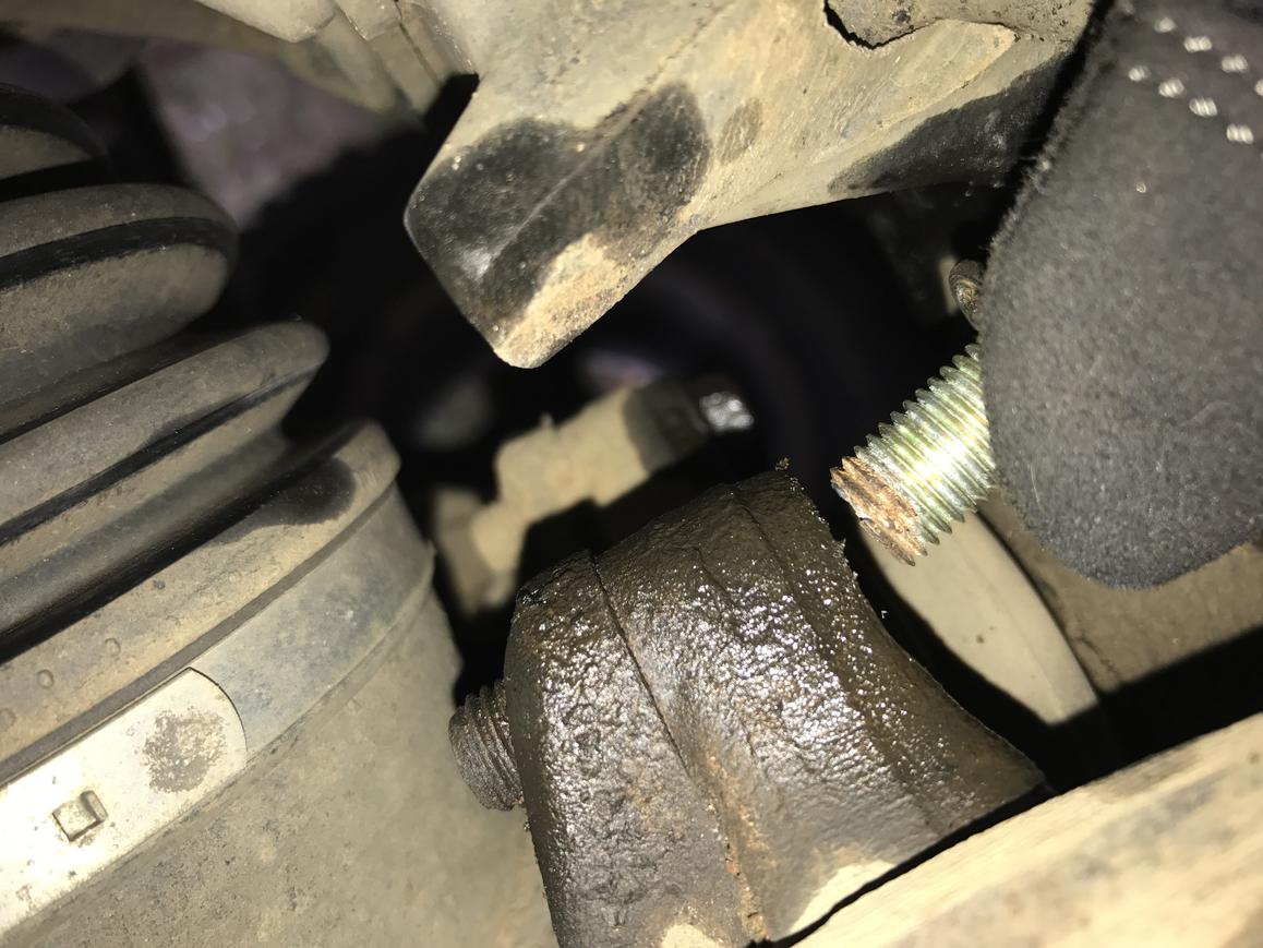

10 minutes into the LBJ job and this happens...

Yeah, I'm done. Lol. To the shop it goes.

At the very least, if you use a normal direction drill bit, it might push the rest of the way through :)
Get an Erwin wise grip on to the threads stuck on the spindle and turn it as you were tightening it. It should come out.
This is why you need to clean the threads with a wire brush before the removal.
I should have let them soak longer too. It was only overnight. Oh well. It went from an LBJ day to a spark plug day. Lol. I'm sure I could get it out but honestly I went in expecting I might have to take it to a shop so no worries. :)
+1
The crap & rust on the threads sticking out is what bound up the bolt in the spindle causing it to snap. If you grip the part sticking out of the spindle, and spin it the opposite way, you'll only encounter the nice clean threads that are in the spindle. Should come right out... in theory.
With some oxy/ace it will come right out.
For freeing up any rusted bolts nothing beats Kroil IMHO. Soak them a couple of days and then with an impact, not a ratchet or wrench, try to get them out.
https://www.amazon.com/Kano-Aerokroil-Penetrating-aerosol-AEROKROIL/dp/B005XUIX24?th=1
Try 50/50 ATF/acetone mixture. Scientifically proven the best bolt penetrate.
Quote from machinist magazine
Penetrating oils ........... Average torque load to loosen
No Oil used ................... 516 pounds
WD-40 ..................... ... 238 pounds
PB Blaster .................... 214 pounds
Liquid Wrench ...............127 pounds
Kano Kroil .................... 106 pounds
ATF*-Acetone mix............53 pounds""
It literally works like magic.
I'm going to mix some up and try this stuff. Worse case I don't like it, best case it works. I use 50/50 Kroil/GM Top Engine Cleaner for a firearm cleaning solvent. Works better than 90% of them for a fraction of the cost.
Interesting. I heard that Acetone/ATF doesn't mix well or stay mixed.
I used to use PB blaster and still broke bolts and switched to kroil years back and have yet to break a bolt on either of my jeeps or this 4runner. It loosens everything even seized on u-joint c-clips.
I feel bad for you OP. I just did my LBJ's and my bolts came out just fine and they were pretty rusty.
This where an impact wrench comes in handy. It doesnt shear the bolts like just torqueing with a breaker bar.
