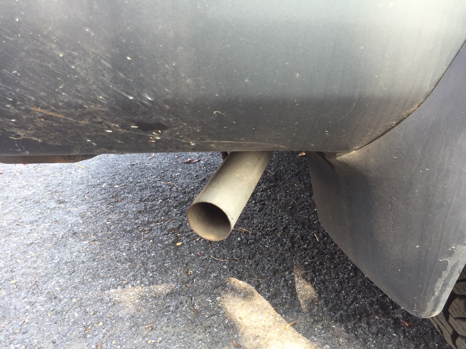

I agree on the newer fuel management. My tail pipe is still light brown inside and it's 5 years old and has at least 10,000. Heck it isn't really rusting yet either.
