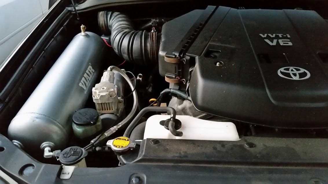

I have a Viair 450c system mounted under the hood. Had the same system in my Jeep for awhile and worked great airing up 35's. I used to use CO2 but didn't like having to get the bottle filled. Also didn't like the idea of carting around a compressed gas cylinder in the interior of my vehicle. Much prefer the Viair setup.

Nice setup... id love to have a tank but space is at a premium these days.
I would put it in the same area but its currently home to "a bunch of other stuff"
How did you mount the tank and compressor? Did you have to move anything.
The only thing I had to move was the air intake tube. I removed the molded plastic piece on the end of the tube and then rotated the tube 180 degrees placing the inlet near the firewall. I used a couple of existing bolts as well as drilling 3 new ones to mount the tank and pump. I did have to do a bit of fabrication to get the tank to fit uner the hood. I don't think it would work as supplied from Viair. I had already shortened the tank mounts because I used to have it mounted under my Wrangler and didn't want it to hang down below the frame. I also made a small bracket to extend the tank mount near the power steering reservoir. I have a hose chuck mounted on each side under hood so I can easily reach my tires or if I need to share with others.
