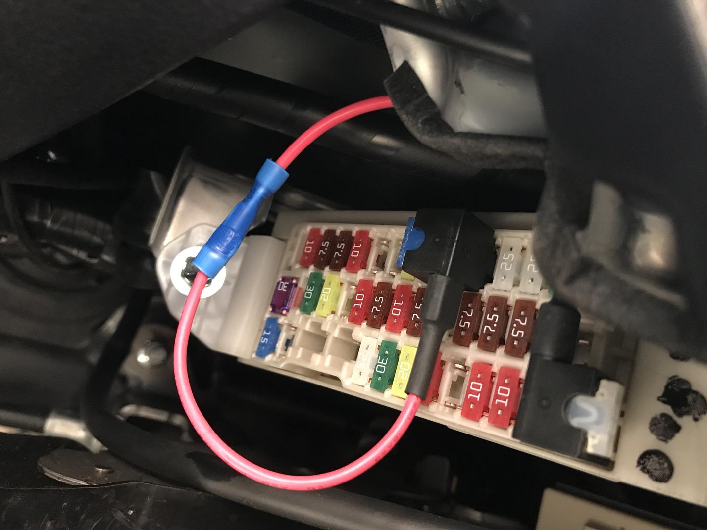

Ive done the jumper from the hot curcuit thats open to my p/outlet fuse but my radio comes on when the jumper is installed. Anyone experienced this?
You might want to take a well lit photo of how you put that in, and post it here for the best help.
If you want 12v anytime why not just run a fused link straight from the battery? Creating your own subsystem is way safer than messing with such a fragile "e"cosystem that the 4Runner has. IMO
Search around and see what happens when a rodent bites into a harness, let alone you picking a fuse to add-a-fuse to that fries one of some odd 30 f'n ECU's in the truck
so i think my troubles are related to the fuse depth.
using the same kind of short bladed fuse adapter yields the results im looking for.
oddly enough, a long bladed fuse adapter in the same spots on the fuse block turns the radio on as well.
all is well and i learned a little something.
