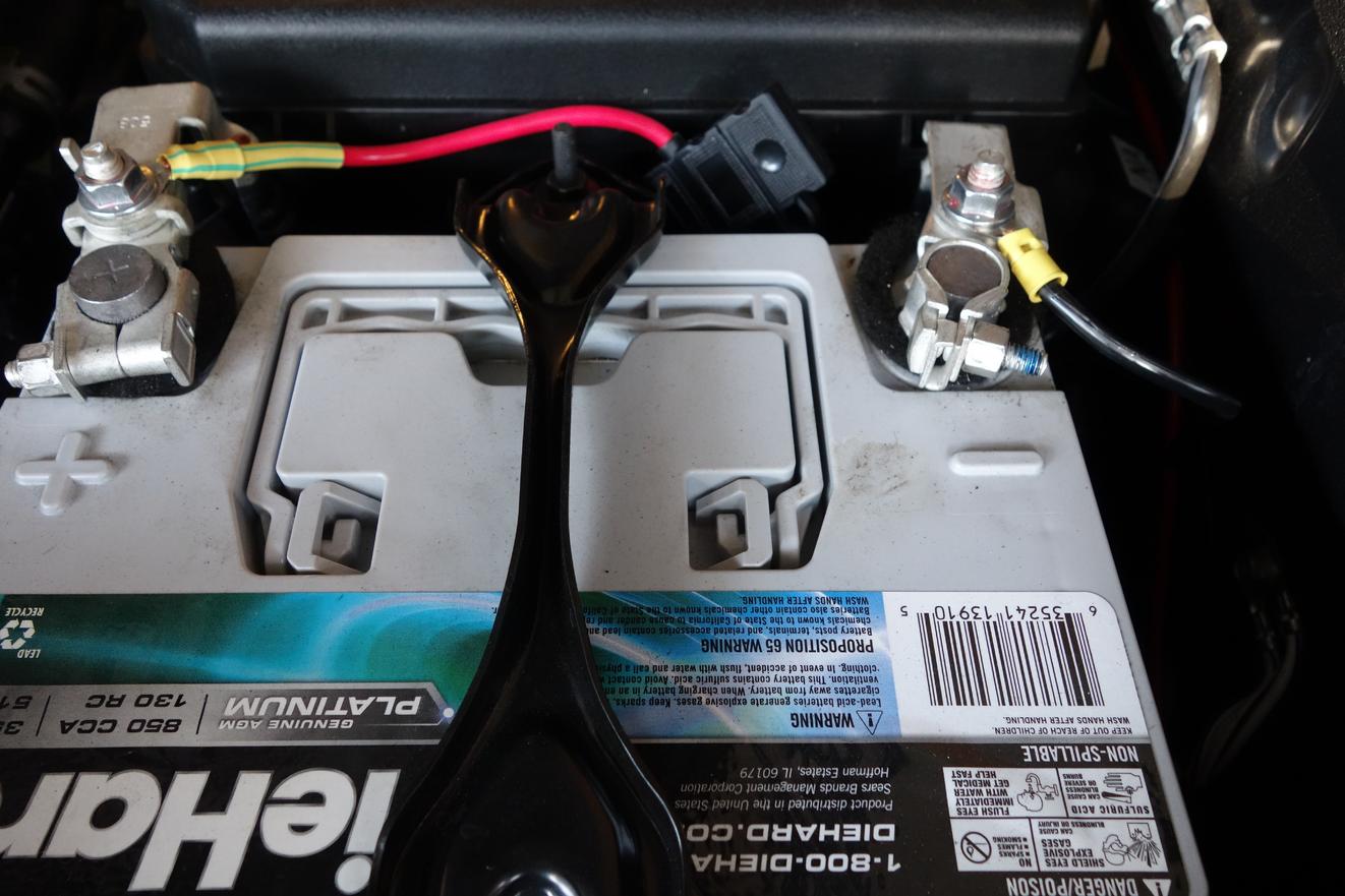

Positive (Red) to positive terminal on battery. In-line blade fuse holder with 15A fuse. Black to ground terminal. None of this was connected until the wire was run, obviously :)

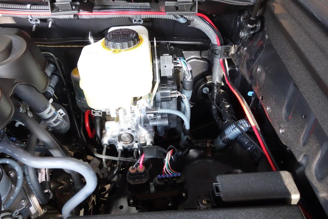

Route neatly around perimeter of engine compartment/firewall zip-tying along the way.

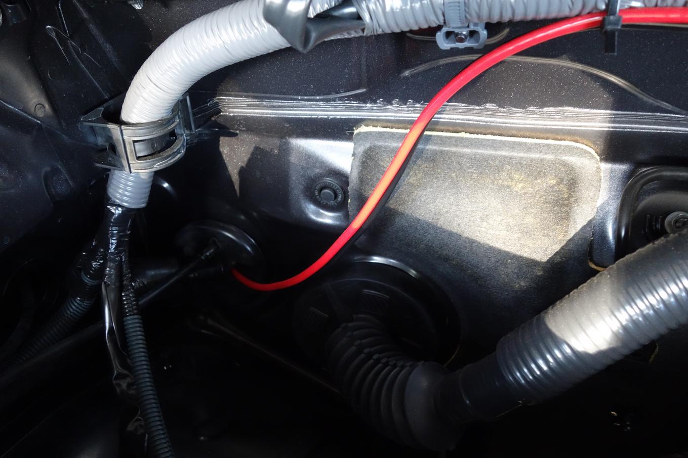

Make a neat hole through the rubber grommet in firewall. Start fishing wire through into cab.

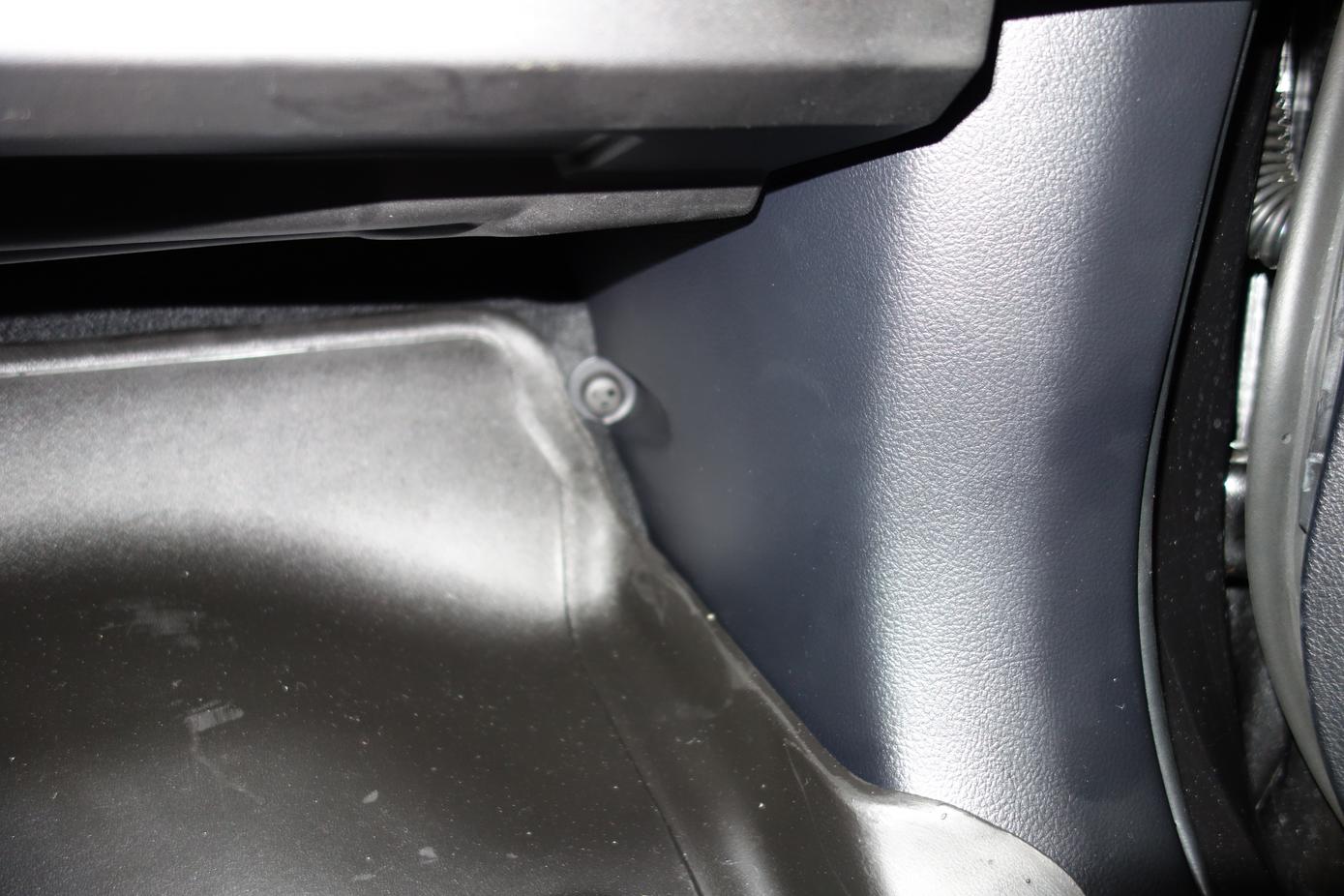

Remove kick panel on passenger side. (Plastic screw enables the panel to pull back and out)

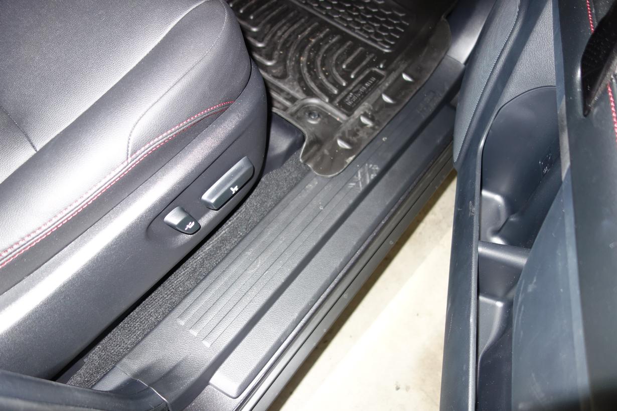

Pull door jam protector up. It is snapped in, but pull up evenly along the length. Comes out pretty easy. Do this at both passenger side doors. Fish the cable along through the wire runs.

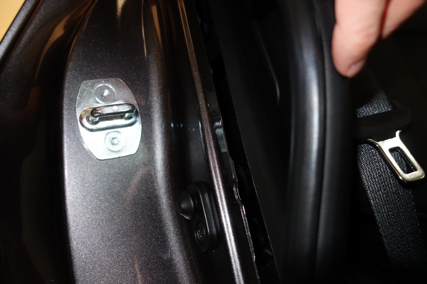

With the rear passenger door open you can peel the weatherstrip back between the side of the seat and the cab itself. That enables you to fish the wire through without removing any interior body panels or the seats. I used a coat hanger to help fish it through. Make sure there is nothing that will pinch the wire. There is plenty of room in there and not much in the way of sharp edges, but just be sure.

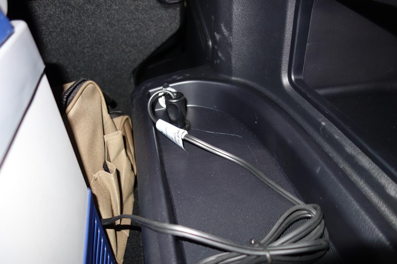

In the cargo area I popped out the little tray on top of the wheel well. It took some struggling as it is in there with these little tabs that may flex and break, but that may have been my fault for getting a tad too aggressive with it. It still snapped back no problem. You will see the inverter bolted to the wheel well. Stay clear of it with the wiring. I drilled a hole in the tray itself making sure the cable and cigarette plug had enough space when the tray was put back.
Crimp and heat-shrinked all hot connections. Done.

Running a ground wire directly to the battery isn't necessary for a 12V outlet, nor is it the best idea. The ground wire should be as short as possible and come directly from the new outlet and connect to a solid metal surface. There are plenty of factory grounds already located in the cargo area that can be utilized.
The power wire and fuse should go directly to the battery like you've shown (although it needs to be protected from chafing with some split-loom).
