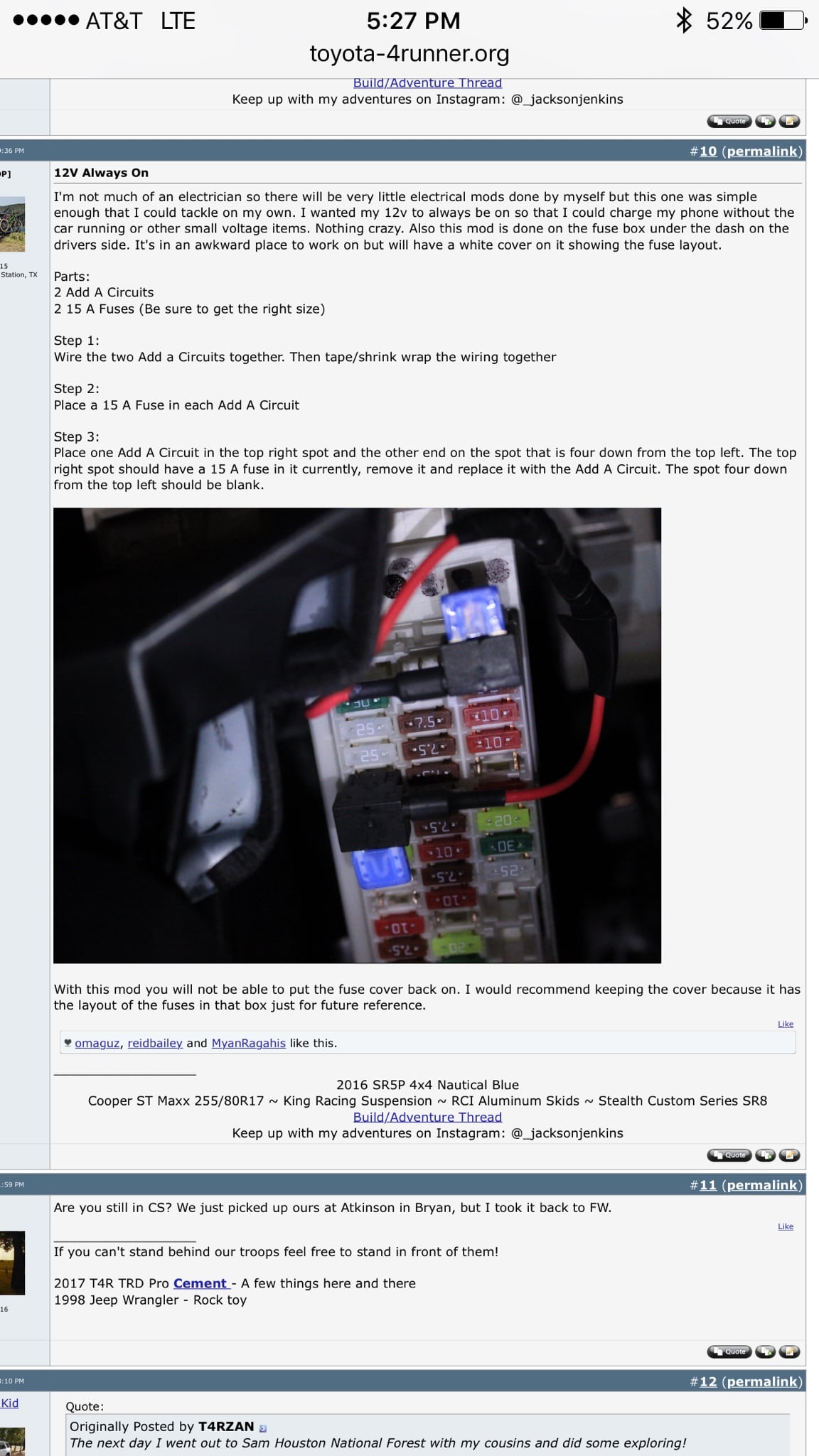

I used 2 add a circuit to jump a constant on fuse to the switched 12v plugs.. searching for pics an will post if i find them

Thank you for this tip. It worked out perfectly without any added wiring.
One piece of advise is it seems its polarity specific so be sure to plug the add a circuit in the exact orientation as the picture, also put the fuse in the same socket closest to the wire. I did it the wrong way and it kept my radio on instead of the 12v sockets. Hope this helps anyone that runs into this issue
i tried to do this over the weekend however my radio and 12 volt socket is on. I thought I had the polarity incorrect so I flipped it in all sort of combination but only was able to get the radio and 12 volt on or else it was off. I just want the 12 volt socket under the radio on. Am I doing it wrong :(

i got 2 "add a circuit" and splice it together. I took out the 15 amp in the top right spot, put it in one of the add a circuit. plug it back in. The 2nd end of the add a circuit I place it in the empty slot (4th down on the left). When I put it in initially nothing turn on so I reversed it and it came on but both radio and 12 volt socket.
I'll re-check my work later and use a meter to check. thanks.
if an add a fuse is in backwards the tap isn't fuse protected, are you sure your fuse wasn't blown and that's why you only got power one way but not the other?
I just plugged it in exactly like the picture. I want to warn that it killed my battery. I have an 8inch tablet plugged in powered with a camera app on always and it killed my battery.
