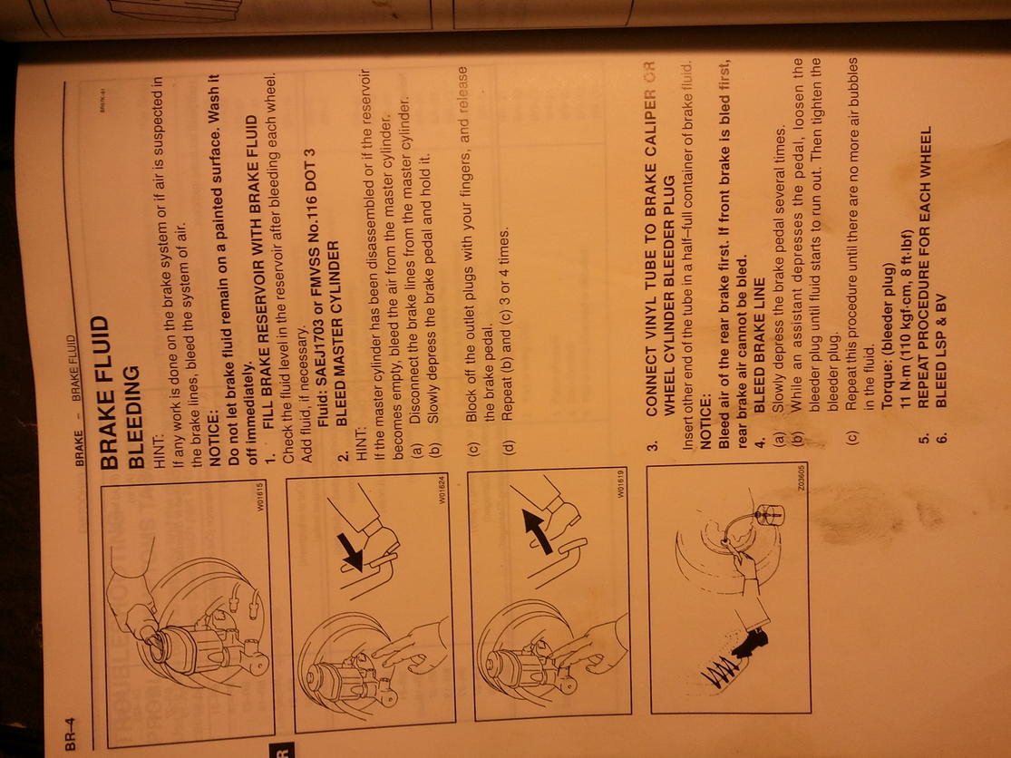

Any chance you let the MC go dry while bleeding? If so, there is a procedure for bleeding the MC on the truck, then you need to rebleed the brakes themselves. This happened to me the first time. I didn't realize the MC reservoir had two compartments and either can go dry and let air in.
Post back if you want the procedure; it's in my '99 paper FSM, but does not apply to the later models with VSC etc. so not in the on-line FSM.

Thedurk: That would be awesome if you could get the procedure from the FSM to me! I think i need to bleed the MC and rebleed everything else per the factory procedure...
Bump...going to do the bleeding again in a couple hours...anyone with access to the FSM bleed procedure for pre complicated ABS?
Here you go:
Thanks Durk! That's the same procedure that's in all data that I have. Pedal feels better, but still drops down far when running...
