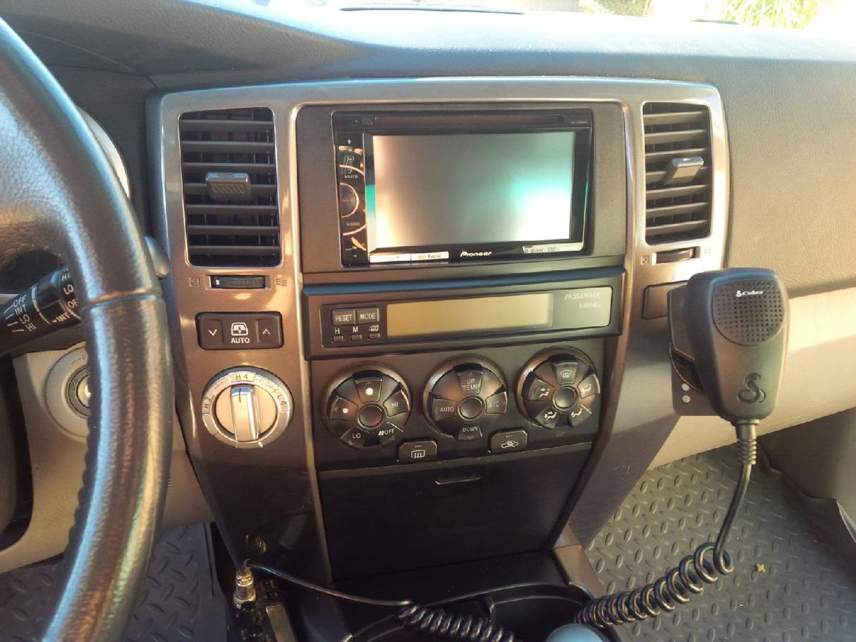

I did it :-)
I finished the installation of the Pioneer yesterday. Everything worked (with an *) and the fitment of the kit was perfect.
It was an easy installation. I used the notes from T4r.org and Crutchfield. I called Crutchfield for tech support and they were very friendly. From the difficulty scale 1 to 10. I gave it a 5. I just took my time and enjoy the work.
*Note: I have to remove the system out of the dash in couple days because I need to adjust the SWI dip switches # 1,2, and 3 to increase the volume. Crutchfield tech said that the factory default to have the volume NOT to the max to "protect" the OEM factory amp. By default, the volume was about 75% of the max.
