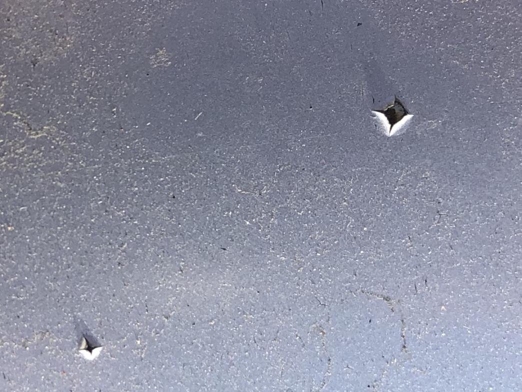

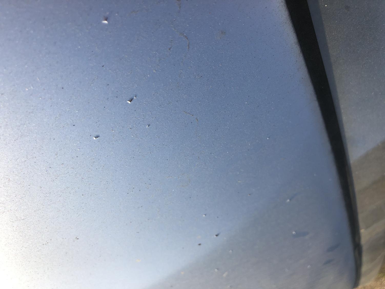

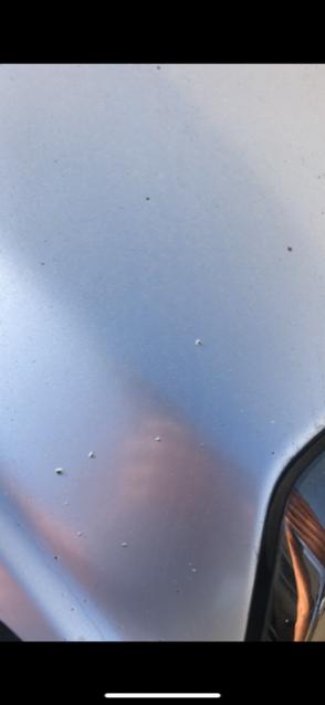

I am nearing the decision to purchase an 08 runner, V8 Sport from a toyota dealership (trade-in). Everything checks out very well aside from one cosmetic issue that I'd like some input on.
I've seen the car before it went in for safety inspection and detailing, and its clear that it was being parked outside, probably in the owners driveway due to dirt/rain grime on the exterior.

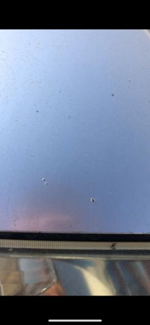

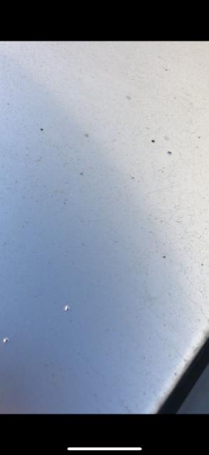

On the front of the hood only, there are maybe 20-30 very tiny (think tip of a pen) bubbles that opened, some showing a single small dot of rust in the center. Some are too small to even see into the crack.
1- what could have caused this?
2- what would a repair entail? Dealership isn't touching anything cosmetic for the sale.

I’m going to bet that car has been towed behind a motor home. The little specs are debris bouncing off the paint creating a void for contaminants to fill which corrodes the metal and then the paint bubbles as the metal fails.
The amount of little specs leads me to believe it was a tow behind. Or driven behind a lot of trucks flinging debris all over the road.
To fix it you gotta get that hood down to metal and re-spray.

Chips and rust and a crappy repaint, or a cheap paint job on a aftermarket hood.

A decent re-spray for the hood is only a few hundred bucks, if the deal is good enough I wouldn’t let that stop me. But make sure as others pointed out that it has to be stripped to bare metal and the rust blasted off.

Something doesn’t add up here. That’s the first time in 5 years on this board I can recall seeing rust bubbles like that on a hood. The back hatch, yes indeed, and that’s where it’s rusting from inside b/c Toyota inexplicably applied sound deadener before painting or coating the inside & surprise, water got underneath. My truck is a silver ‘07 that had 96K when I bought it in 2014 & 168K today and the hood paint is a couple of hairline cracks in the clear coat away from pristine.
The possibilities bouncing around inside my (cynical) mind range from this being a flood vehicle to a turned-back odometer. In any case, that hood is a red flag, and imo it’s up at the top of the pole snapping in the breeze.

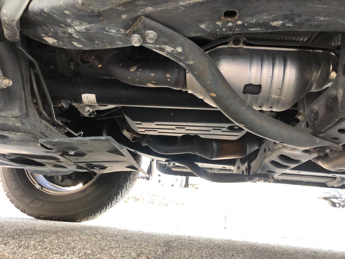

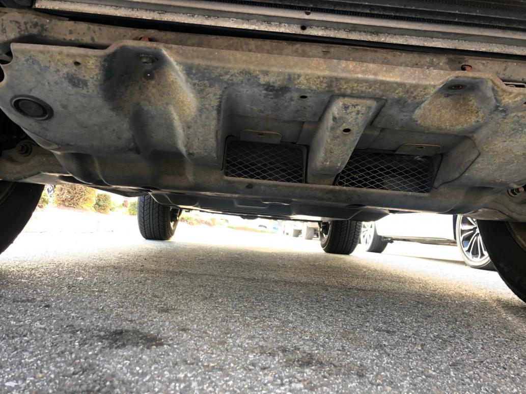

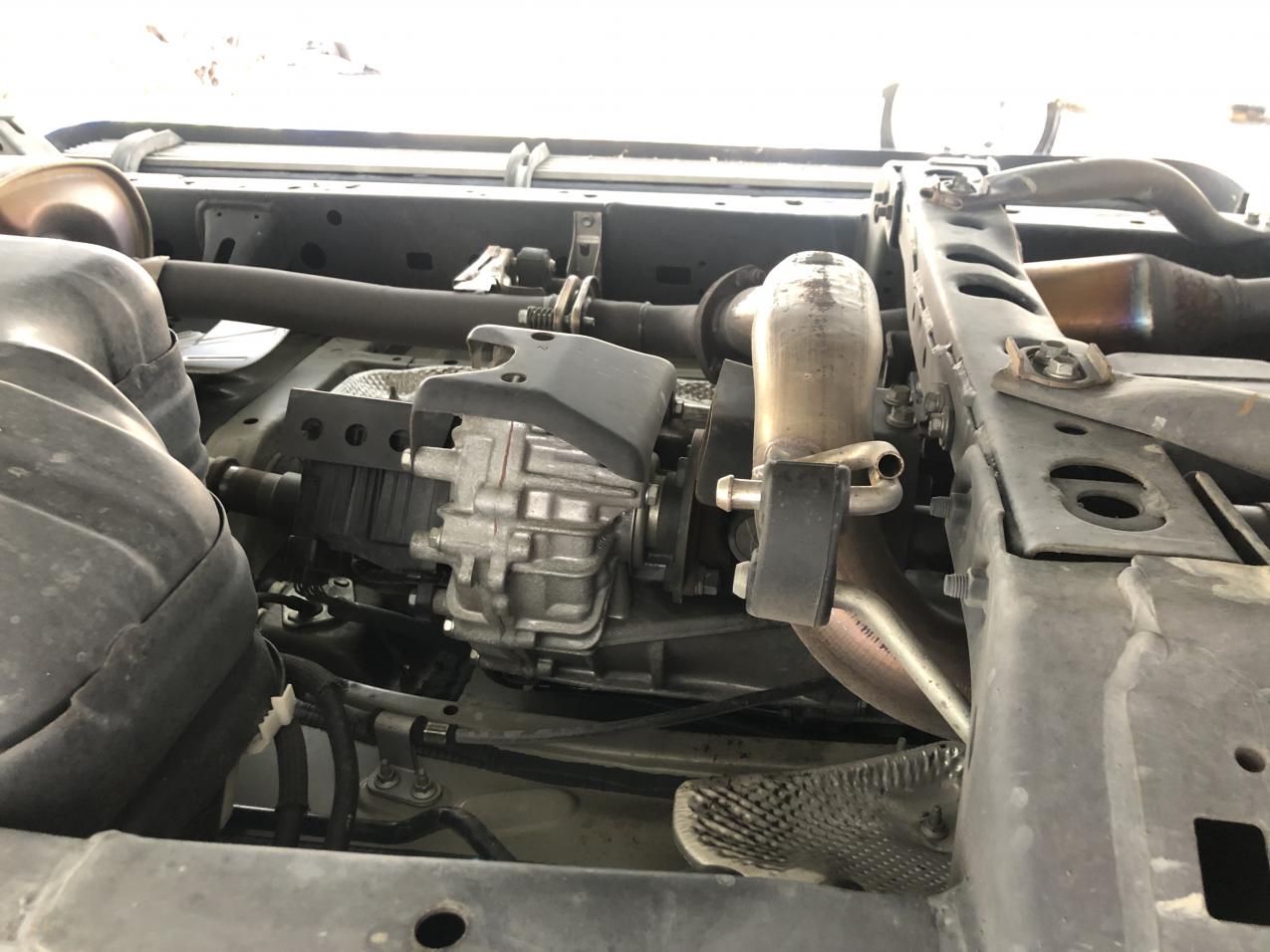

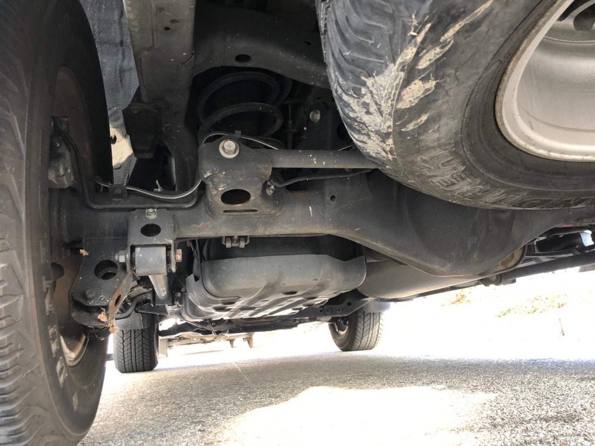

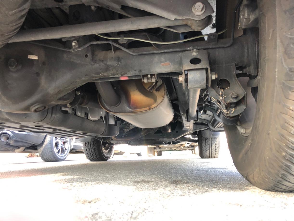

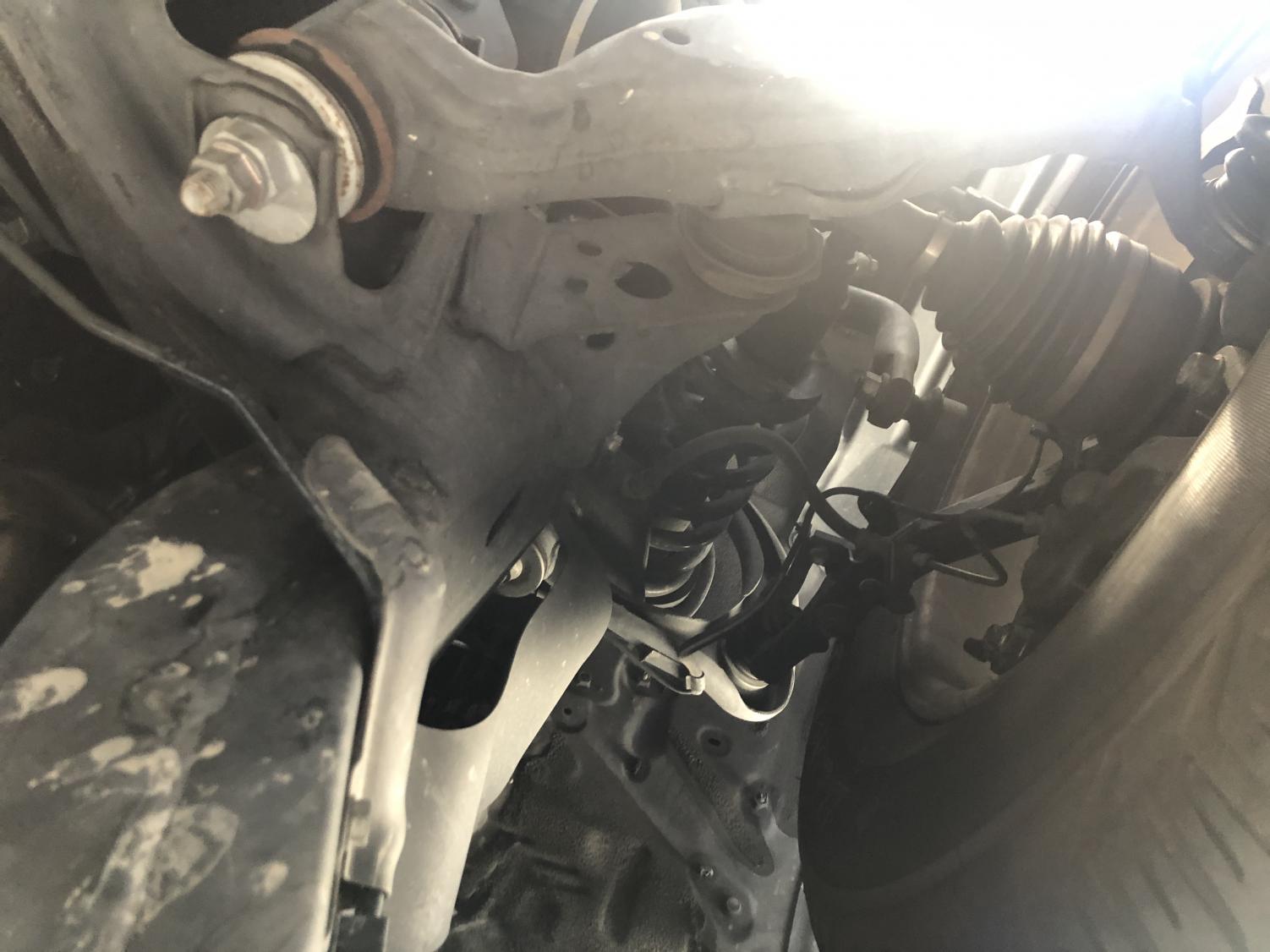

I was sure to look underneath:

the car fax are very straightforward with routine services every 5,000 miles. Nothing out of the ordinary (perhaps in the opposite way of being over-cautious for a vehicle that wasnt used much), and the owner serviced and now traded in to the very dealership he is buying his new runner from, so the truck has stayed local here in SoCal
Bolt missing on front skid plate...lost, stripped, etc.?
AND looks like the drive shaft/u-joints haven't been greased...
Chances are the bolt was lost when doing an oil change. Very common. Even on brand new 5th gens. Also most people don't know about greasing the shafts and joints unless they have been up here and read about it.
Those are both 2 minor things that can be remedied almost immediately with little money spent and have very little negative effect on overall quality of the vehicle.
V8 sport, 1 owner, low miles, no rust. Buy it. You'll regret it if you don't. Touch up the spots on the hood and see what you think. If it doesn't suit you, have a shop do a real paint job on it for several hundred bucks and be done with it. I know that wouldn't scare me away from it. Curious as to what a dealership is asking for that.
