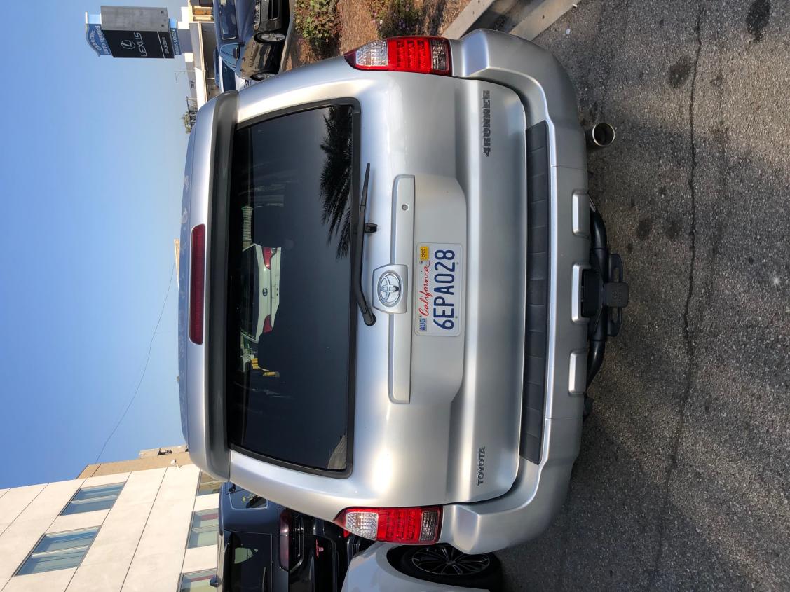

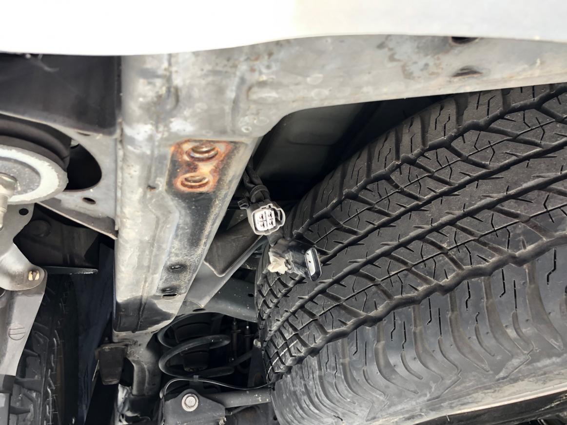

This is the picture I took and showed them, to which they replied it wasnt OEM claiming it "bulges out further than the factory hitch". And then a pic of all thats left now where the outlet was formerly plugged in.

That is 100% without doubt a Toyota OEM factory installed 4th Gen V8 tow hitch!!

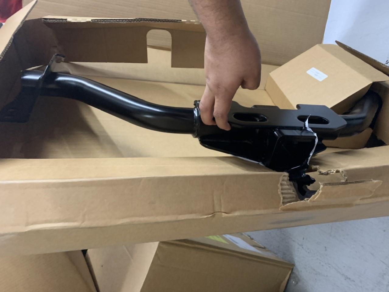

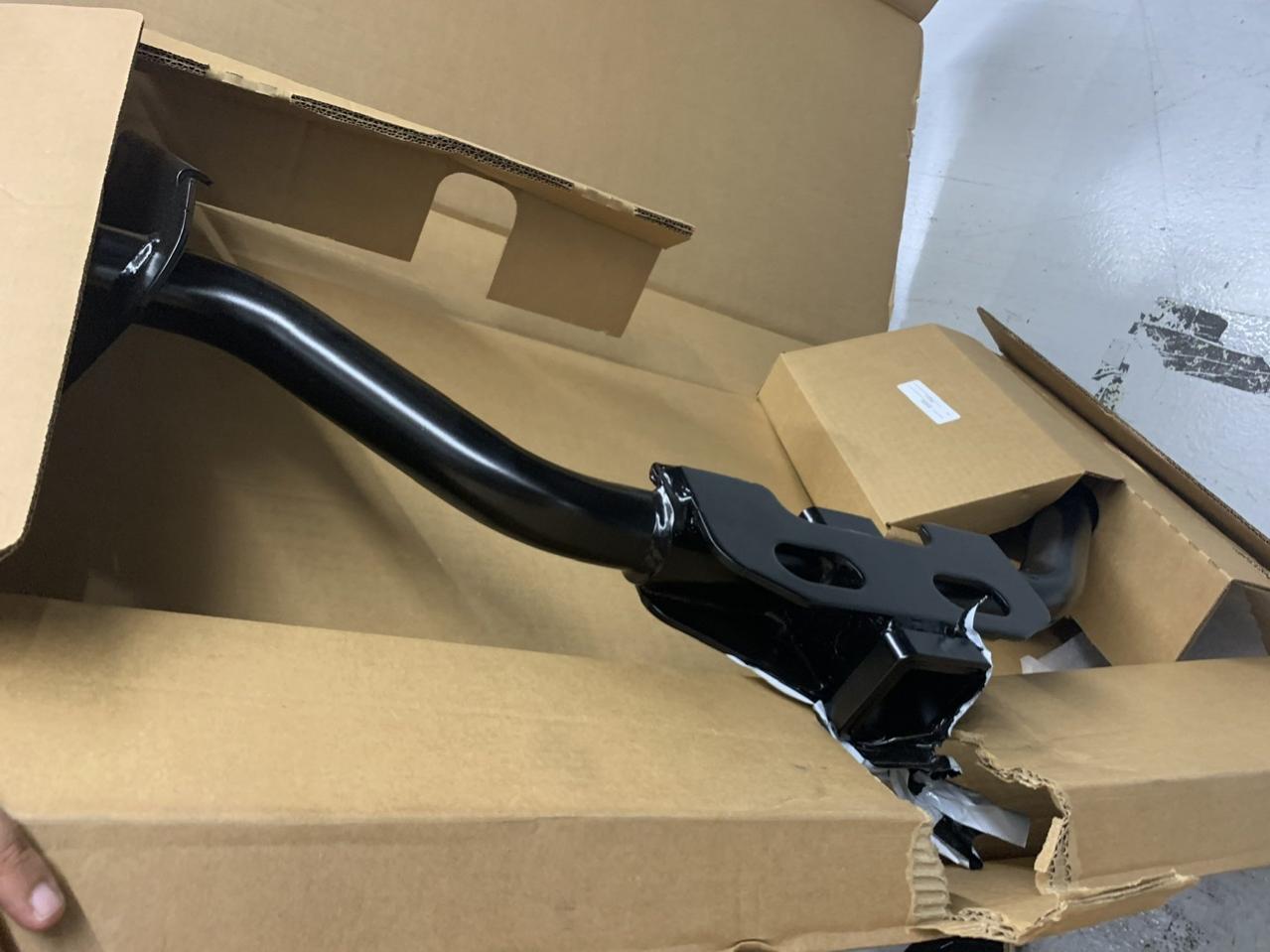

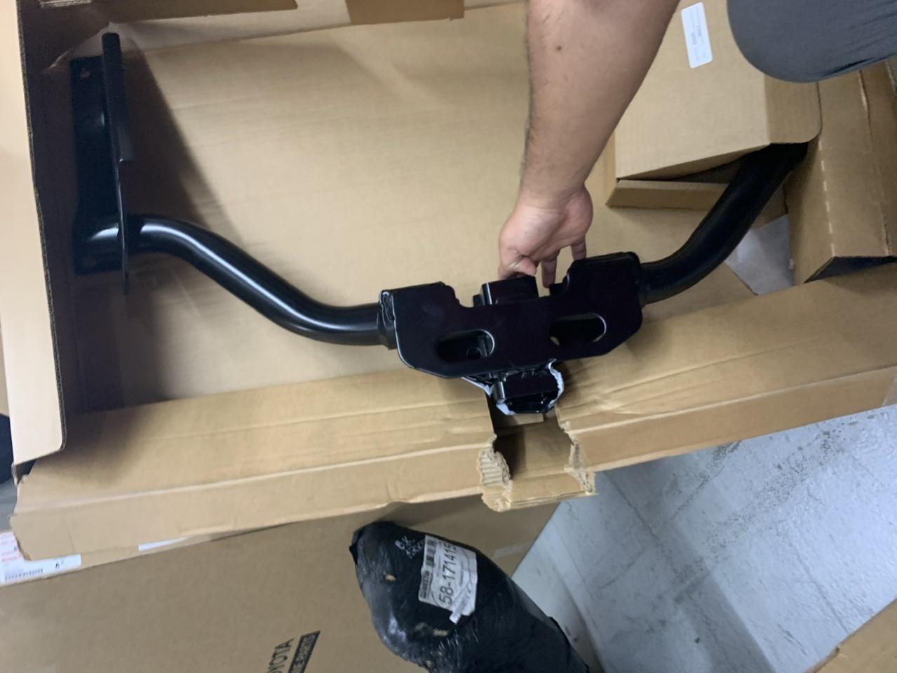

Ok guys, here is what they ordered. I had them send pics before I went in. Does it looks to be the V8 hitch?

Take a look above. Looks the same to what others have sent. I’m just hoping the electrical connection is in that box as well

That is indeed a V8 hitch!
If the electrical connector isn't there just get them to order it!

So I had the rep check to see if the electrical hitch socket was included in the box...of course he wasn't sure and sent more pictures of the box. No electrical. So he then calls me this morning and magically says they found the old hitch with electrical connector. Now its my choice if I want the new hitch or the original :dizzy:
Dealerships, man. So ready to be done with these people. Opted for the new hitch with the original 7-pin electrical connector.
