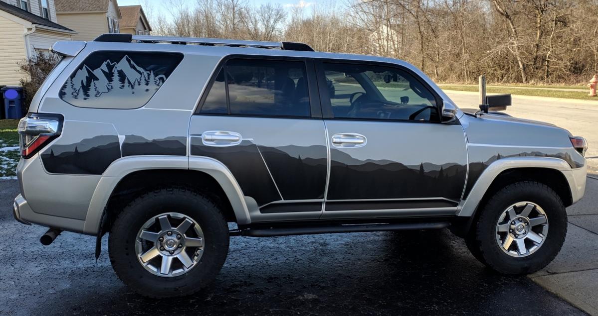

21Jan21 102,583mi
Trying to keep busy as a way of avoidance, and it was a 44F degree day in January. So I gave the truck a quick wash and added the GOAT TruckArmor panels that I grabbed on Black Friday. It was nice to get them off of the living floor where I had them trying to unfurl from the shipping container, but they look great on the truck.
I've had a couple issues. The front of the fender pieces don't stay in place because the magnets don't have the strength to hold to the steel over the thickness of the 3M PPF. I ended up having to cut off some of these panels.
The driver's side door panels took some adjustment to get the upper part above the door handle to lay flat. I ended up having to put small neodymium magnets on top of the GOAT armor to hold it in place. After a few days it started to lay flat against the door. I also all but lost the driver's side C-pillar on the first drive because it wasn't laying flat either.
The last issue was communication. There were no instructions at all included in the package. Ok well it's a magnet, it can't be that hard right? But getting a hold of the company GOAT TruckArmor was slow at best. When I realized there were issues, I tried calling, emailing, and sending a FB message. I never got a phone call back from my phone messages, the email wasn't replied to, but after about a day and a half I got a response on FB. It didn't include any answers to my questions, just a status check. I replied with more questions and still have had no response.
EDIT: About 2 weeks after installing this I was trying to figure out more about it and found a install instructions and care buried on their website under FAQ. For the life of me I don't understand why this single sheet print out wasn't included with the order. It would have saved a ton of questions and frustration.

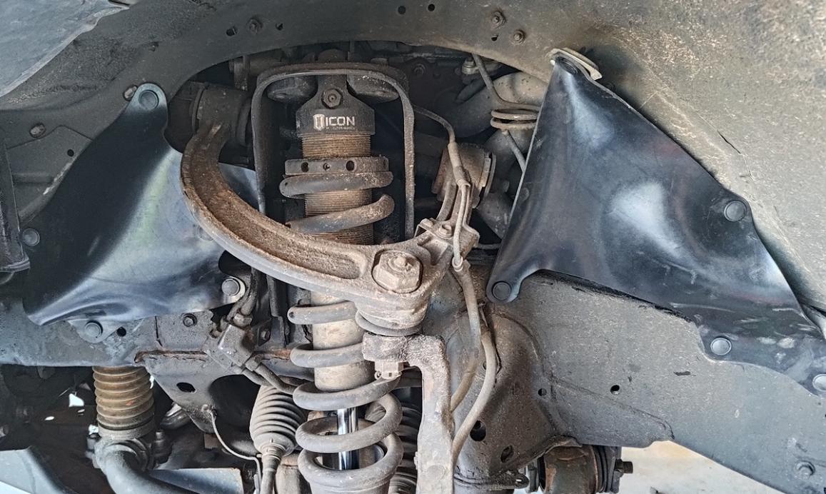

14Feb2024 128,438mi
After years of fighting with the OEM engine bay splash guards I finally threw them out. I bought this vehicle new, and was on my 2nd set of engine splash guards. At the last road trip, I resorted to some twist ties from bread bags to hold the things in place after losing more connectors and having the guards flapping around. But being thin wire with a paper wrap, I didn't expect the twist ties to stand up to any off-road adventures, mud, or brush very well, or last long.
I'd seen the advertisements and other threads on this forum heralding the difference between OEM engine splash guards and the Rad Rubber Design option. I knew there would be a difference, but honestly you could stack 4 of the OEM guards up and not get to the thickness of a single guard from Rad Rubber. It gets better though.
The OEM plastic retainers are little more than a cylinder with a 2 small nubs to keep them from popping back out, they break, get lost, and fail frequently. I ordered 15 extra of the things when I replaced the original set. They lasted about 3 years before I ran out of replacements. The kicker is that I wasn't even driving through deep brush, running through mud holes, or even doing serious off-roading for the last several years owing to too much overtime to work and a cross country move. Rad Rubber provides two-piece plastic rivets that are serrated on the shaft to hold the rubber down. The expand plenty big enough inside the retaining holes to hold firm too. I messed up and had to remove one from the passenger side. It took me 5 minutes trying not to destroy it, and 2 more to destroy it once I realized they sent a spare for each side. Once installed, these stay well put.
Installation was easy, dirty given the location, but easy. I highly suggest just removing the front wheels instead of trying to reach around them. Overall, one of the better $50 upgrades for the truck out there. I wish I had done this the first time!
