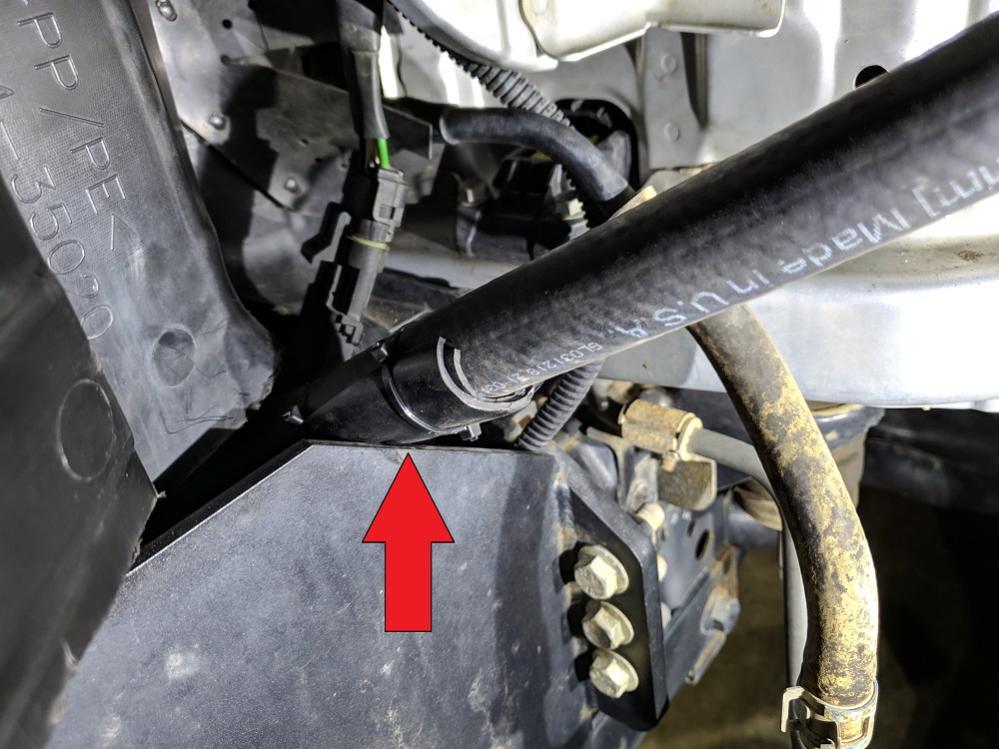

Oh wow, you smashed yours up against the fenderwell on the inside? I fed mine through to the outside like this
DOH! I bet it's supposed to go through the hole like that, it really was pretty difficult to line up the bolts to re-secure the lower air box my way.
I removed mine after only 3 days because of the noise level. I'm pretty sure the intake was resonating in the fender, making it much louder, and not really tolerable as a daily driver. I already have enough noise with the 3" exhaust, but at least that is all behind me as I drive. The noise on this with any sort of acceleration was a rumble that couldn't be ignored. Since I have lots of stop-lights and such, I decided just to remove it. So I'm back to sucking air through the fender, and some from the engine compartment.
EDIT: Well maybe that small intake temperature difference isn't so small. Today in rush hour stop-n-go traffic I noticed the intake temp 35F above ambient temp. Guess I need something to ensure air is drawing from the fender area. Guess I might have to reinstall this or the OEM scoop.

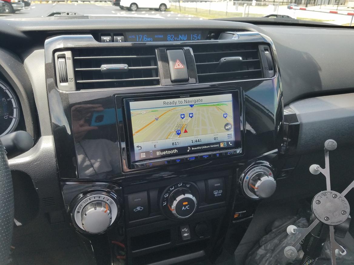

Kenwood DNX-995S

This upgrade was so fun, I had to do it twice! Actually I attempted a modded install, then went back and used the proper kit. I liked the latter more, but the former worked just fine too.

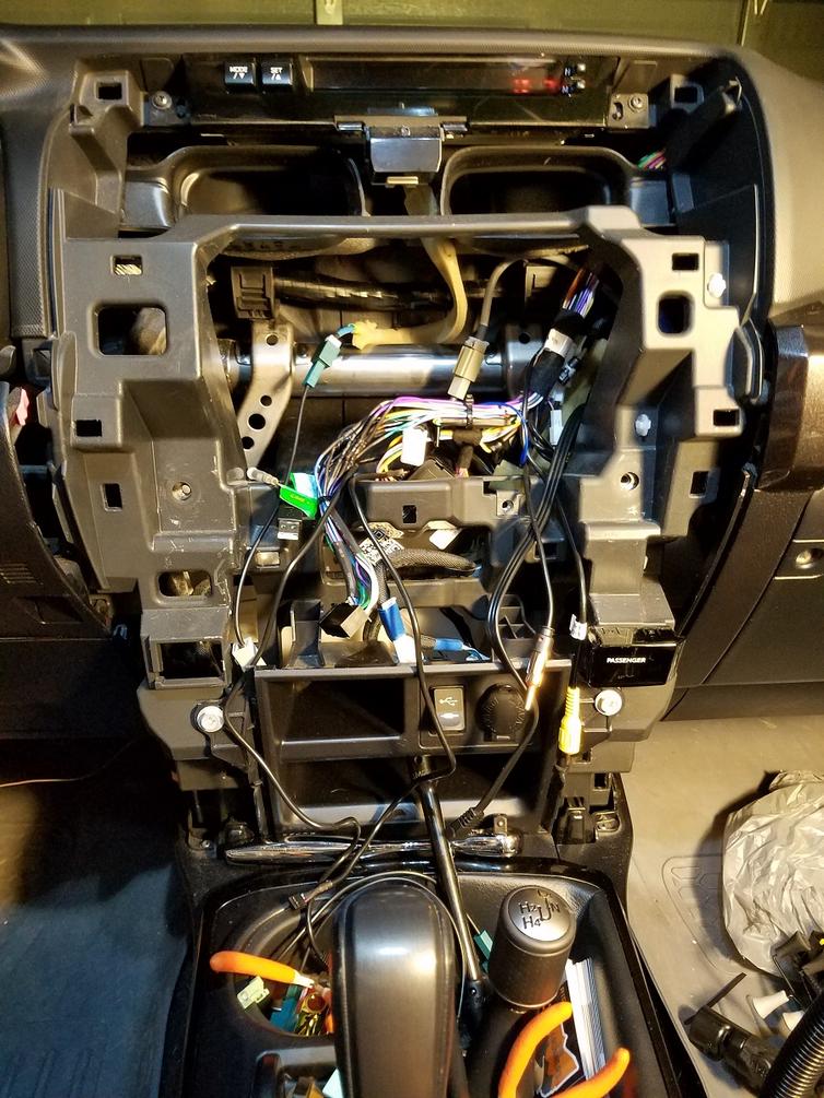

Lots of wiring to figure out here, I called Crutchfield tech support not less than 3 times. Admittedly twice were to see if we missed something, and they hadn't told me I needed a couple harnesses. They made good on customer service and sent them to me. Over the course of several hours, I soldered the connections together between the harnesses, and used heat shrink for a safe and clean connection. It's still a huge bundle of wires to deal with, and plastic connectors all over the place. Once I had both dash kits I removed the lower trim piece below the passenger side temperature knob, and took them all to a local auto body & paint shop. They did really well matching the paint, though it was $100 per dash kit!

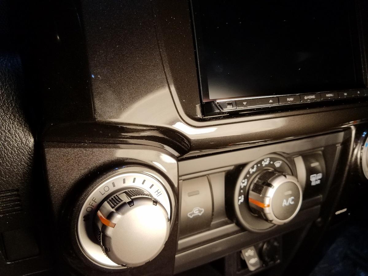

EDIT 28Jul18: Paint code used by shop Bentley, LR9V Diamond Black Metallic

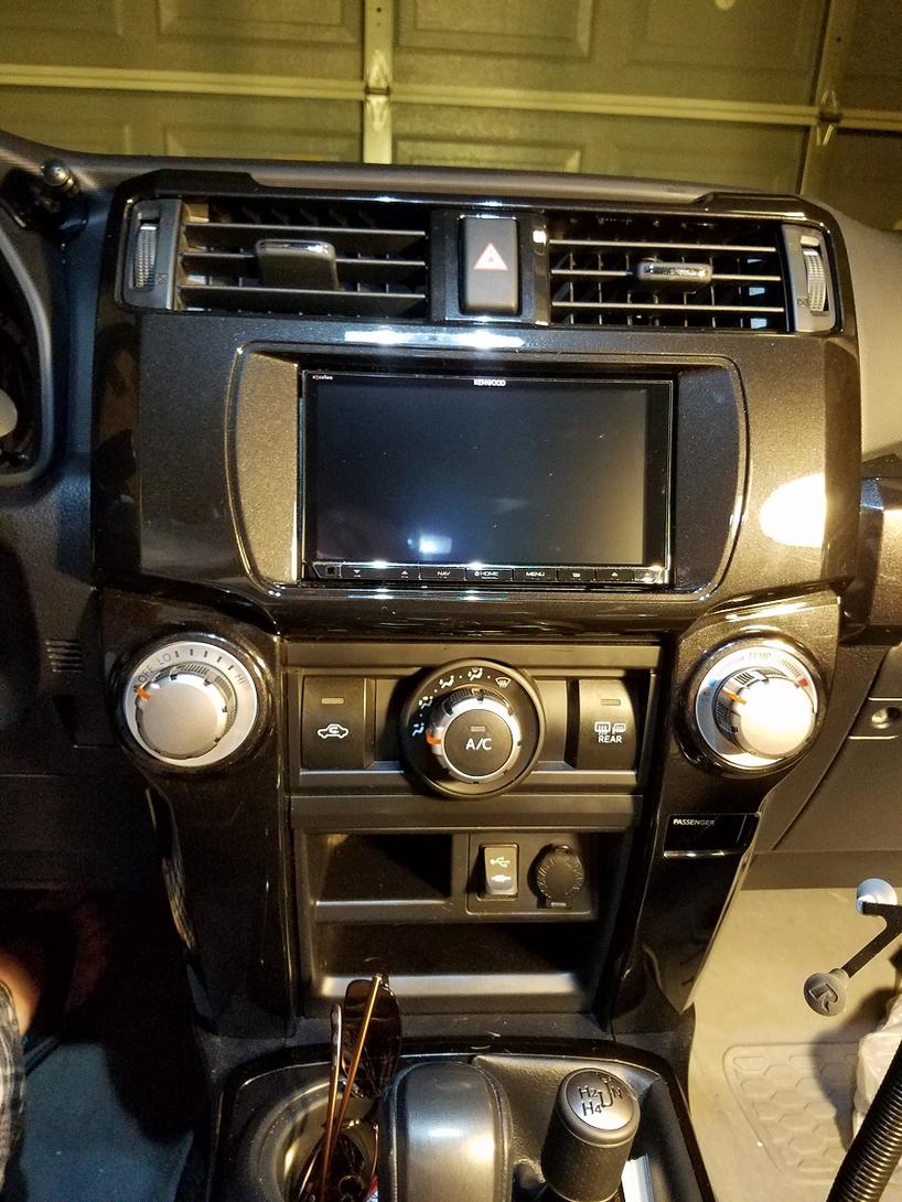

The biggest pain I hadn't planned on was the dash kit. No matter which one you use, it requires some work. The vents, vent adjustment wheel trims, and hazard light switch, and center display lower trim all need to be transferred over. A long handled jewler's philips is invaluable here.
It's easiest to remove the center display lower trim panel (screws on back and slide out), then the vents (tabs in each corner first, then top and bottom tabs), then the vent adjustment wheel trims (screws on back, come off the front), and hazard switch (tabs on back, comes out through front). Reverse order for the install into the new dash kit.
Installation #1 - Metra Kit

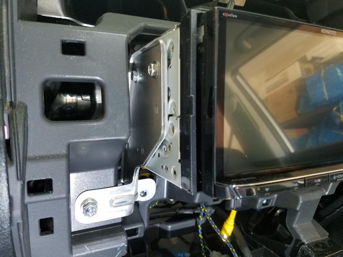

I liked the clean lines of the Metra kit from the start. Looking at how everything mounted up, I wanted to try something. The OEM radio mounts to metal brackets held in place by the 4 10mm bolts along the bottom, in addition to the metal bracket on the backside of the main panel (where all the large buttons and knobs are). It always felt nice and secure, so I wanted to keep as much of that as possible. The Metra kit allows of this possibility, but you have to grind down a locating nub on each side of the OEM brackets to mount them to an aftermarket double-DIN radio (the arrow).
Once those nubs are ground off, you can reinstall the OEM brackets to the aftermarket radio. Make all the connections, install the radio in the dash, and install the Metra kit over top of the radio. Add the trim piece around the end, and it's set. It actually worked better than I thought. I was in a rush to finish before work so I didn't get to tuck everything away as neatly as I liked.
Sadly at the end of the day, I have to agree with the others I've read here: The Metra dash kit is crap. The plastic and finish are cheap, and the fitment is poor. There's gaps left between dash sections, including center display lower trim, and on both sides of the kit where it meets the dash. While it might be good enough for someone, I'm a perfectionist so it had to come out.

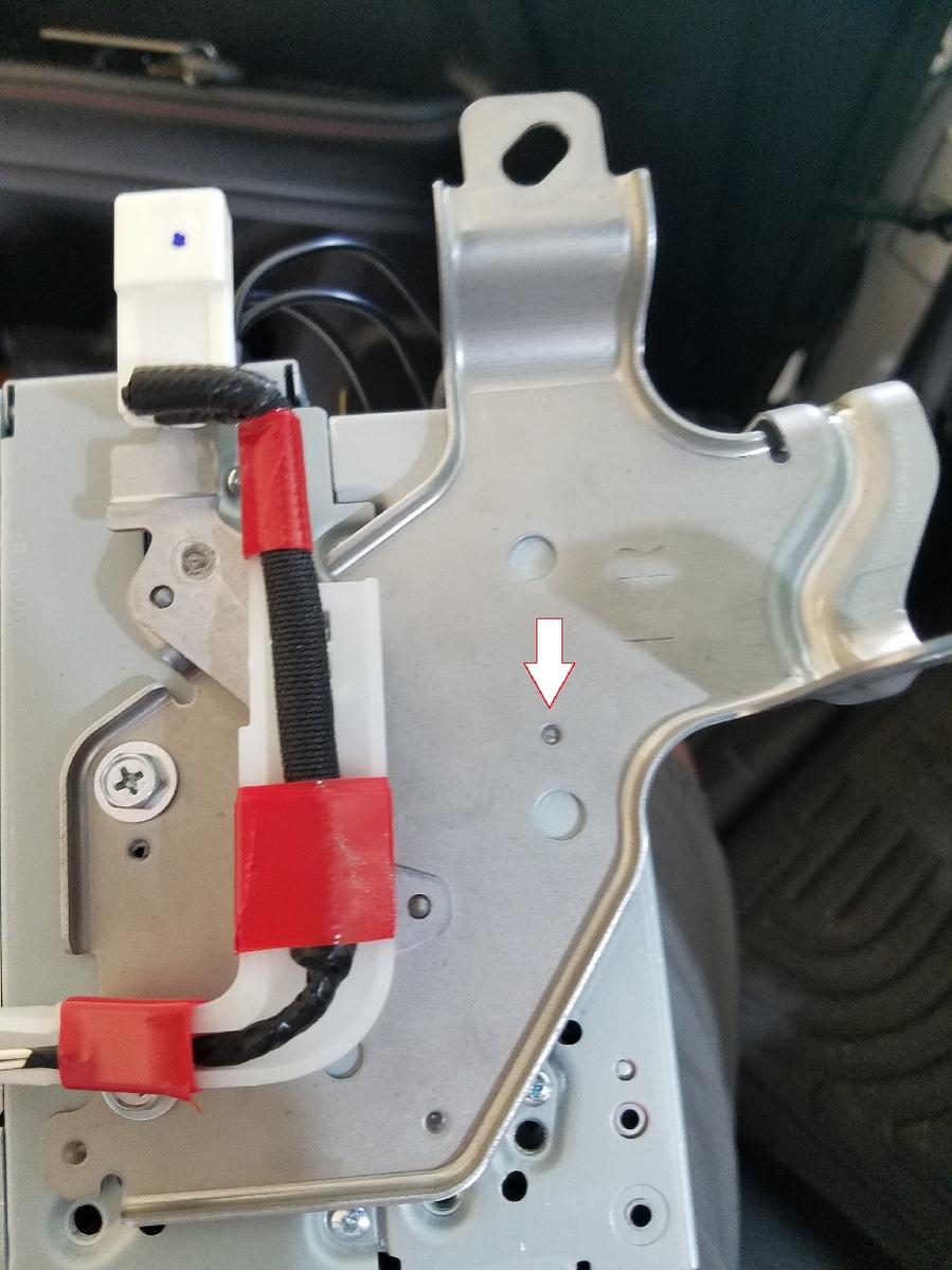

OEM brackets won't work with the Scosche kit without some major modification to the back side of the dash kit which would ruin it for it's intended instructions. I wasn't up for this, so just decided to put it in following the instructions. I used the prescribed Kenwood USB extension cable along with the Samsung cable, it was enough to get Android Auto to work. Yes this has wireless Android Auto, but my current phone doesn't support it. Instead of leaving the wire flopping around when not in use, I ran it under the loom for the X-Grip stand so it's held in place when not in use.

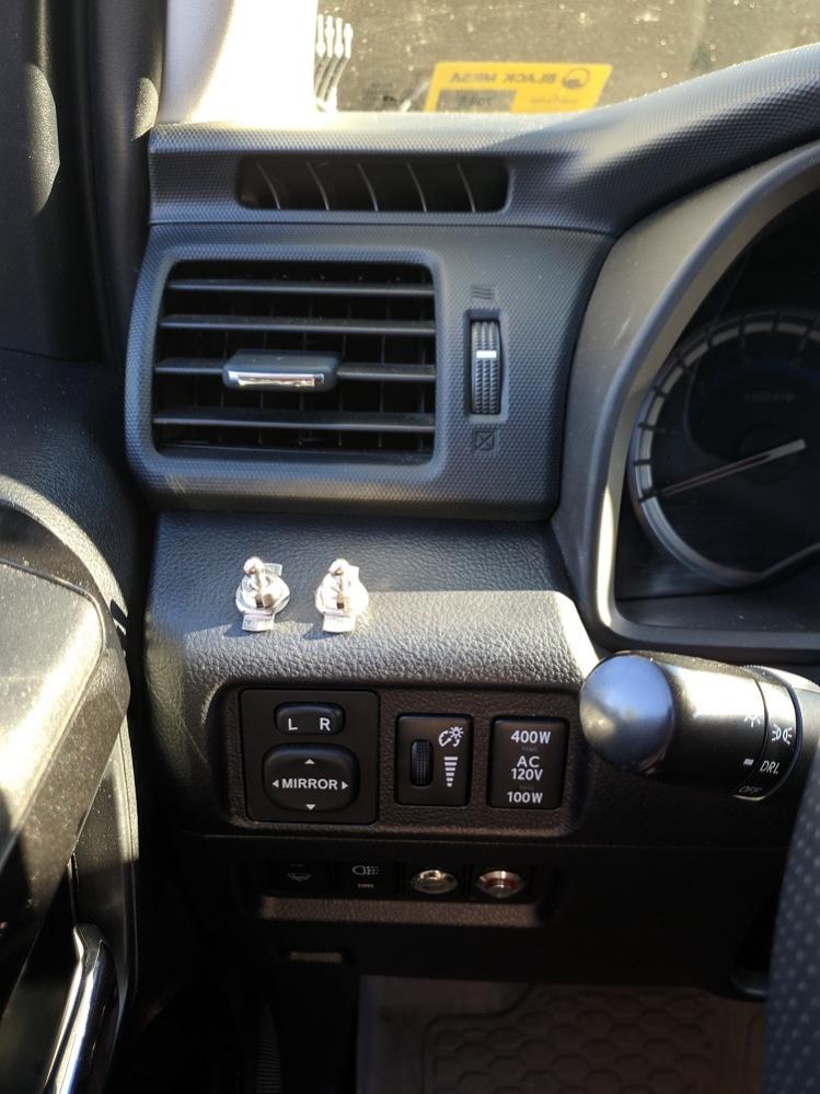

I kind of like my DRL in the daytime, so I wanted to keep them. However, when I want to run parking lights and fog lights only during white-out or heavy fog conditions. After reading the DRL Disable Thread, [MENTION=4160]KDCane[/MENTION] posted some diagrams that got me thinking. Since I still want the ability to run DRL's, bending the pin in the relay wouldn't cut it. I needed a switch somewhere in the circuit.

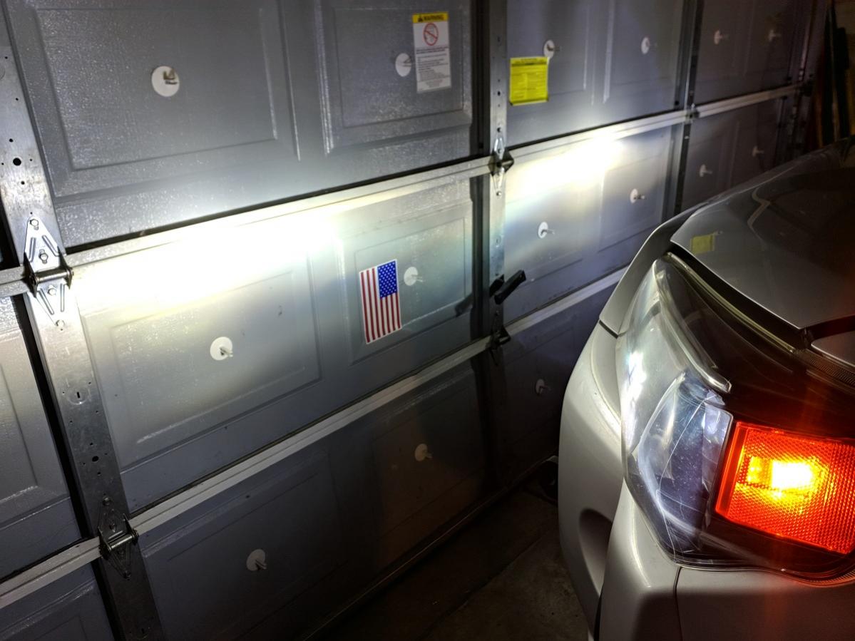

HID/LED comparison. XenonDepot Xtreme HID w/Philips 4300k vs GTR Ultra 2
Color: HID 4300k, LED 6000k. Though most don't like the lower color temperature, it does have a higher CRI, and appears brighter. Point HID.
Intensity: Side by side at close range against the garage door you can see the intensity is pretty close. Down a dark wet road and at a distance of 300-500ft the HID were more intense. Point HID.
Beam Pattern: Full and wide with no hot spots on either. Draw.
Startup: Even with the relays, the HIDs could take anywhere from 5 seconds to 2 minutes to reach full brightness, longer the later into their lifespan they get or colder it was outside. The LED are instant on, and will be until they fail. Point LED.
Lifespan: HID 2500, LED no specs published. Most quality LED will run 40,000 hours. Theoretically the point should go to LED.
Cost: HID Kit $150+, Ultra2 $200. Draw. By the time you pay for the significantly better upgrade to the Philips HID bulbs you're at the $200 mark on either. I've installed the XD bulbs that come standard and they just aren't as full or as bright as the Philips.
Installation: LED plug & play, fits entirely inside dust covers. HID, remove battery, drill dust covers, mount ballasts, install relays, wires all over need zip tied, be careful not to touch the bulbs. Philips though the original 4300k v1 bulbs have a right angle base, the newer 5000k v2 bulbs don't which makes required torque application extremely difficult. Point LED.
Fitment: HID has a thick rubber collar which makes installation difficult. LED twist in without difficulty. Point LED.
Tally: Color - HID, Intensity - HID, Pattern - Draw, Startup - LED, Lifespan - LED, Cost - Draw, Install - LED, Fit - LED.
Honestly if you're looking for the brightest installation out there and recurring bulb costs don't bother you, HID should be your choice. I got almost 4 years out of my HID install before it started getting dimmer, and even sent the old bulbs along with the kit to the new buyer who said they are still working in his install. At least half of my drive time is night, and I estimate the bulbs were closer to 3000 hours of use before I removed them. If you're looking for significant improvement over OEM, and a simple install with a "buy once, cry once" attitude then go LED. /Edit
Here's the GTR Ultra2 LED on the driver with the old XD HID 35w w/Philips 4300k on passenger for a side by side.
And GTR Ultra2 LED on both sides. I've not taken it out for a drive yet. I feel like I need at least a semi legitimate reason to leave the house nowadays with COVID19. I don't expect issues, and love the instant on at full bright that LED has over the bulb warm up on the HID's.

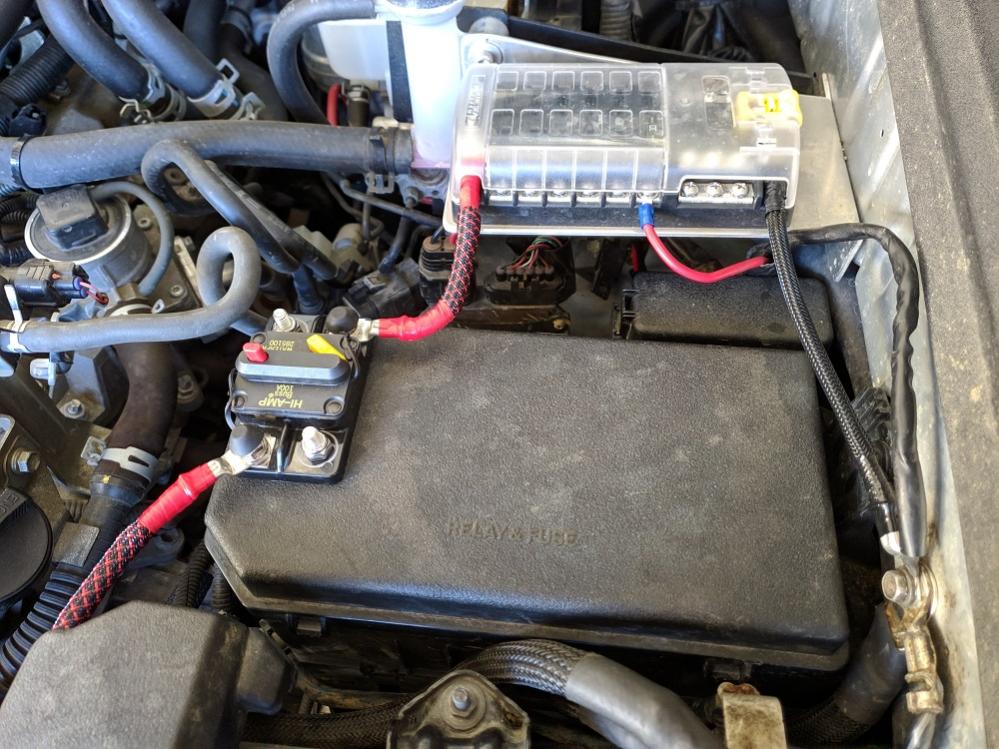

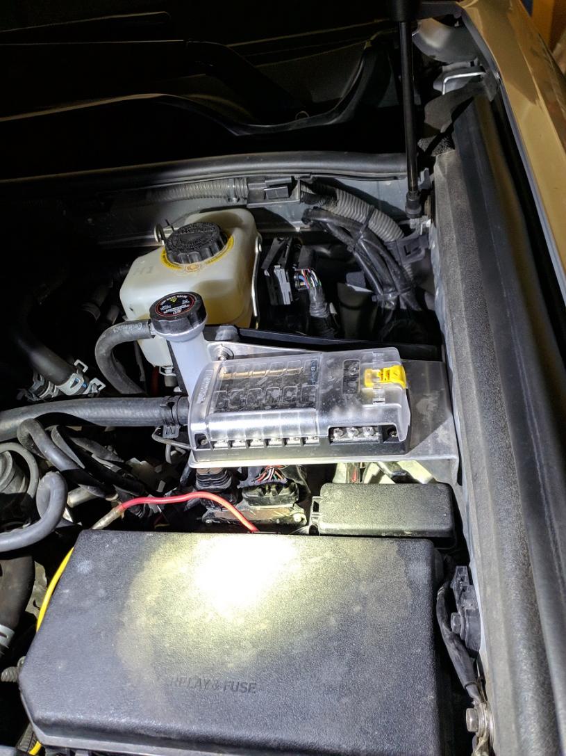

A while back I had a shop fab me up a mount for the fuse block. I didn't get to wiring it today, but started moving things around to make it easier when I do. It's now much simpler to get the battery in and out. Although with the supercharger and intercooler, there's not any room left between the factory fuse box and the inner fender to go running wires. I might be running some up where I had the HID ballasts stuffed, on top of the inner fender under the plastic supporting the rubber hood seal. But that's to come later. There is more wiring for me this week, but it will be doing a full LED conversion and re-wiring the boat trailer. The only good thing about COVID (aside from not getting it), has been the reduced work schedule which is allowing me to catch up on all these projects. Hopefully there will be more posts in the near future!

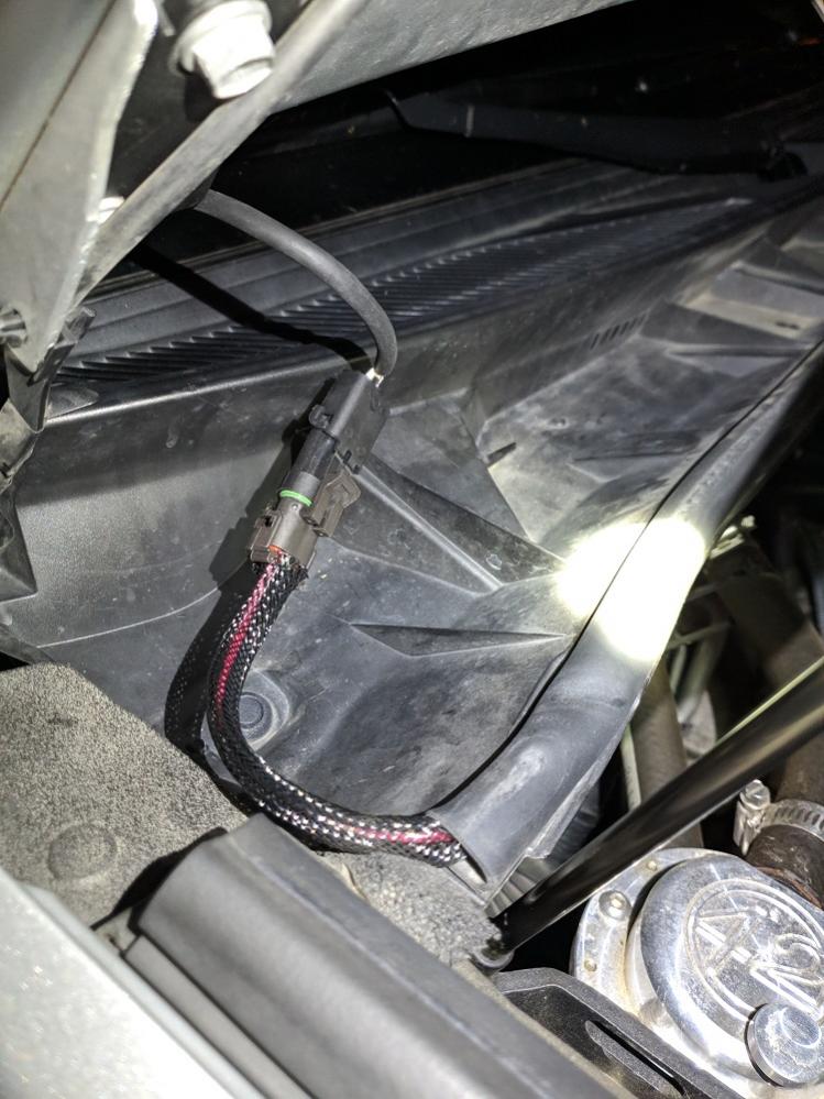

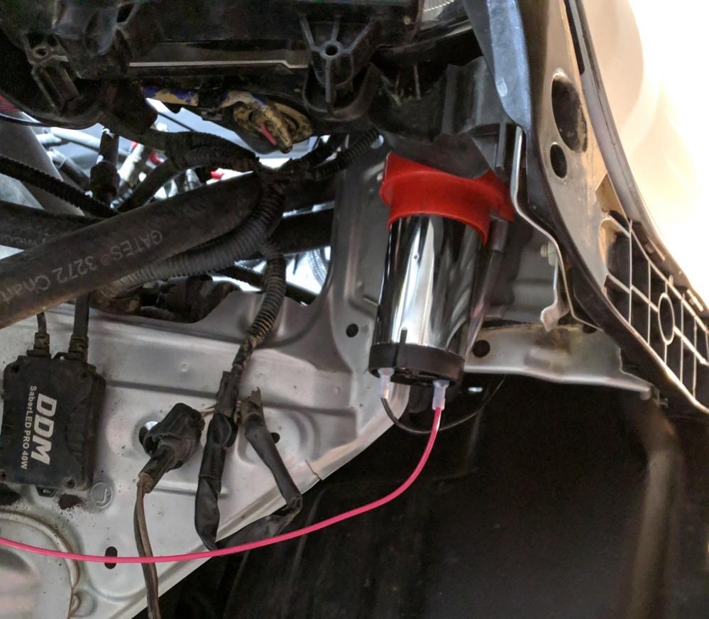

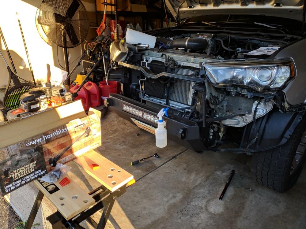

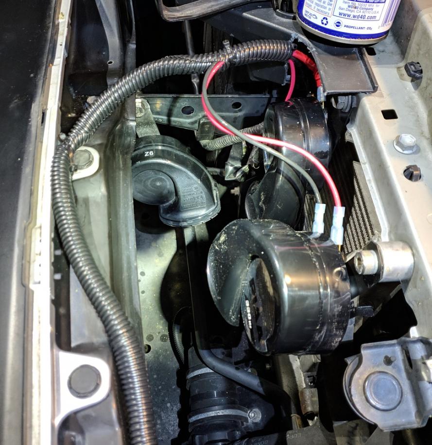

Being the last parts I ordered, the horns were the next upgrade at the top of the pile. I had intended to add a PA speaker and some cool sound effects like this guy. I even bought most of what I needed for it, I decided it was going to be a little more wiring involved than I would like. I think the 4Runner horns are ok, but I really wanted something more truck like. My stupid COVID purchase was a HornBlasters Tug 37 air horn. Thankfully I failed to figure out a place to mount that 37" monster, as it would have required me to add an on-board air compressor and pressure tank. I was ready to go that route, until I realized that there's just not much left room in or near the engine compartment for things of such size. Since I never put a winch in the SSO bumper, I had room for the compressor and tank there, but that still left the horn. Hornblasters was nice, and got a chuckle that I had ordered the Tug to install on an SUV without doing a spare tire delete mounting.
So I decided to look into something more size appropriate, and in the direct drive category because at the end of the day I just can't justify on board air. My portable SmittyBilt is working just fine. Still wanting a low tone, I picked up the biggest/longest direct driven horn I could find, Hornblasters Musket. Since I'm a gun guy, the Musket just seemed right in a karma sort of way too! When I found out the OEM horns are 400 & 500 hz I decided to go lower on them too, and picked up a set of PIAA Superior Bass at 330 & 400 hz.
When I need the horn, I want it loud enough people notice. Although full on train horns are not required or appropriate for most situations, the direct drive air horns aren't as powerful. I'm also not a big enough A-hole to go around startling people just for kicks, remember the original intention was "Nicest Car Horn." I used the factory mounting location for the PIAAs, decided to move the OEM horn to the center bumper support, and just had to find a place for the Musket. Again there wasn't room in the engine compartment. So I removed the grill and bumper for better access to the center bumper and winch area of the SSO. In doing so I saw the line from the coolant pump on the intercooler loop chafing against the SSO bumper. I zip-tied a double layer of wire sheathing from the boat trailer project around it as a sacrifice instead of the line.
Long and straight is more difficult to mount than you'd expect! There aren't a ton of places that even the 18" Musket would fit nicely, and not be in a position which could be submerged. I also wanted to keep it on the driver's side so that the wiring would be shorter. I must have spent 90 minutes before getting the idea to mount it inside the fender above the wheel well. While this would not be an easy place to mount it, it had plenty of room, was out of the way, on the driver's side, dry, and available. While I would have liked to mount it forward facing, getting the wheel well liner off was turning out to be impossible. Even with body panel removal tools, I fought for an hour just getting 2 of the plastic plugs out, removing the other 4 to mount it forward facing wasn't going to be worth it. So It faces back towards me as the driver, but that made mounting the compressor easier and closer to the relay too. The compressor went into an existing hole between the headlight and fog light behind the bumper cover. If I ever have a problem with it, I can at least get at it easily again. The horn would be a different matter.

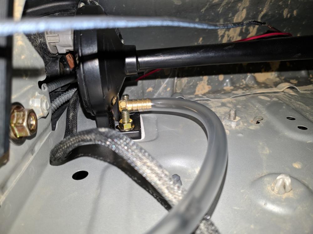

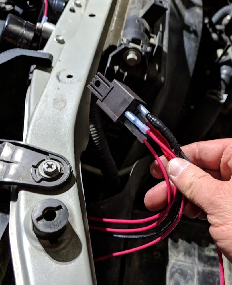

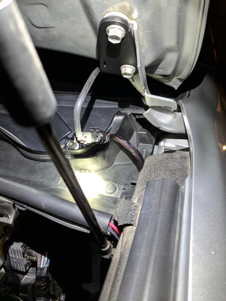

I read at least one thread where aftermarket horns eventually caused a failure of the K-block in the under hood fuse/relay box, so I wanted all the aftermarkets run through a relay and from the newly working aux fuse block. I realized that removing both factory horns could leave me without a horn if the fuse blew or the breaker tripped. Since I only needed one of the factory connectors as a trigger for the relay, I decided to keep the 400 hz horn and just mount it differently.
The PIAA instructions said to cut off the OEM connectors and use factory wiring. Already decided that wasn't an option, and all they had included was a ground wire connection. There was no wiring included with the Musket either, so I cut everything to length with rolls of 14AWG that I bought for reasons like this. While I prefer to solder the connectors on, again I decided it would be too much work and mess. Thinking about it revealed the utility of the small handheld torches though, and I might have to add one to my tool box. In the mean time I ensure that everything was VERY well crimped. I tied both the PIAAs and the Musket into the same relay, adding a special switch or toggle for the Musket just seems like more hassle than it would be worth. I hid the relay under the upper front cross beam with some double-sided Gorilla tape. Then added wire loom and zip ties to clean everything up.
Hear them in these videos.
OEM 400HZ ONLY
OEM 400HZ + PIAA 330HZ & 400HZ + Musket

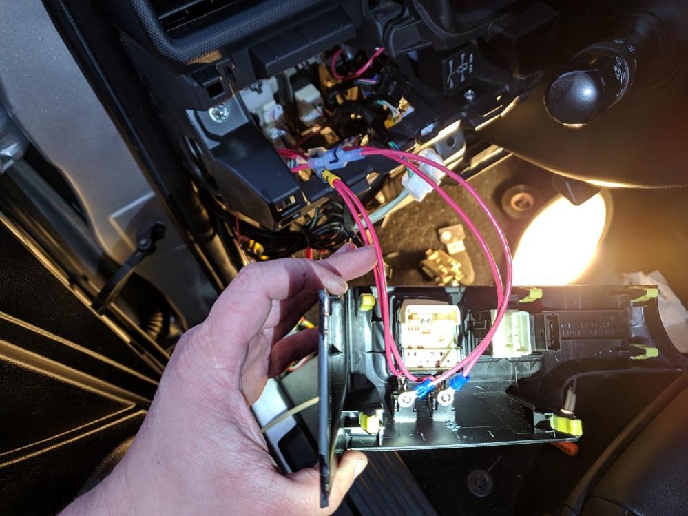

The long awaited time finally came, and I checked off 2 more mods off my to-do list.
Mod #1 [MENTION=65614]Antman[/MENTION]'s Fog Light Mod (Start at post #22)
This has been on my list ever since I had to drive in white-out conditions with the HID low beams. Just parking lights and fog lights is all I wanted, and there was no way to do it without modding the vehicle. Of course every vehicle and need is different so I skewed from Antman's instructions, but they were a great help and influence. I elected not to complete the upgrade to the dashboard as it seemed unnecessary. With the Baja Design Squadron Sport fog lights, the only time you don't know they're on is full bright day light, and even then you can see the reflection on any road sign.

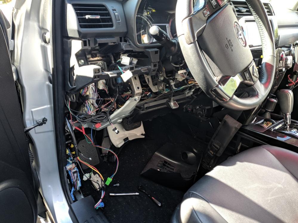

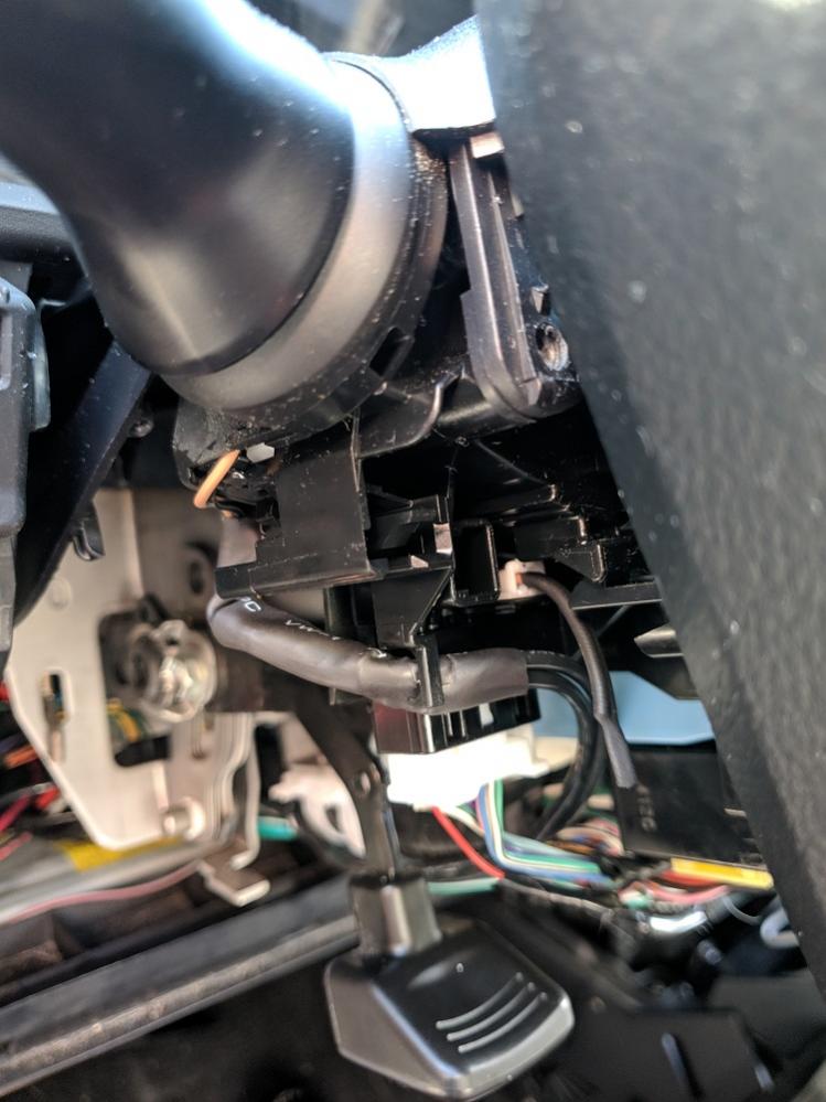

Step #1 - Ensure proper supervision.
Disassemble Dash. That's a lot of wires, and I'm still adding more!
I wasn't tapping into the OEM fuse box, but just adding to the aux fuse block that I have under the hood. It meant fishing wires through the firewall grommet, but I've gotten pretty decent at it. While occasionally useful, I also don't like using body grounds for things that can be turned on while the vehicle is off, so add another line to the negative side of the fuse block.
I tried to decide on wiring ahead of time, but wasn't sure exactly how I wanted it until I could get the dash apart. It was also based on where I mounted the relay. My relay terminal 86 is wired to the brown wire on the OEM switch. Then OEM switch goes to fuse block negative. I skipped the IGN-ON circuit option Antman presented, so fuse block positive provides to both terminals 30 & 85. Terminal 87 runs to the White/Silver wire depicted in Antman's thread.
Wiring for the OEM stalk switch

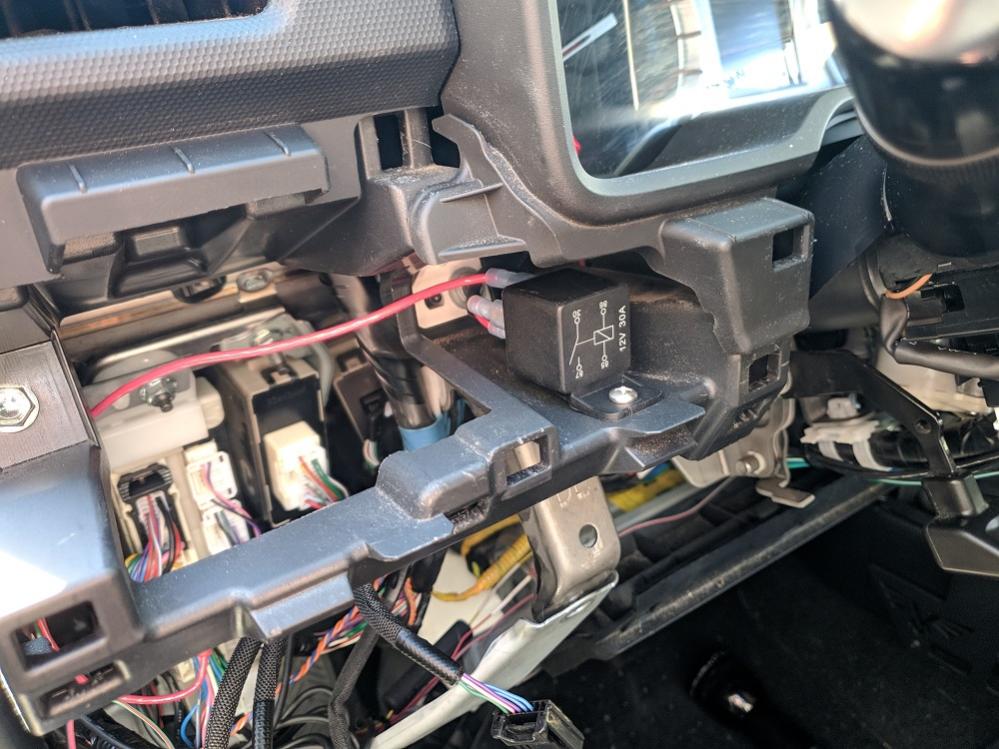

Relay mount location. This came in really handy and wasn't being used for anything while still being hidden behind the dash.

Mod #2
While I had the dash apart, all the supplies out and a mess made of the truck I decided to finally get around to put wiring behind those switches I drilled into the dash for my ditch lights. I've only had the ditch lights sitting on the work bench since 2018, but my reduced work schedule meant I had the time to finally install them. No time like the present.

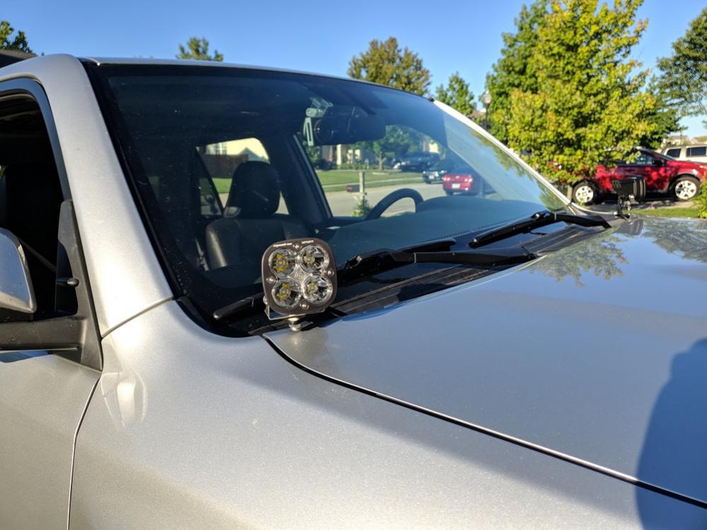

There were 2 big issues with ditch lights:
A) Baja Designs wiring harness isn't long enough
B) I wanted each light switched individually
The reason for Issue B was that I often drive in mountainous areas, where one side can be a sheer cliff, and the other side a nice pasture full of deer. I don't want dazzled from the light on one side while missing the deer on the other. This meant making my own harness, somewhat intimidating for someone who's not done it. But when I realized it was just running wires where I needed them and adding connectors it became much simpler. The hard part was figuring out how I wanted it wired. In the end I decided several things which really made this more simple.
Each BD Squadron light can draw a max of <3A. With that low of a draw, I could wire directly through the switches, no relays required. I did ensure the switches I purchased were rated for up to 12v 25A, so they shouldn't have issues. In wiring directly through the switch, I can run positive from the switch to each light individually, and leave the negative shorter by running direct to each light.
So there's a single power run from the aux fuse block to a quick disconnect behind the dash. The quick disconnect makes it so that the dash can still be removed without removing the switches. I decided this was important and worked to my advantage to serve as a point to split to each switch close to them. Then each switch runs back through a quick disconnect, the firewall grommet, and out to each light.
Behind Switches/Dash
I debated about running the passenger side across inside the cabin then out closer to the light, but the HVAC system really makes that look difficult. Tearing apart the passenger side of the dashboard also was not appealing. I tried to run along the main harness at the top back of the firewall, but had trouble getting through any but the first retainer. So I cheated, and ran both wires to the passenger side light through the seal under the top of the hood. I don't think the hood puts enough pressure on that seal to smash the wires let alone wear on them.
Driver's Side Wiring
Passenger Side Wiring

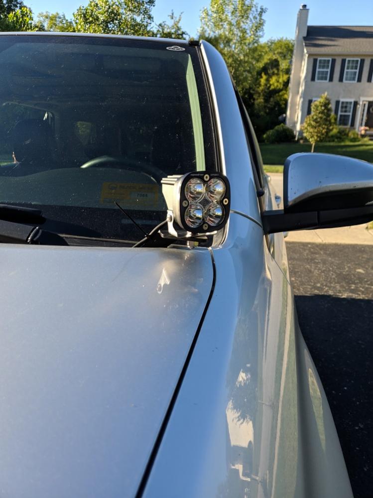

Ditch Lights Continued
The switches completed and dash reassembled
Ditch lights
And now I can finally signal the International Space Station from my truck! (All lights can be on simultaneously)

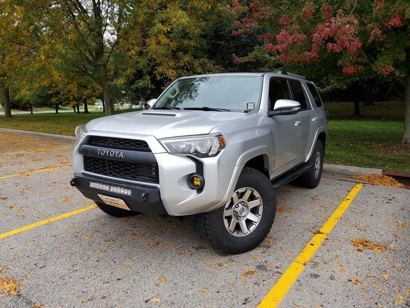

17Sep2020 99,575 mi
Finally got the new tires installed. Went with Toyo Open Country AT3 P285/70R17. I debated about the sizing for months, along with P vs LT C loads. In the end, my off-roading is limited, I wanted to reclaim a bit of a smoother ride without losing even more MPG because of the larger size. I can tell you the ride home was noticeably smoother and taller.
I trimmed about 1/2" of the bottom of the bumper in the wheel well, and had to push the fender liner forward some (new holes). The driver's front seems to be rubbing on the mudflap, but it could be rubbing the body mount. I'm going to be watching it carefully. I'll probably end up ordering a BMC kit in a week or so if only for peace of mind.

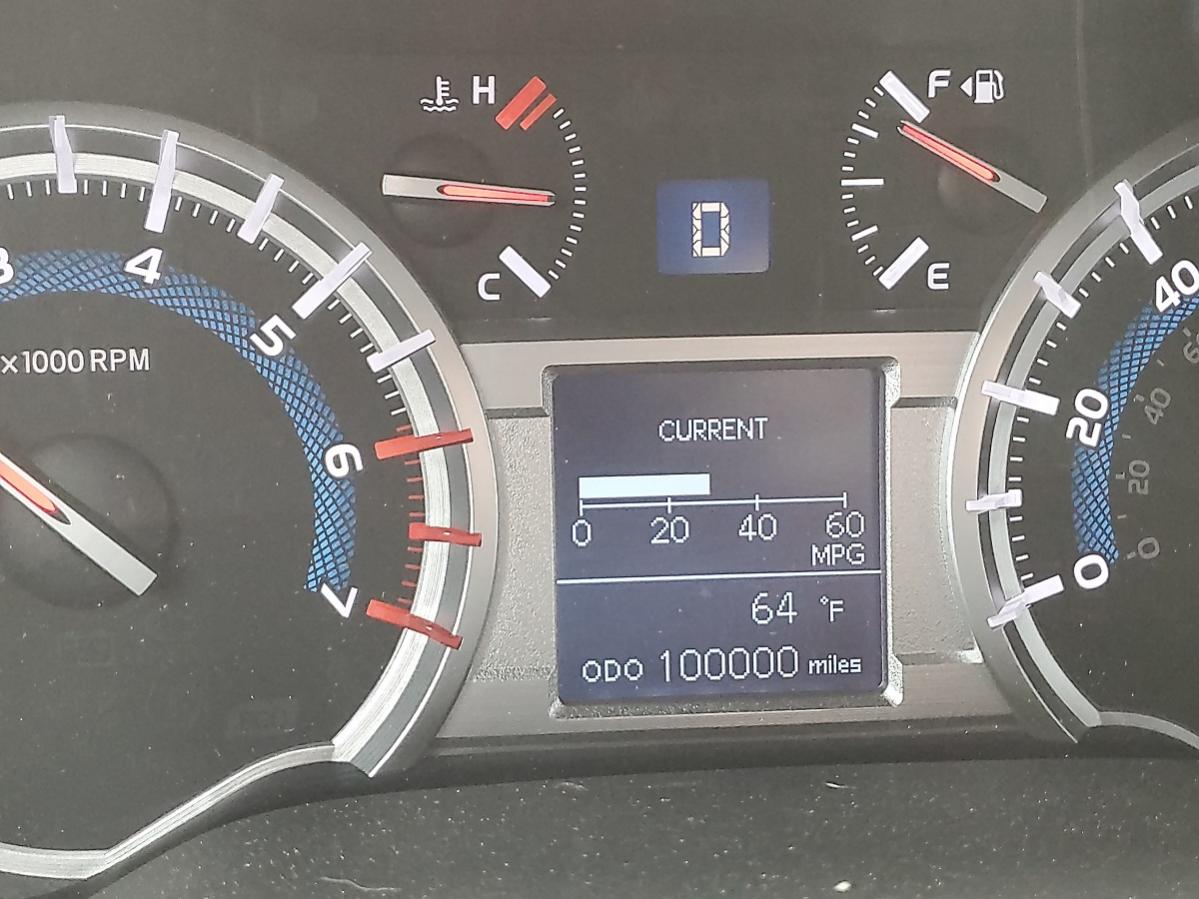

29Sep2020 100,000mi
I finally reached the end of the break-in period!
