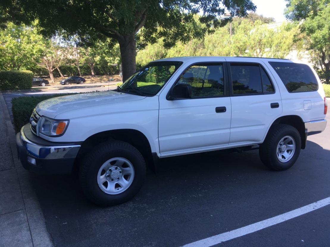

I know this is a super old thread but can anyone w a 3rd gen 4runner on 15” wheel post pics of their rig ? I’m trying to put 15” on mine but I’m worried it’ll look funny cuz that’s just such a small wheel. Trying to go 33x1250r15. Thanks !

Here's my bone stock 2000 base model 4Runner with 15" steel wheels. Tires are slightly larger than stock, 235/75-15 Michelin Defender LTXs.

I'm guessing yours came with 16''s? If so, you might have issues with a 15" clearing the front brakes.

I'll agree. First, you need to make sure the wheels fit the larger 16" wheel brakes... If they do, then you can fit any tire similar to 16" fitments. Whatever you do, don't downgrade to the 15" wheel brakes - especially with 33" tires!
